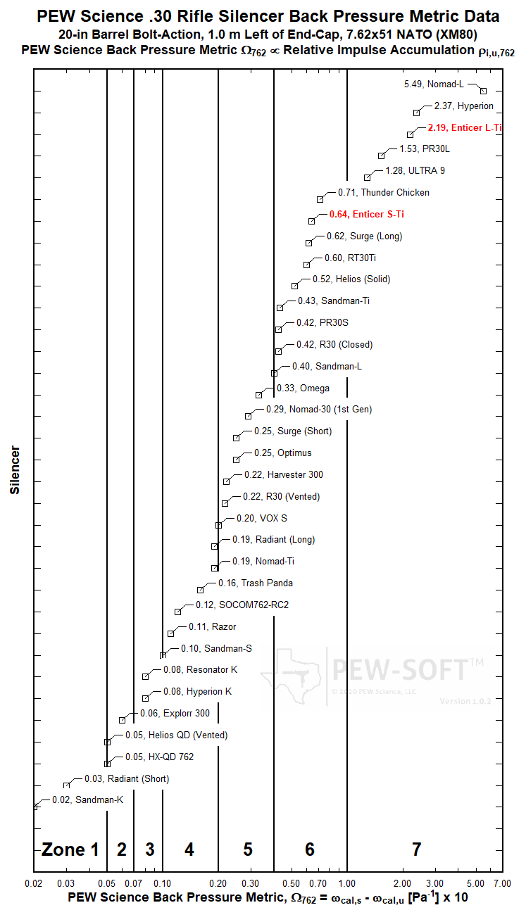

One thing the Sandman-S has going over the SOCOM is that PEW Science rated it like 3rd on the back pressure scale, so that's pretty damn good. And I've noticed the same with mine...Very low BP and low gas for a 6.8" long 1.5" OD can. Plus, the welded Stellite baffles and stainless tube give it a really nice deep tone. 👍🏼

High flow rate (AKA "low backpressure") will lead to increased muzzle flash if there is still substantial unburned powder in the muzzle gas jet - typical for SBRs, far less of a concern for normal rifle barrel lengths.

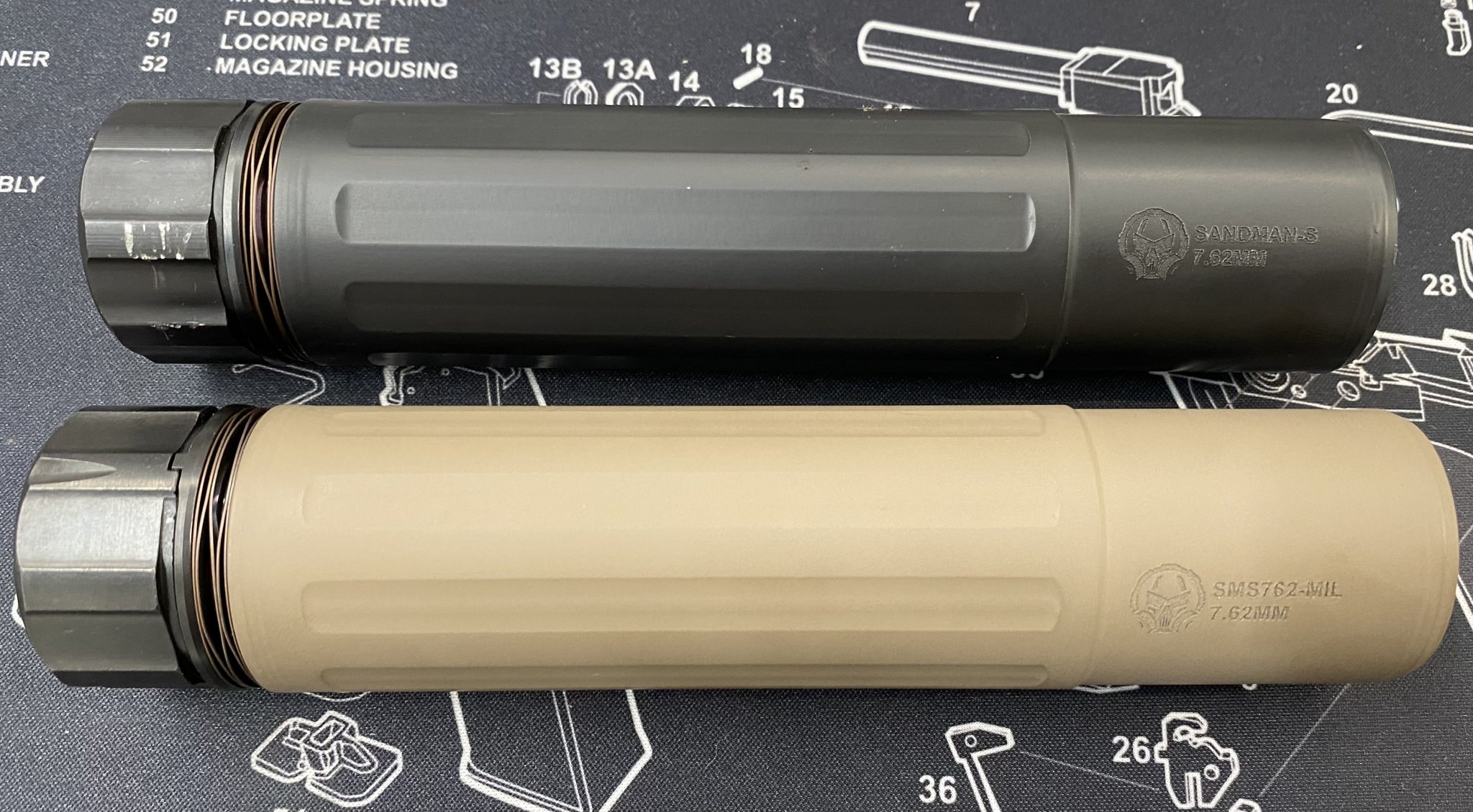

The Sandman-S won a DEVGRU (Seal Team 6) contract and is currently being used by them. And @SilencerShop is selling some of the contract overrun cans. They are FDE finish. I have one... It has a SMS-MIL-XXXX serial number, too. Pretty cool conversation piece. It's the same Sandman-S as the original, just FDE finish and has a MIL serial number.

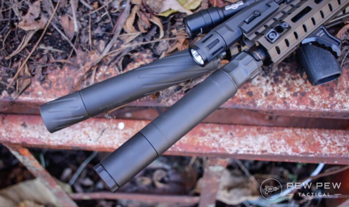

Well, here's a few articles through a quick google...
PewPew Tactical ranks the top 6 .30 caliber suppressors (2021) and the Sandman-S was ranked #1.
The Truth About Guns wrote this article in 2016... They ranked it 5 out of 5 stars in every category.
@SilencerShop Range Time Report for the Sandman-S with some numbers...
Sage Dynamics thinks pretty damn highly of it... 👍🏼

He doesn't personally rank suppressors like that. He will not give you a recommendation or tell you what to buy.
He gives you data and from that data you are free to make your own choices.
The backpressure metric being talked about us this. Keep in mind this is currently an experimental metric and back pressure doesn't automatically mean more blow back.
This is NOT a linear scale. The Nomad Ti does not have 2x the back pressure of the Sandman-S. That's not how it works. Just use the zones.
Keep in mind, that metric is for 308. It does not translate/extrapolate linearly to other calibers. Back pressure drops pretty significantly if your suppressor is over bored for caliber (using a 30 cal can on 556).
As far as sound rankings here is the current up to date list for 308 sorted by suppression at the shooters ear. You can sort it any way you want or choose any caliber currently tested. The 308 library is far more extensive than others.
