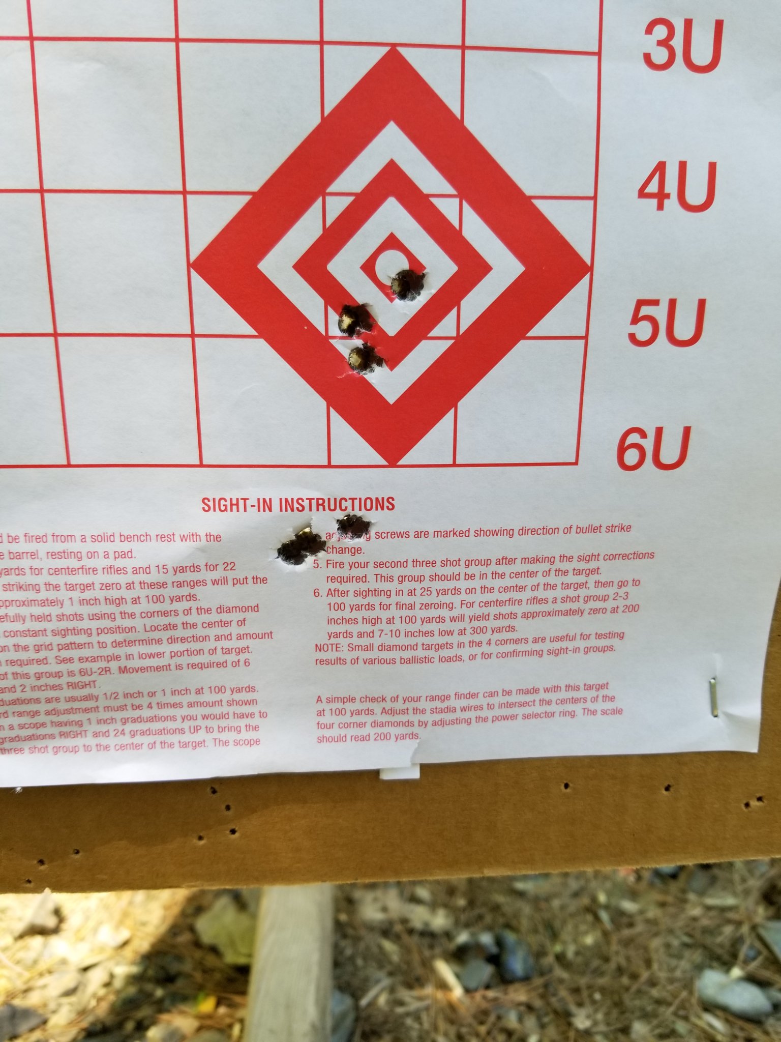

For what it's worth, I have a Sico Omega with the keymo adapter. I wanted to see how repeatable it was on my bolt gun. I started with the can on, fired a round, removed can, fired a round, put can back on etc. I fired 6 rounds and was happy with the results. It's very repeatable and predictable. Dont judge the groups too much, I was breaking shooting position between each shot.
