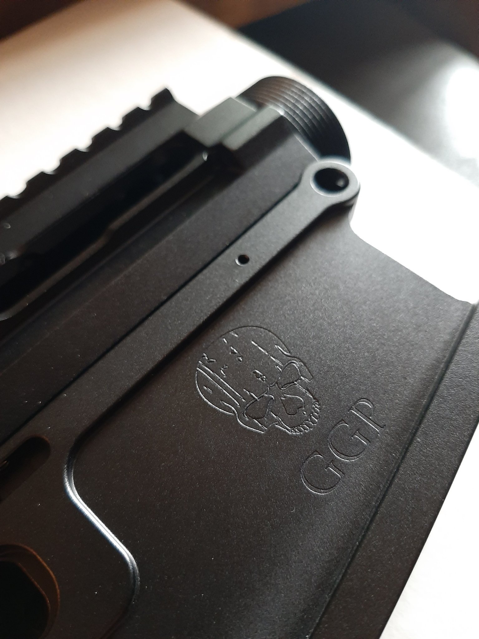

    Well this search ended quick. Got a tip Grey Ghost Precision had their billet sets on sale for 45% off and picked up a mkii set for $320. From what I gather this is quite a bit better than the Aero set I would have got... and no forward assist 😁.
    As far as the mk11 can and fitting. I have the print for the barrel profile, the receiver end where it plugs into the extension I can machine to make fit the barrel nut. The critical piece is only the last like 1/2" or so that mates into the suppressor. The problem is the back collar which I either hunt down on gunbroker and pay a stupid amount of money or machine a collar and have the indexing pin actually pin into the barrel. Haven't decided yet.... going to see how much more of a heavy bitch she is compared to the fa763ss which I have a spare muzzlebrake sitting around. I just tend to like more than 1 host for my suppressors and I'd hate to have a $1400 mk11 can dedicated to a mk13 which will see light use.

    I'm honestly impressed with it. Upper and lower are very tight, way better than the old aero m5 I had. Finally figured out the direction I'm going.
    Kreiger barrel
    Toolcraft HP dual ejector bcg
    Pri delta handguard and spr top rail
    Pri flip front sight gas block
    B5 precision stock
    Surefire fa762ss/AL brake
    Bcm gunfighter mode
    Geissele ssa-e
    likely a nx8 4-32 with T3
    She's gunna be a beast.

    Weighing myself 3 times and then one with the receiver I get 1.4lbs.
    Spec on website says 1.55lbs or 24.8oz. Their spec is probably right on or a smidge over for fully stripped.
    Reactions: JS8588 and rpoL98
    Sorry for the late reply. Thought I had a food scale but my wife decided the dumpster was a better place for it.
    How are you liking the GGP receiver? They look nice, but hoping to catch them on sale.
    It's OK I still exist lol.
    I still haven't finished the AR10 but so far every part I've attached to it has got well and lined up. Slr, jp, geissele, bcm, pri, etc.
    I did buy one of their ar15 receivers and that has run flawlessly so far. I like their stuff. No issues yet.
