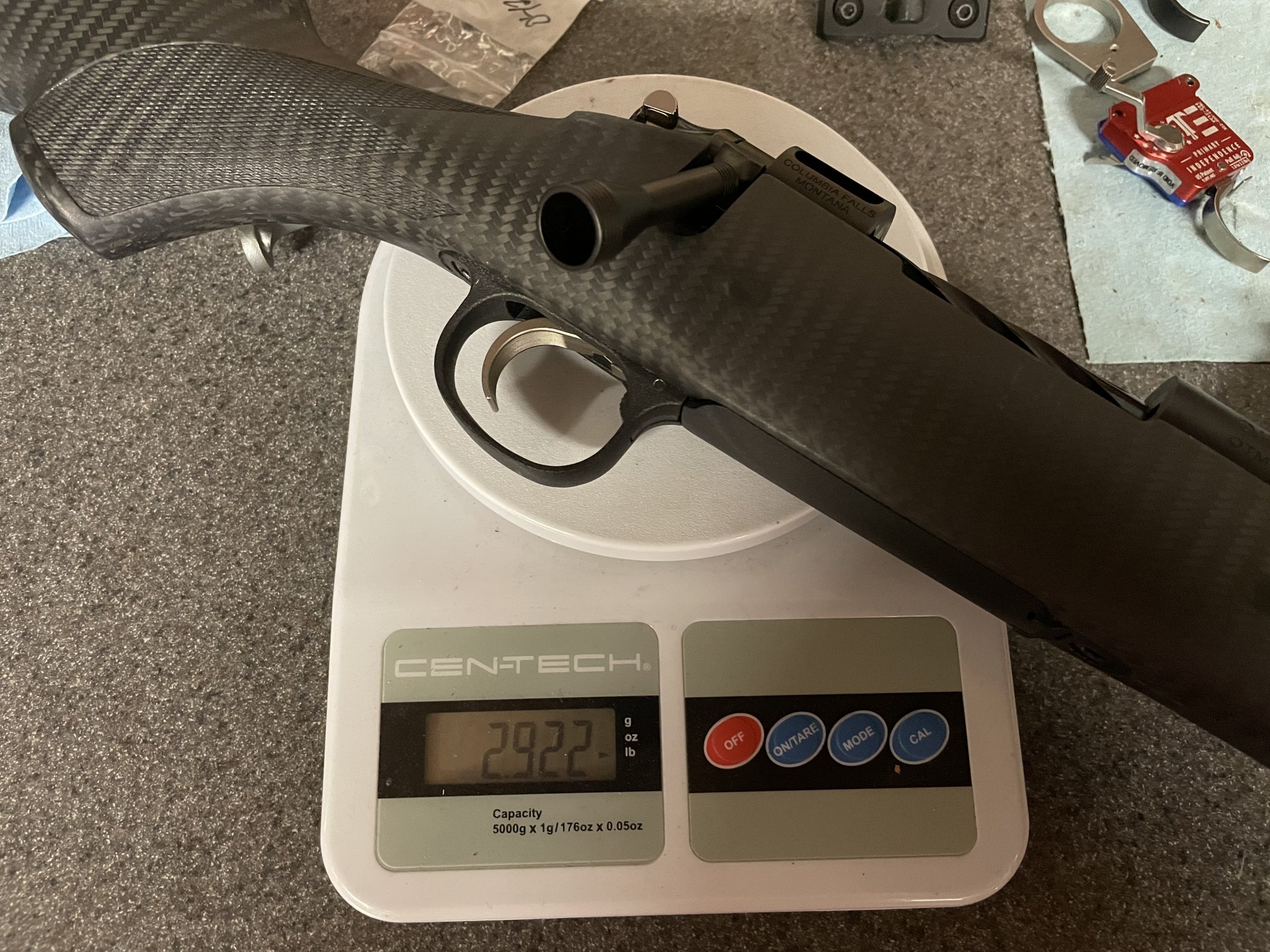

    The stock I'm likely going for is the lighest one I know of which is the Manners MCS-UC. I don't need LOP and cheek adjustment (or the added weight).

    What stock is that one?

    Another thought to add, I have seen some of the ultra light stocks fail under heavy recoil and I believe some even specify caliber limitations in the fine print.
    The one I mentioned apparently is good for magnums. It won't get used like my PRS rifle so... hopefully that doesn't happen! :)
