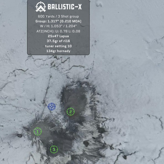

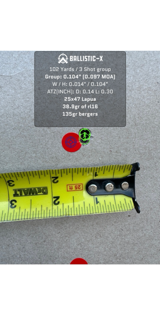

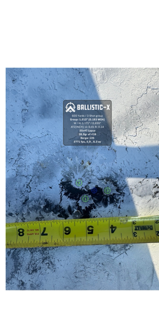

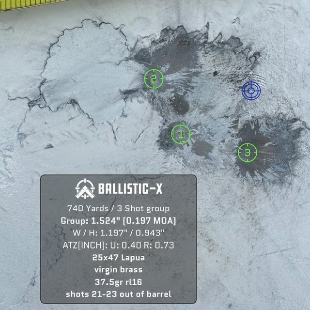

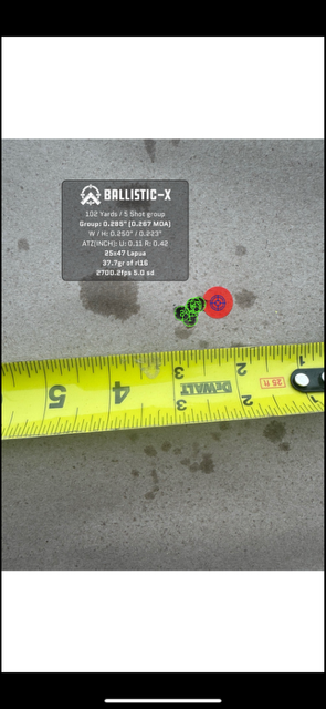

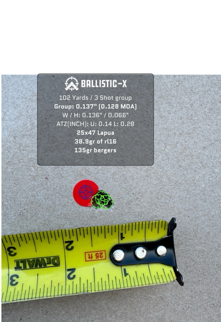

I mainly run a 6bra and a 25 creed the past 2 seasons. I switched just a few weeks back to a 25x47 Lapua and I’m shocked how similar the recoil is to the 6bra and so much less then the 25 creed. Very easy to spot your shots off a prop/positional compared to a 25 creed.
accuracy is amazing, and it shoots pretty much everything well! I run SAC sizer and Wilson inline seater
