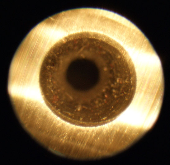

The four groove on the Bartlein allowed them to situate the gas port in a groove easier.
Krieger AR-15 barrels in 5.56/223 Remington are four-groove barrels and unlike Bartlein, Krieger Barrels Inc will chamber their own AR-15 barrels , install the barrel extension and put the gas port dead center in a groove.
