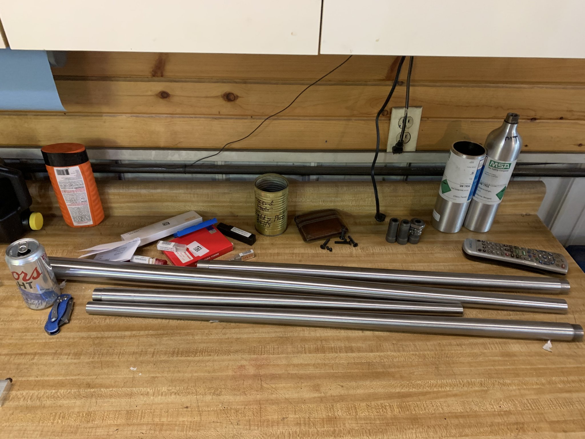

Like Geno said, think about dies while deciding on the reamer. Since I do my own work it’s easier for me to order a die reamer and make a die myself than wait around for someone else to make it and hope it’s correct. Die reamers aren’t that expensive and newlon makes die blanks for the small stuff. For the big stuff I have my barrel guy drill a hole in some barrel stock, having a pre drilled hole makes life real easy.
