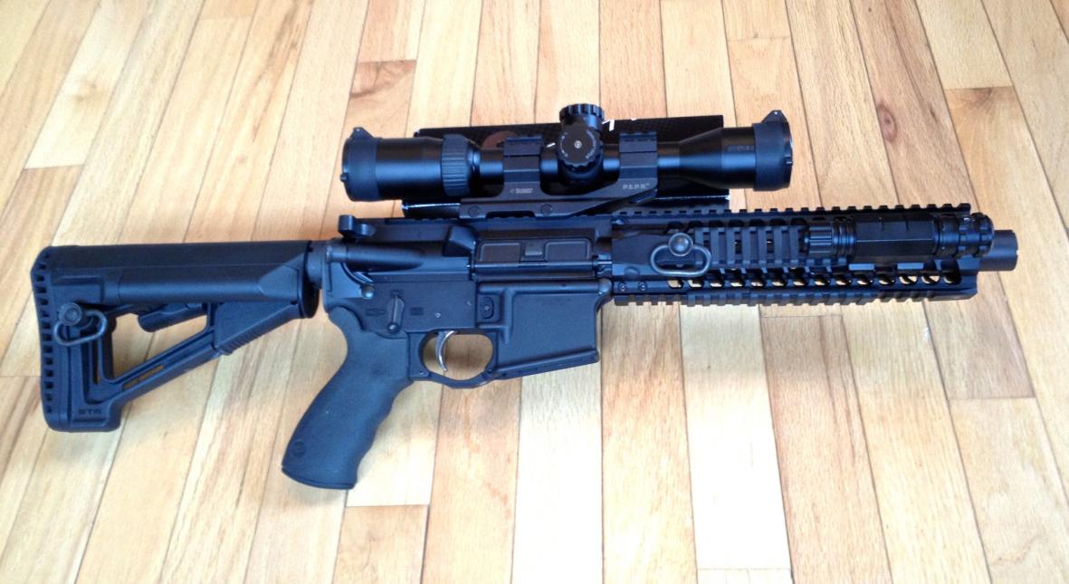

Try CMMG for a Stainless Bolt Group, I bought the combination with their 6.5" barrel and am very happy with it. I wouldn't put too much worry into having to have a 4.5" because you can buy (whenever it becomes available again) lots of different bulk 22LR ammo for it in SubSonic, like CCI Standard Velocity #50035 1070fps, Wolf Match 1050fps, Eley Sport Standard 1085fps, CCI Gemtech Sub 1080fps, Aquila Eley Prime 1055fps, Win 42 Max Sub 1065fps, Rem SubSonic 1050fps, Rem SubSonic 38g 1050fps, Rem 22 Thunderbolt 22LR SubSonic 1050fps, Win SuperX 22LR SubSonic 1065fps AND you can get SuperSonic when you want. It's nice to have the choice. Here is my Spikes/CMMG/Silencerco Build
Link for Barrel and Bolt: Barrel and Bolt Group Kit, 22 LR, 6.5" CM, MC, SS Bolt Group

If you can find a used Spike's Tactical, I highly recommend them. Far as I know, Spikes doesn't make them any more, I beleive due to some patent infringement or something. But mine absolutely rocks.
