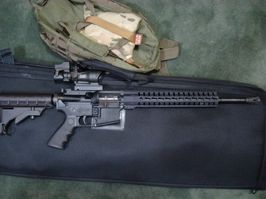

I had a CMMG Mk4 upper for a while.
https://www.cmmginc.com/shop/upper-group-mk4-t-22lr/
It was very accurate, however it jammed constantly! I tried everything to get it to work with no luck...5 different kinds of ammo and it hated them all. Three different magazines, no difference.
I contacted CMMG and they sent me link to a video on YouTube saying I needed to "buzz the chamber" which meant I needed to polish the chamber. I tried it, it helped a little bit, but still jammed all the time. After a round went off with the bolt partially open I got rid of it.
It seemed to be a quality upper, but it wouldn't function and CMMG customer service was a joke to say the least!!
