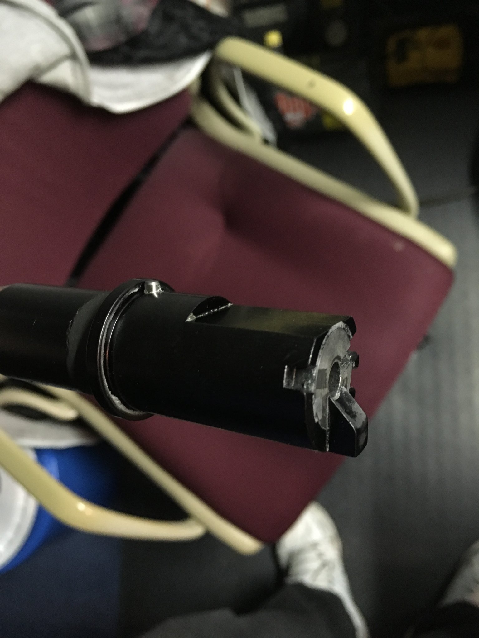

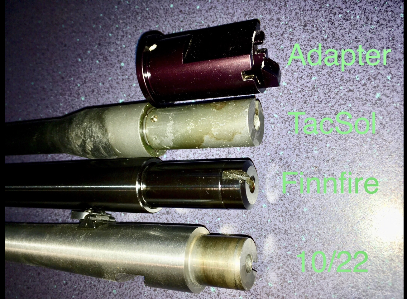

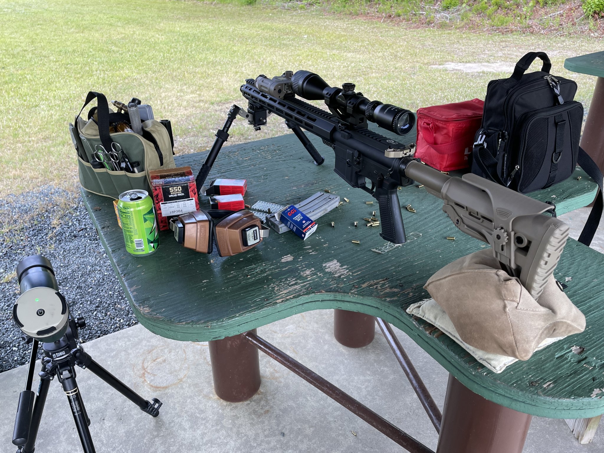

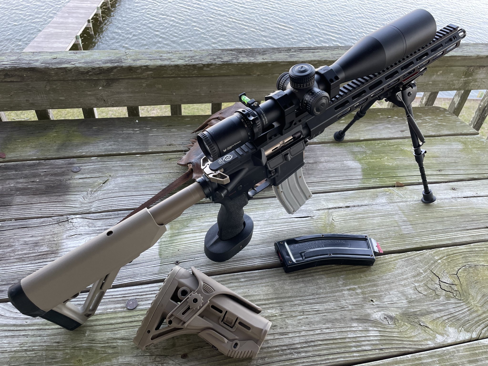

I’d love to see a pic of your build, the magazine, and what the chamber area looks like with bolt locked back. I’m assuming from the sheer number of rounds fired, you are seeing no peening of the breechface? Can’t wait to hear/see the accuracy results.
I’ve kinda had a long term project AR conversion, and was just given a barrel which may give the accuracy I crave. Discussing this with my AR guru, he explained as long as I’m shooting the military trigger and loose collapsing buttstock, I’ll never see what the gun is really capable of.
While pondering the next steps, I discovered something that, if it works, will give me an excellent test bed for the barrel at least. It turns out the Tac-Sol upper/barrel has nearly identical tenon dimensions to a Sako P94S Finnfire, as in I’ll slap the Tac-Sol barrel into a bolt action with 2oz trigger and benchrest stock and really see what it’s capable of 👍

Uploading pics and some video's for you right now. I forgot to mention I'll be using a KP15 lower and LaRue MBT-2S Trigger Straight Bow trigger with the lighter spring.

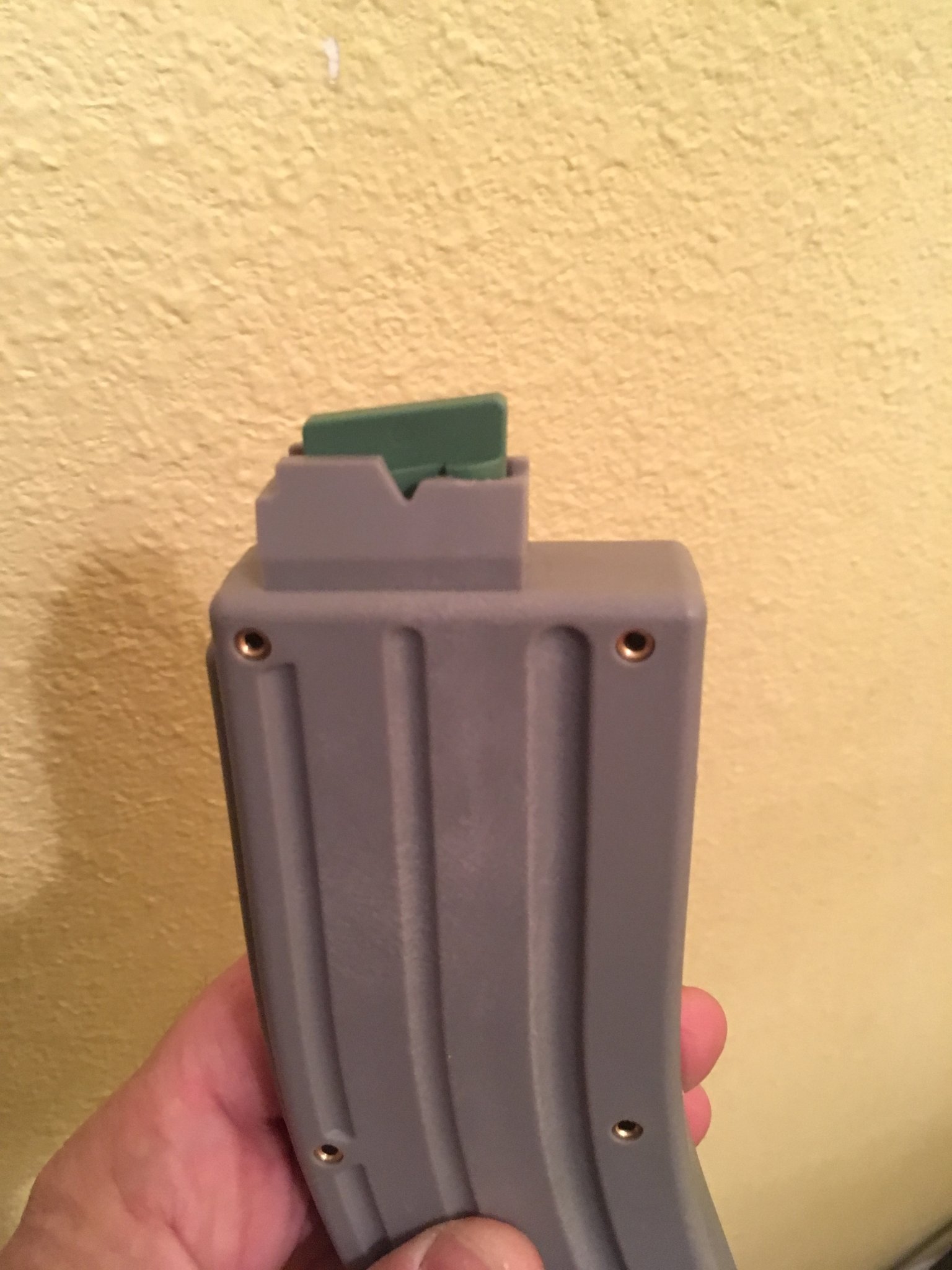

Top rifle is what I've been using to test everything with so far. The magwell is a bit small so the adapter is a nice snug fit. The lower on the bottom is what I will the next upper on. Idea with the first is it's more of a plinking / trainer since it's in the middle length and weight wise compared to my other ARs while the 2nd is going to be dedicated more towards ELR, and distanced stuff.
Edit: Magazines with a black dot mean they gave me some type of issue relating to feeding into the rifle. Red marks are magazines showing signs of feed lip issues. 3 lines mean it'll always cause an issue, a single line across each half is actually me being lazy with two lines meaning it's close, and a single line (not sure if it was shown) means it's beginning to exhibit signs of wear. I base this off of how much the round points upward or can be wiggled vertically when loaded into the magazine. If it wiggles a little then it's a single or double line, if it completely points upward then it's a three line and needs repair.
Someone commented on a youtube video of M&P15-22 magazines wearing out said they took a heat gun to theirs and squished the feed lips together.

Excellent! Yours appears to be a much different system, looking forward to seeing your accuracy results with the new build.

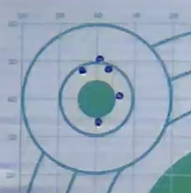

Here’s pics of mine currently. Goal is for it to be a match accurate barricade rimfire rifle from 25-400+yds
I’ve fired one match just to establish a baseline, but as I’ve said, accuracy is 🫤
Best group fired thus far at 100yds was 1.6” with CCI SV.
Out of over 1000 rounds of various types fired, zero malfunctions.

The RSOs and range owner okayed me taking multiple days if needed to do my tests so long as I don't spill CLP everywhere and not pick up after myself.
View attachment 8166811This was the set-up for testing at 100yds, I was able to replace the $30. airgun scope a short time later. I still need to source 10-15 round magazines or cut down a 25 rounder to make it more barricade friendly.View attachment 8166812
Good group! I'm excited to see how well my bbl does at 50 and 100 yards over the next few weeks. One reason I opted for M&P15-22 magazines as well was I could get 10 rounders a lot easier. I'm tempted to cut down the first really broken one to 10 or 15 down the road too. Would look pretty nifty!

However, I can't help but notice a tiny degree of cant in the bbl towards the right side. I know how to lappe an upper, but lack the tool to do so. My other M4E1 doesn't seem to have this. I'll keep watch of anything abnormal as I put rounds through it. Biggest concern would be the ammo, bolt and/or barrel experiencing issues since it's not lining up perfectly. I know there was someone else besides X-Caliber who made one, but that was a few years ago. I'm a SOTAR alumni so I may see if anyone is willing to lend me theirs. That or putting the Beyer Barrel onto the other upper 🤷‍♂️
That's a little concerning. Especially if you can see it. Just spit-balling here....might be something to check to make sure the whole barrel is straight and aligns with the barrel extension. I can't see the upper receiver being off to the extent you can see a crooked barrel? I figured the lapping would just make a flat surface so as to eliminate any rocking with the barrel inserted. But to correct a misalignment issue like that might actually take some machining. The lapping tool extends far into the upper receiver with the idea it is creating a flat surface perpendicular to the receiver. Maybe it could remove enough material to square it up; not sure as I haven't had to do that. Fortunately, the bullet is going where the barrel is pointed so a misalignment between the barrel and upper receiver can be accounted for during the sight in process. The bolt rides on rails so it's not depending on the upper receiver to align with the barrel breech. I guess what I'm saying is that is probably something I'd want to fix but in the end, it may not affect funtion or accuracy of your dedicated upper.
I'll take a look today. Generally speaking Aero uppers can be a bit off to one side. When I was taking an AR15 Gunsmith class from School of the American Rifle, I brought a slick side Aero upper and from memory the face was off by about.... 0.03" so we ended up lapping it to get it nice and straight. Not enough to effect headspace, but we had some shims if push came to shove. As far as lapping goes Chad's 2 cents were you can do it on uppers that don't require a thermal fit because you don't risk dimensions being so tight you take off material inside the upper.
Lapping in general from my own training is to make sure the barrel is aligned with the upper based on the two mating surfaces. Barrel rocking is more of an issue with the empty space the barrel extension fits into. Since most OEMs don't let their uppers sit for the 2 - 4 ish weeks for the aluminum grain to settle after being forged, what happens is that the front of the upper almost has a slight cone shape. So you'd use some type of compound not only to avoid galvanic corrosion, but also to fill empty space. Naturally Loctite Green is ideal, but Aeroshell can be used. There just needs to be something to fill that space really. One reason I'd fix this is mostly just me being a bit ocd / perfectionist about these things. I'd polish up the feed ramp if it wasn't cnc'd and polished. I'm just waiting on a bipod to come in and i'll post an update photo.
Ended up taking out my current MBT-2S since it's broken in. One thing I do need to fix and only found out today while playing around with my lower is that the Redi-Mag converter works best if you fit it into an undersized magwell. When I mean undersized I mean where it only plays nicely with STANNAG and the adapter requires 2 hands and a good amount to a lot of force to get it in. What's happening is that the adapter is snug, but it's easy to move it slightly out of place causing my bolt release to not function and dropping / inserting mags to be sticky until it's pushed back up by a mag insertion. I reckon some thicker tape or something to bond it slightly to the lower would do the trick or just maybe some JB weld to create a ledge that'd stick and I could remove later. Easy fix. Otherwise it sounds and feels great!
Reactions: erik72
Pardon the notification spam people. I took a second look at my other upper and didn't notice the SLIGHT angle it is towards the right. Didn't notice before since the bbl is so thin but under proper light I'd guestimate it'd be a bit less than the one I just built. Contacted some alumni to see if anyone has one they could lend be, but if nothing by... Sunday I'll buy an X-Caliber and true up the uppers because it's definitely peeving me now ha ha. Love Aero for their affordability, but this is definitely annoying as nearly all Aero uppers I've purchased had slight or fairly significant offset. Easy fix thankfully enough.
