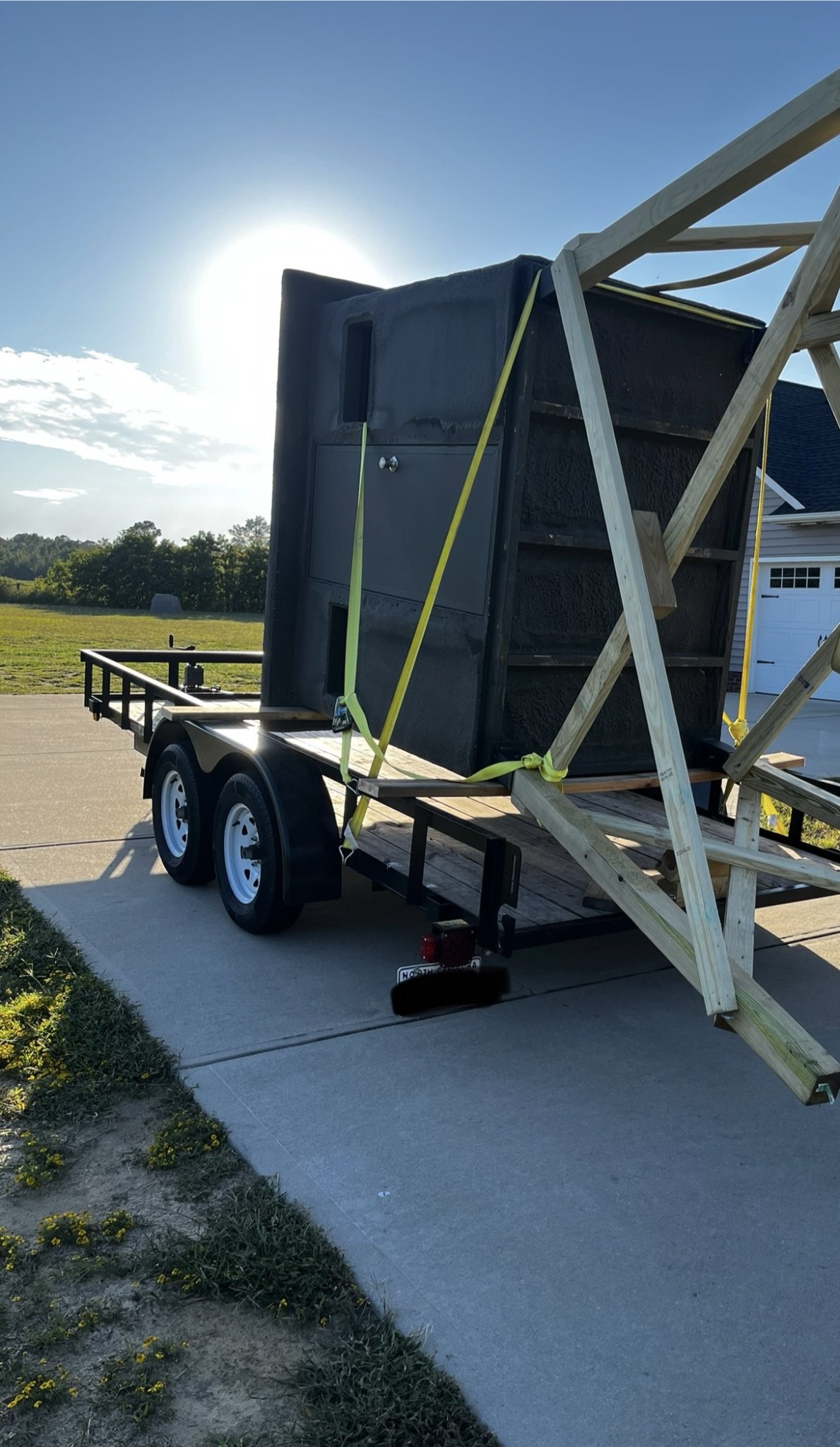

Not mine, just helped a buddy move it and stand it up a while back. I also brushhog his “lanes”.

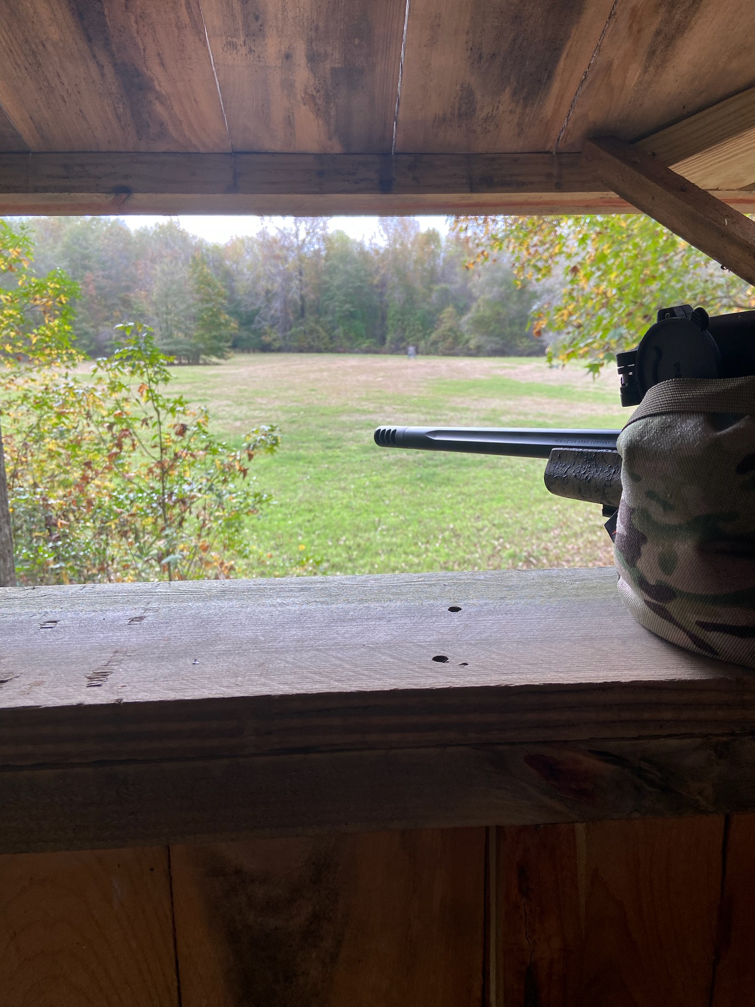

Here is my 8x8. 4x4 walls, simple windows, tin roof, carpet floor. I love it for multiple reasons; can see out to about 700, gets me high enough to see over multiple fence rows due to the lay of the land, and best of all I can have my young kids hunting with me and not worry about them moving around a little. Luckily I had access to equipment to level the pad and raise the entire structure onto it.

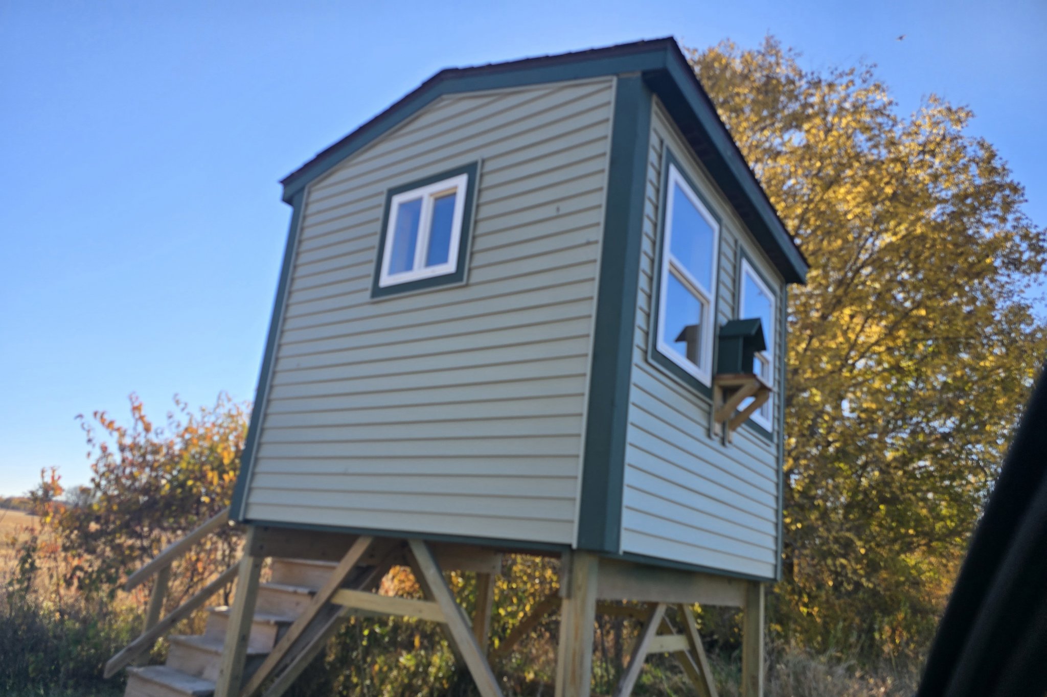

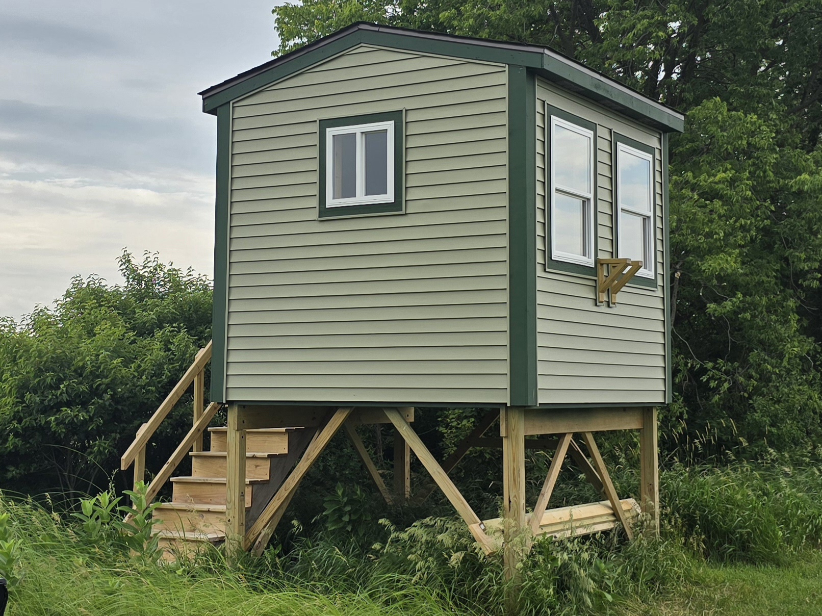

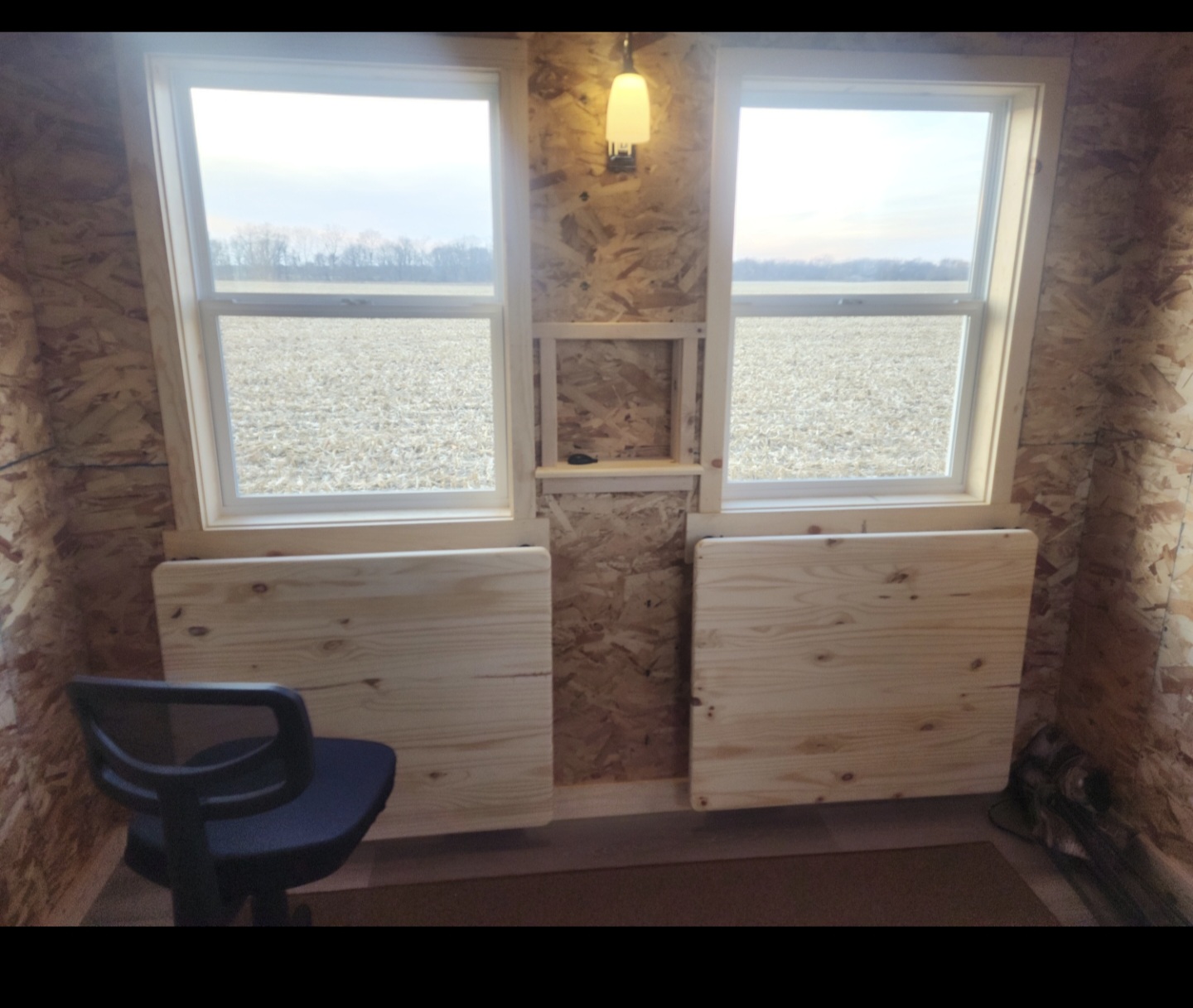

Built lots of them
Use elavator brackets for a 4x4 post. 8-10 high is perfect.
For one guy 4x6 for two 5x8 are the perfect size.
Build front wall 7' and back wall 6' giving you a 1/12 pitch.
Use premade window
They also make some nice doors.
Use horse trailer rubber mat for the floor and cheap indoor outdoor black carpet on the interior walls for noise dampening.
FYI, 4' outside dimensions with 2x4 walls is just a little small inside for drawing a bow. Its convenient for material usage but doesnt work for a 28" draw length. All the boxes on the AL lease are build this way and I can only use a bow at funky angles with very few shootable lanes. I dont hunt the boxes much but found this out when I headed for one on a day when a deluge came in fast.
