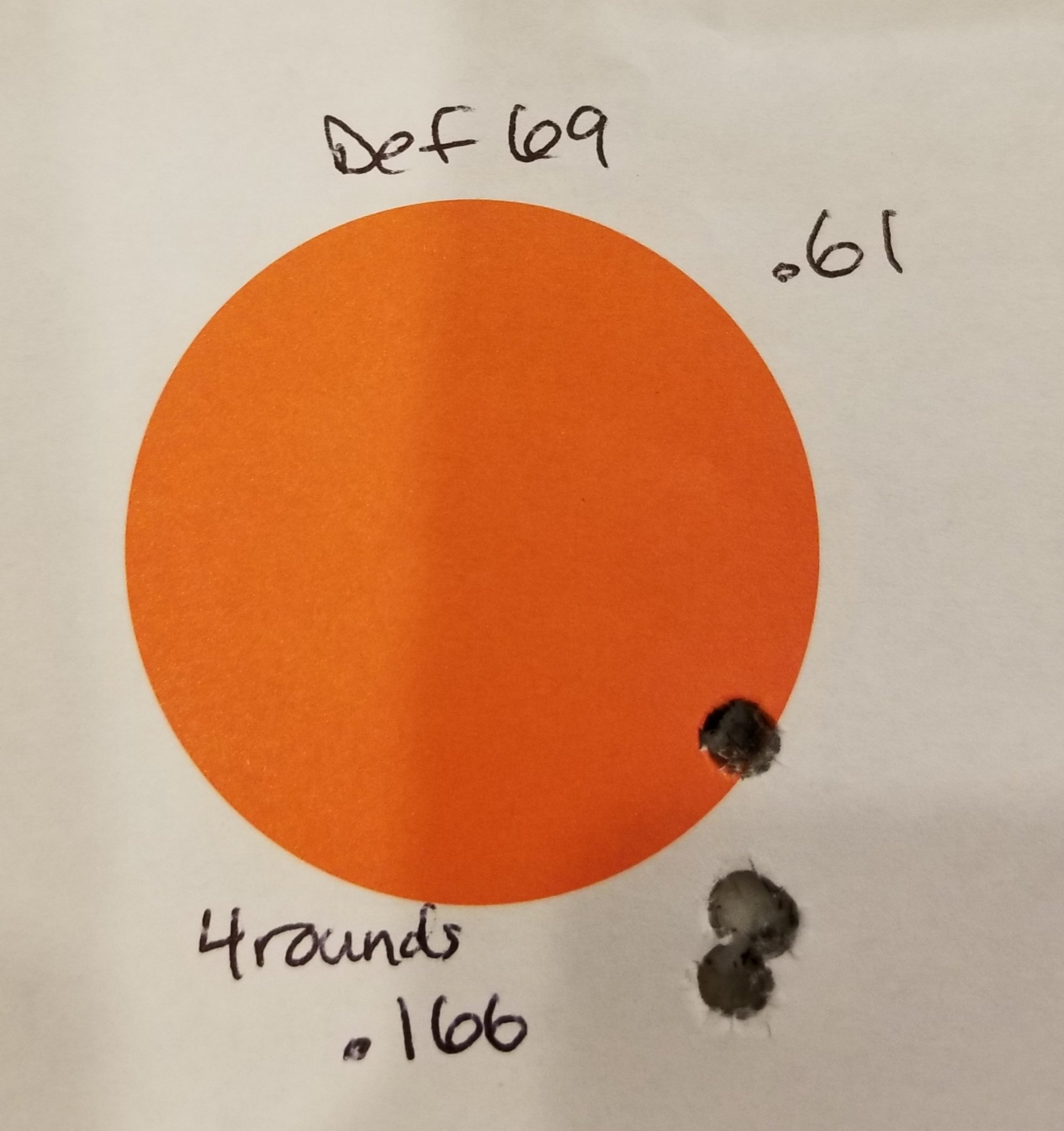

Defender 69gr SMK from my JP .223 20' yesterday.
I blew a great group with the 5th round at 100 yards. Knew it when I pulled the trigger. The 300 yard group was in heavy mirage. I get velocity of 2810 fps ES in the 30's.
