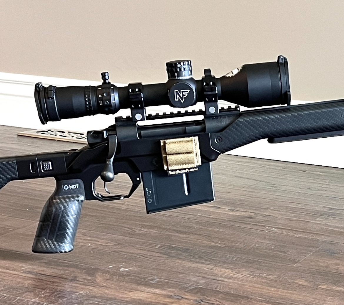

So I won a 300 PRC through Griffin and Howe. It's built off one of the older CRF style Rebel Hunter actions. This action doesn't have the headspace guarantee from Defiance and doesn't list it as prefit compatible (directly from Defiances CS). What have some of you done in this situation? Do you just do a remage and set headspace with gauges? Or have you ordered prefits and had them work fine? I have an Origin that I have done both savage style barrel nuts and prefits on. Both have worked fine for me. Any help would be appreciated as this action is new to me. Thank you
Pic for Reference
Hello all,
Pic for Reference
