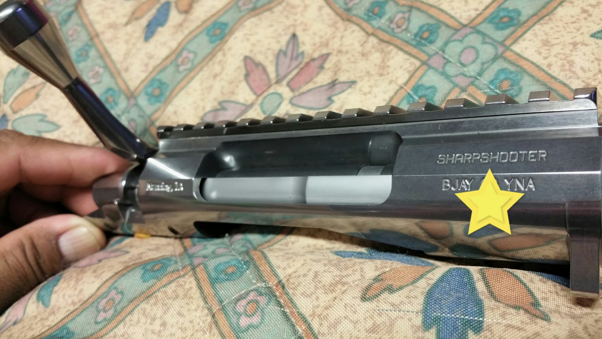

Im using defiance deviant control round feed i think its better comparison for tl3 push feed..i like them both if you're NOT planing to do switch barrel for one action deviant is great.switching barrel with TL3 definitely cheaper and easier just swap bolt face even to magnum..heres my deviant control feed
