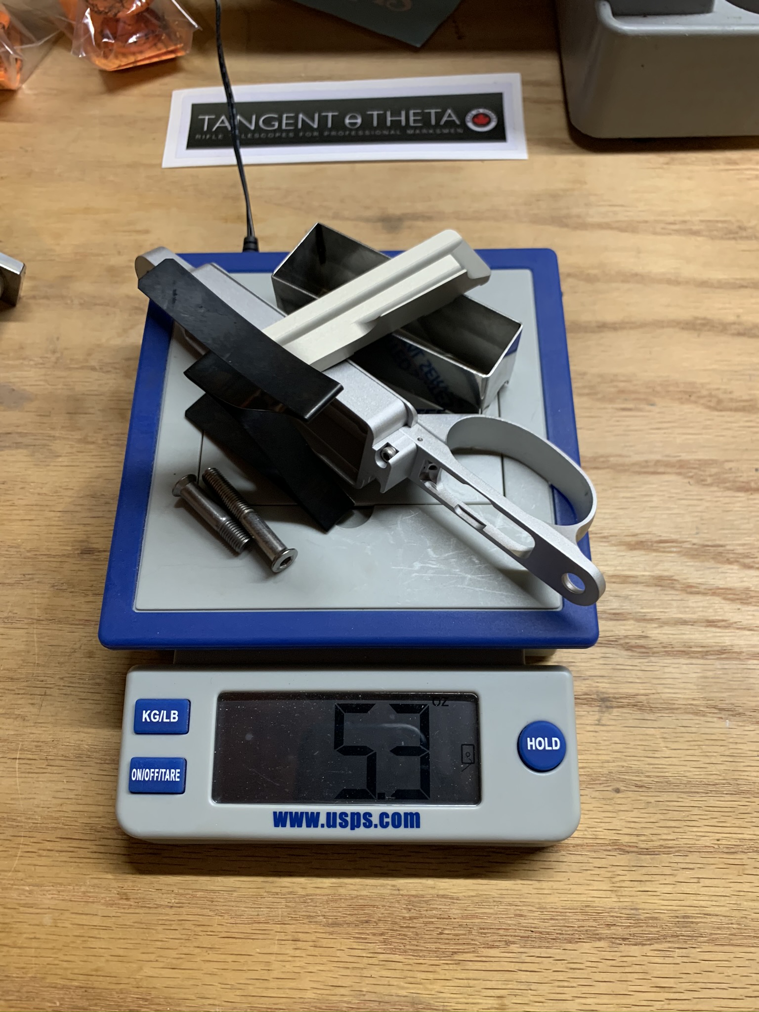

I plan on using Hawkins BDL hinged floor plate and Trigger Tech Diamond Trigger, I’m leaning towards a long action just in case I add another long action caliber. The XM limits the stock choices and I want to go with a carbon fiber stock, Manners lightest stock available. By the time I add a can on the end and put either a NF 5-25x56 or Khales 624i the weight will add up.
For my 6.5 PRC I went with a Defiance XM, Hawkins BDL, and a Wyatt's box, follower, and spring. Everything turned out great.

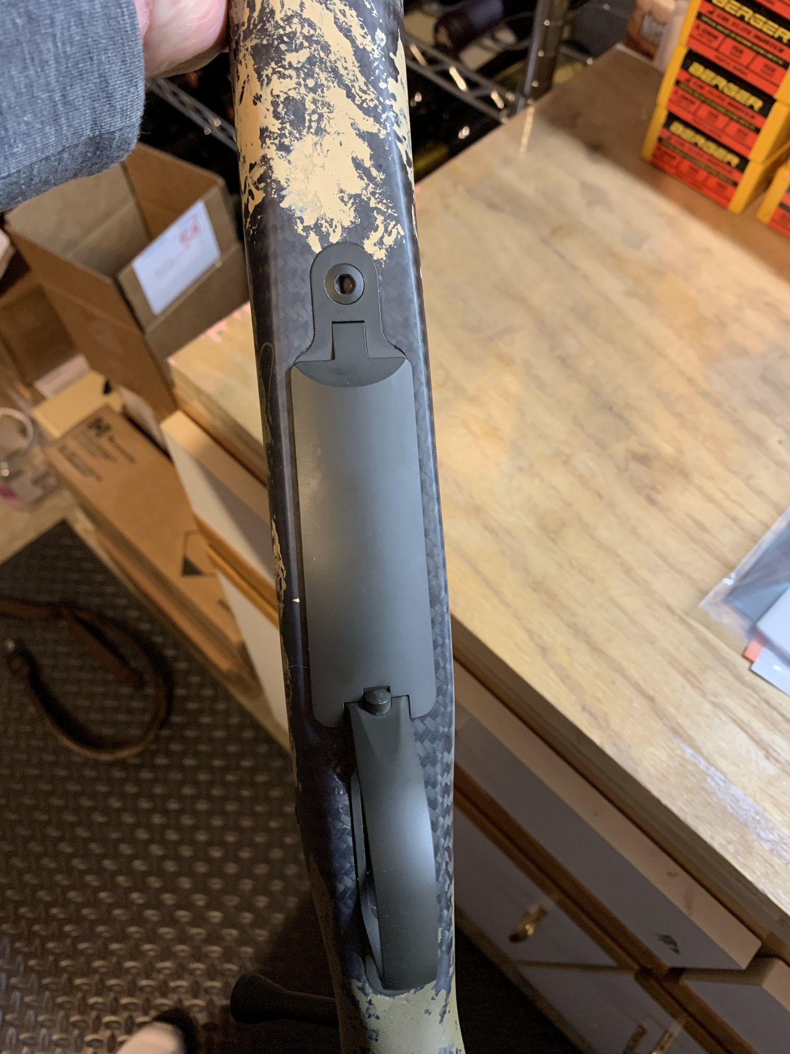

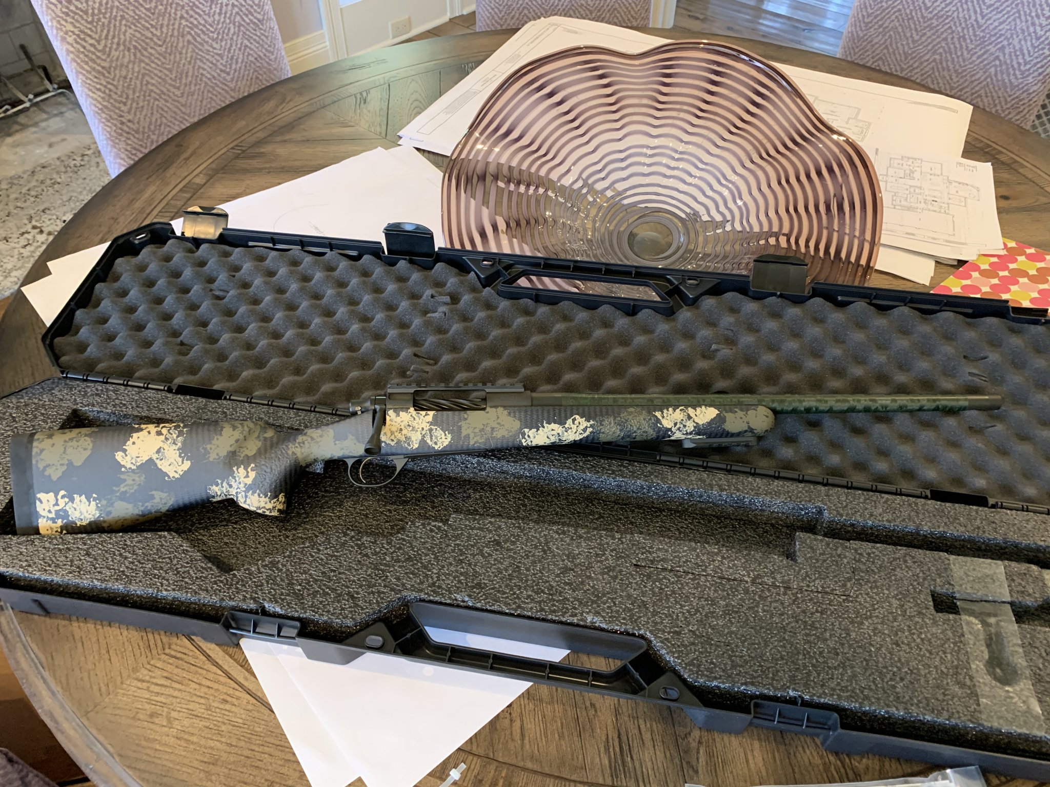

I had same thought so I’ve got a Manners UC plus stock on order right now for my rifle pictured above. I ordered in January so it should t be much longer.
