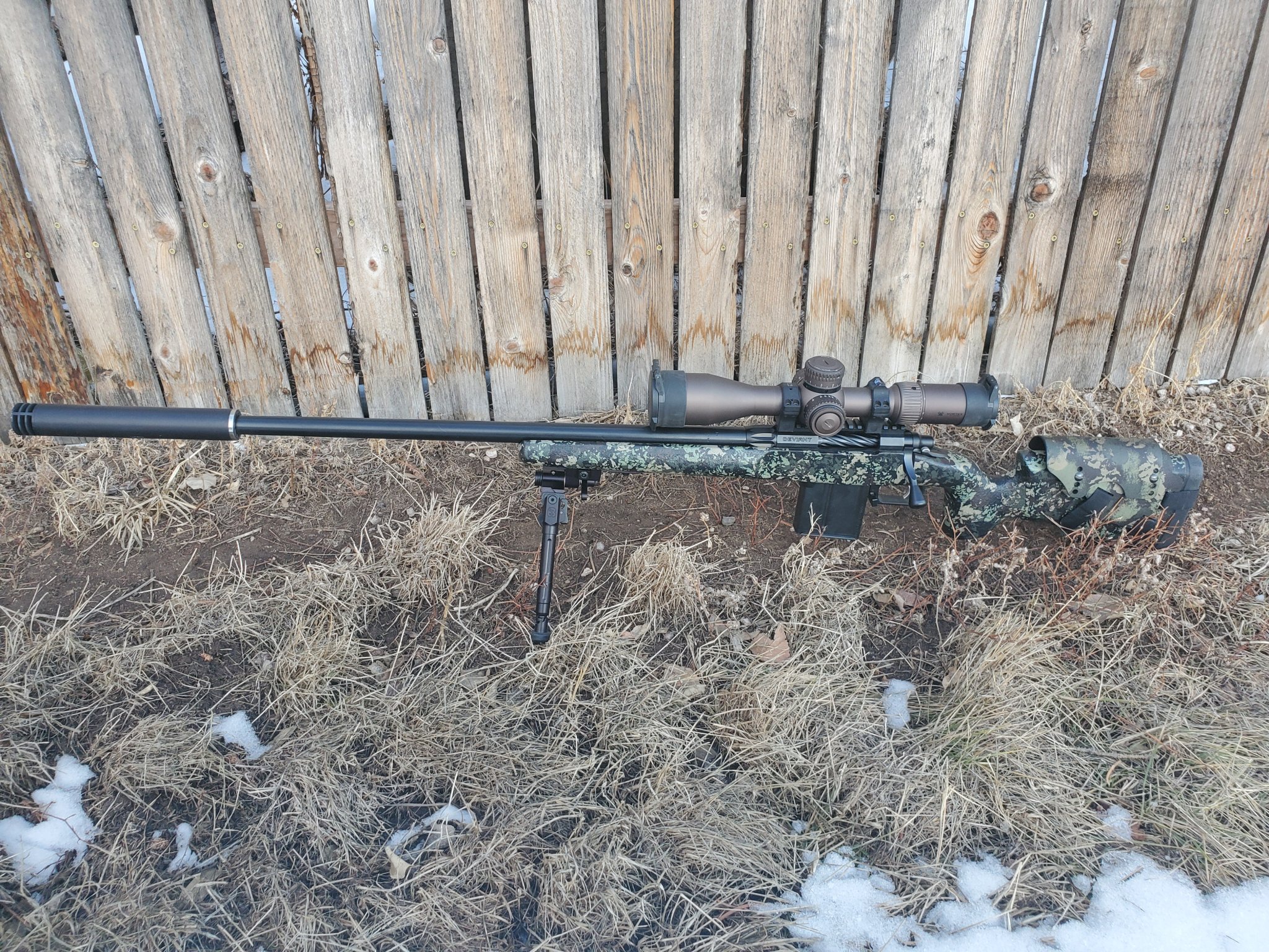

I have one in LH, heavy tang, fluted bolt, nitrided, 20 moa rail, tear drop bolt knob, remington style handle.

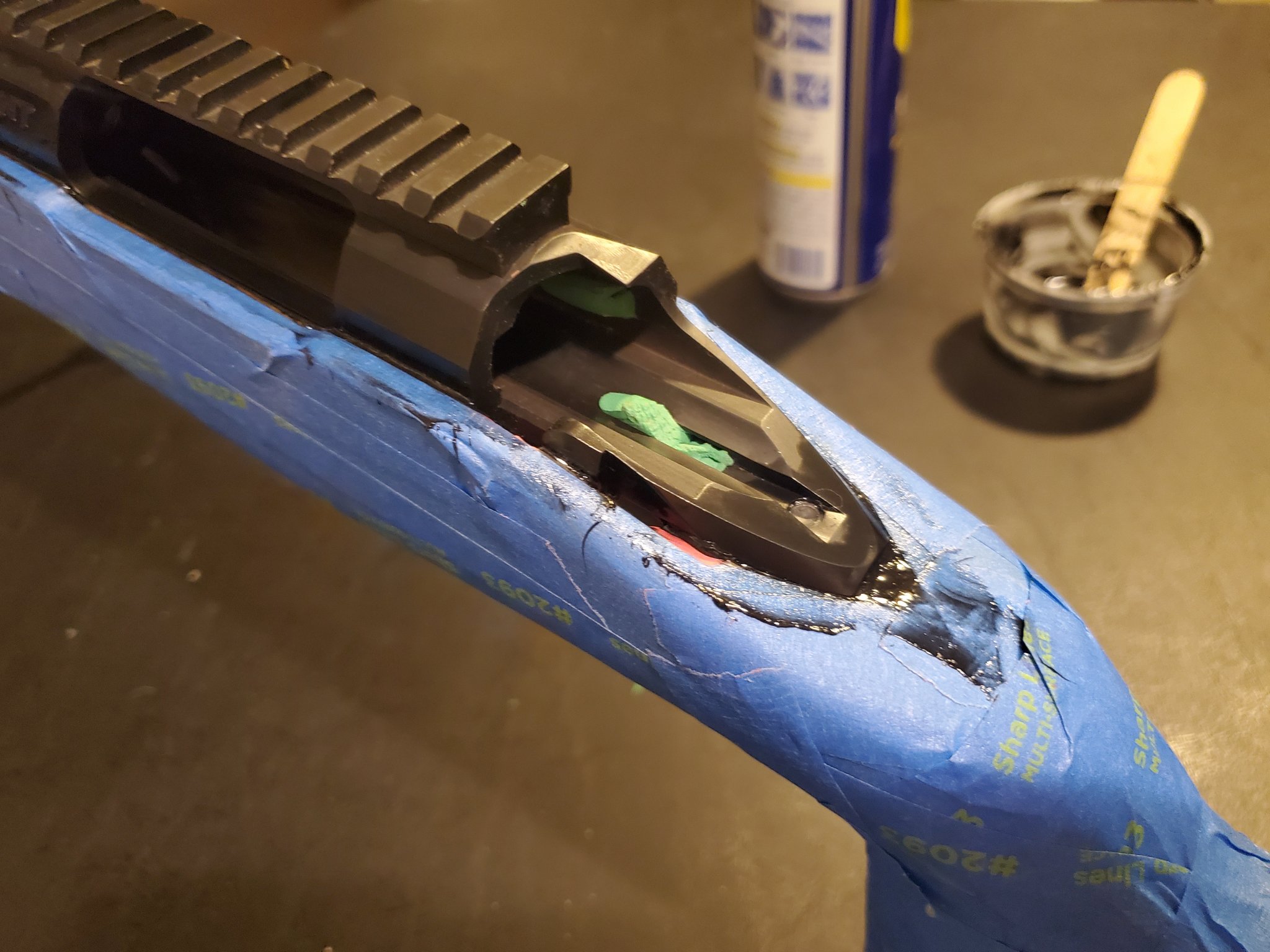

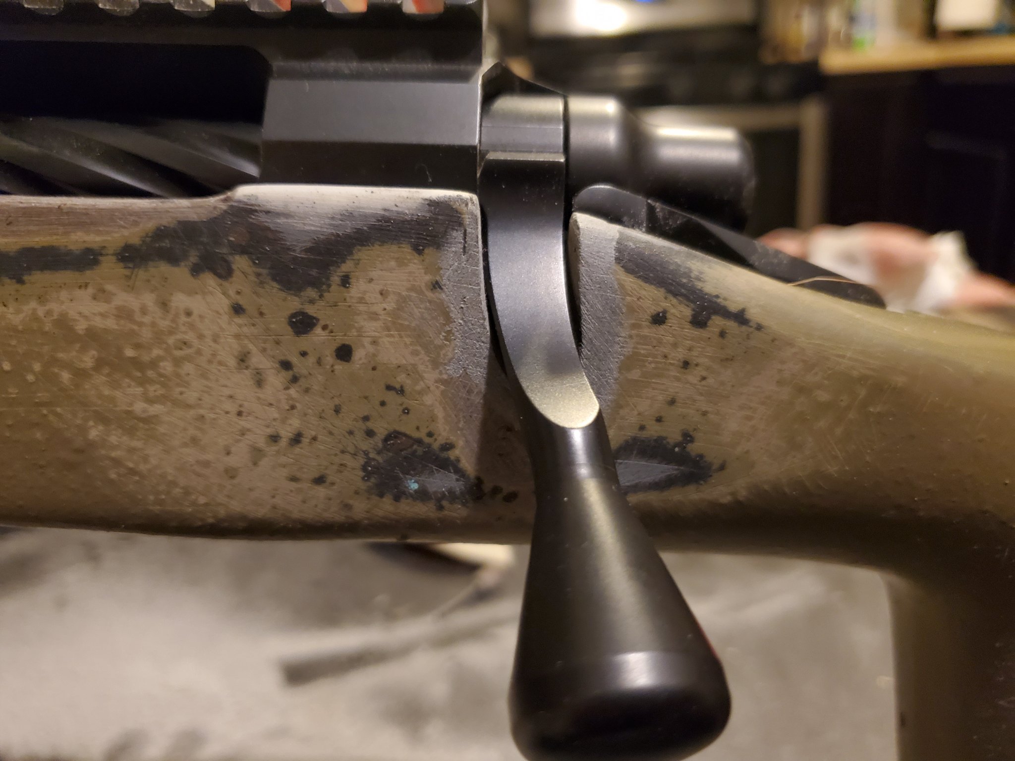

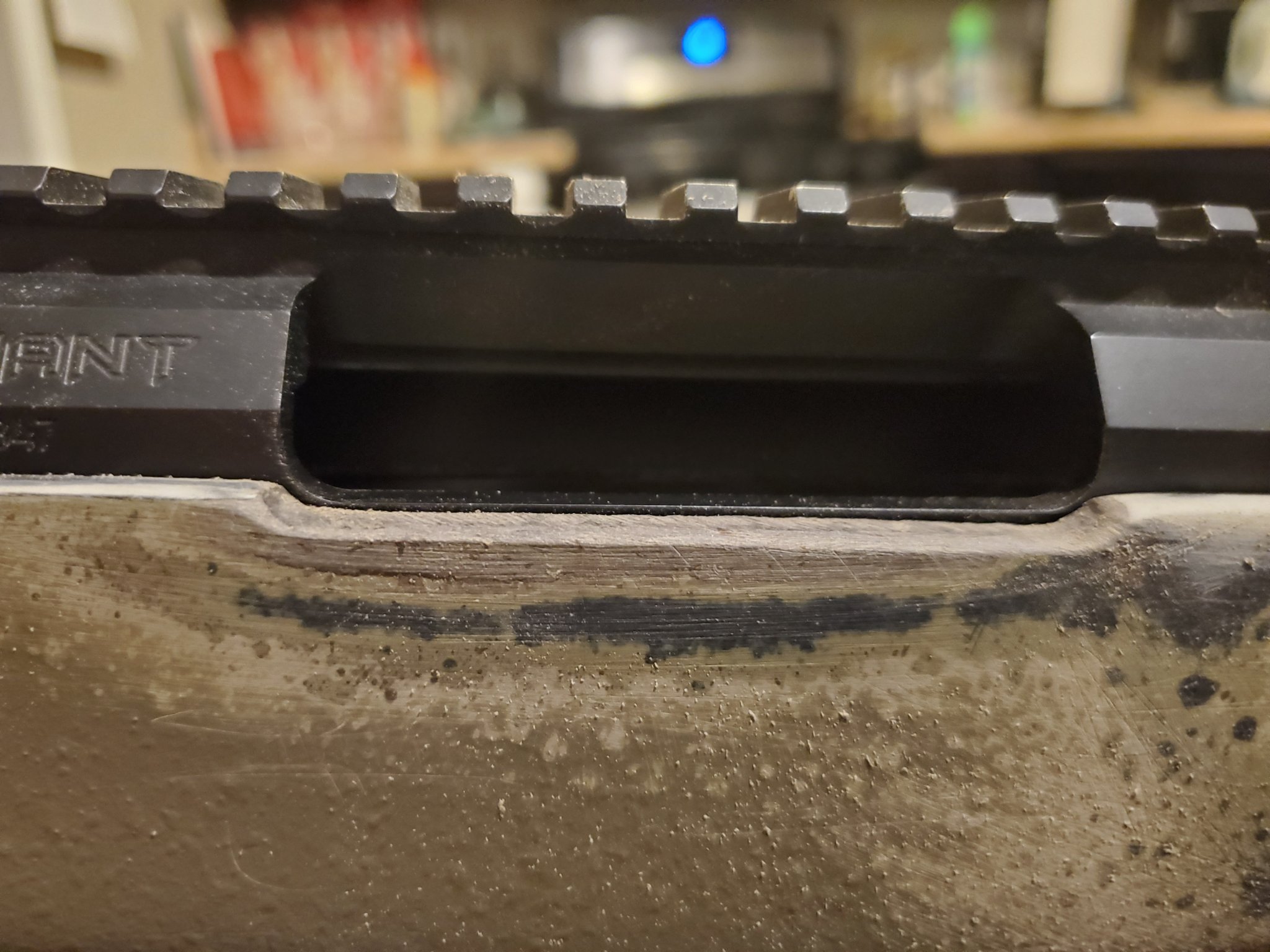

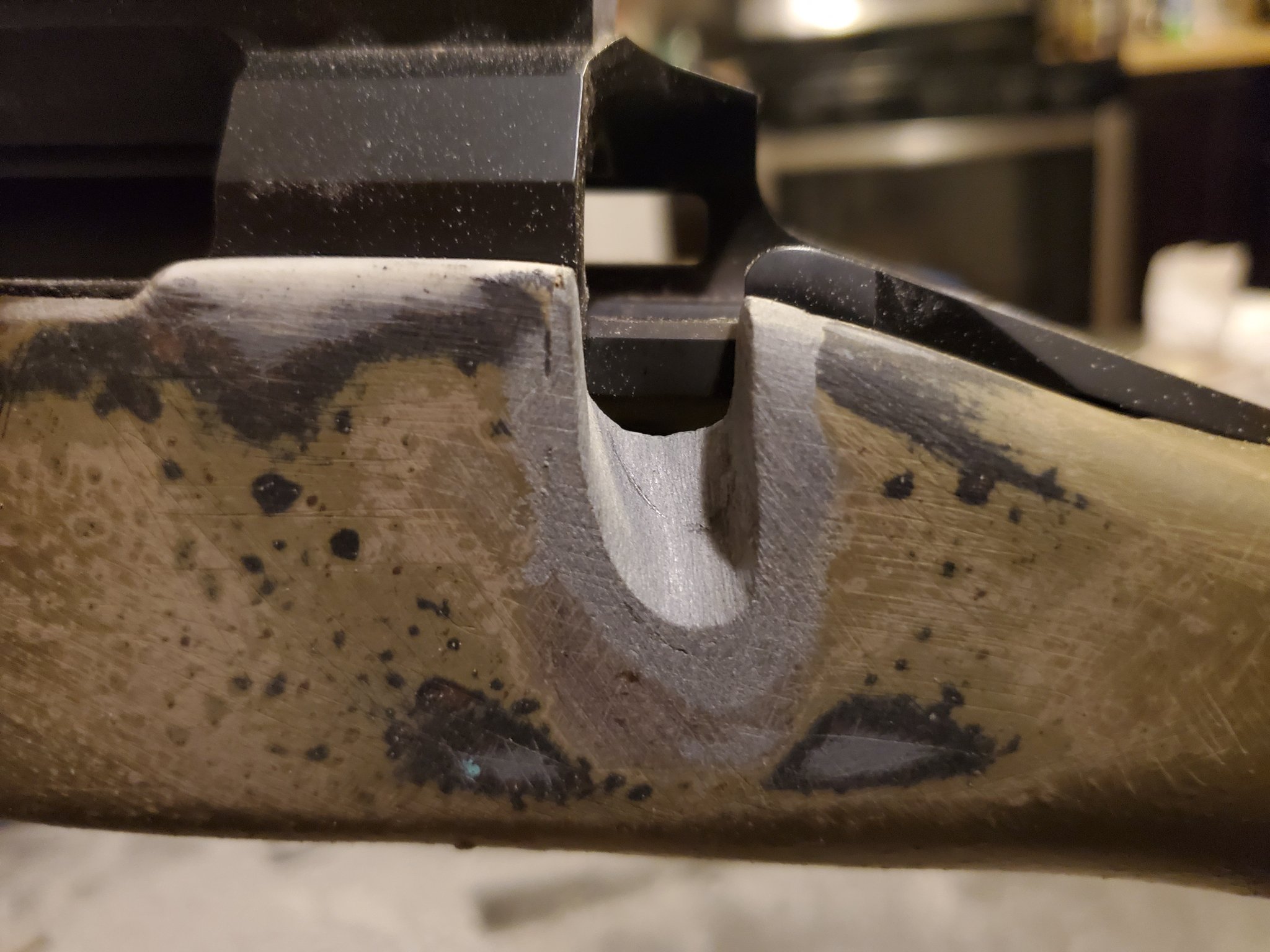

I built that rifle so yes, I chose that barrel nut.
The action is technically a drop in except for the bolt release cutout.
The stock I bought was used and had a messed up bolt handle cutout so I completely redid that. The Deviant ejection port cutout is longer than Remington so I fitted that as well. And the bolt release cutout didn't look right so that was corrected.
When it was all said and done I bedded the action, textured and painted the stock.

So this is my first "personal build". This is a Defiance Tactical in 300 WM, Bartlein barrel, Manners stock, Steiner M5Xi 5X25, Badger rings . This was my first bedding job and it did turn out pretty good, however it was alot of work. The stock was inletted for a REM LA action and a REM sendero/varmint barrel, however I did have to do quite of bit fitting in the barrel channel area, which was unexpected. I changed out the DBM from Seekins to Accurate last minute, which required more "fitting". It's not perfect but I sure did learn alot. Big kudos to the folks at Cerakote for helping me match the paint for the scope, it's pretty dam close :) Cheers
So this after about 20rds, this is the last 3 after I zeroed the turrets, factory Norma 170gr.
Defiance actions features I picked were, hvy tang, deep fluting & 20 MOA base., REM bolt handle. LA
