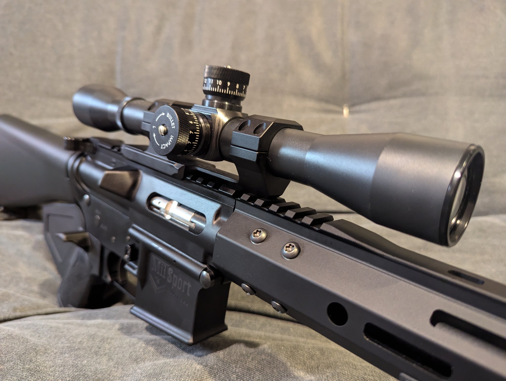

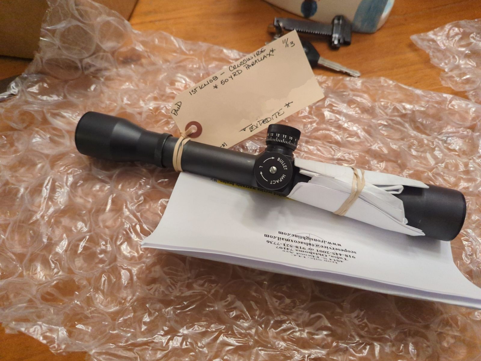

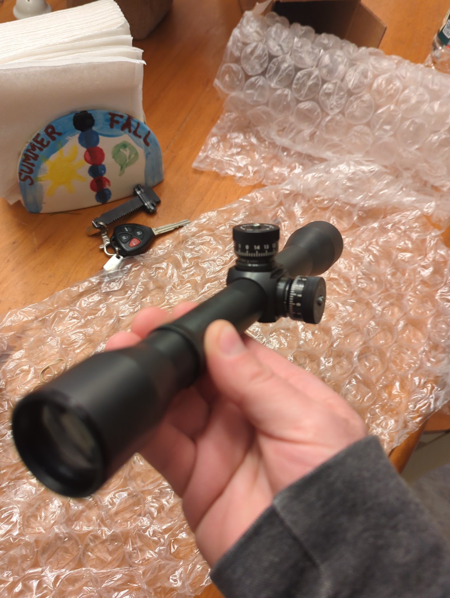

Sent it off about a month ago and already got it back...Not sure how it got expedited by Ironsight, but I am not complaining
-Cleaned/resealed/No2 purged
-Crosshair reticle installed
-Target turrets installed
-Parallax set for 50 yards

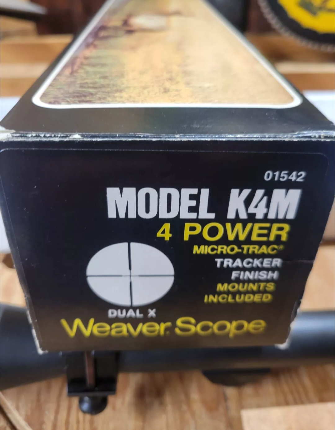

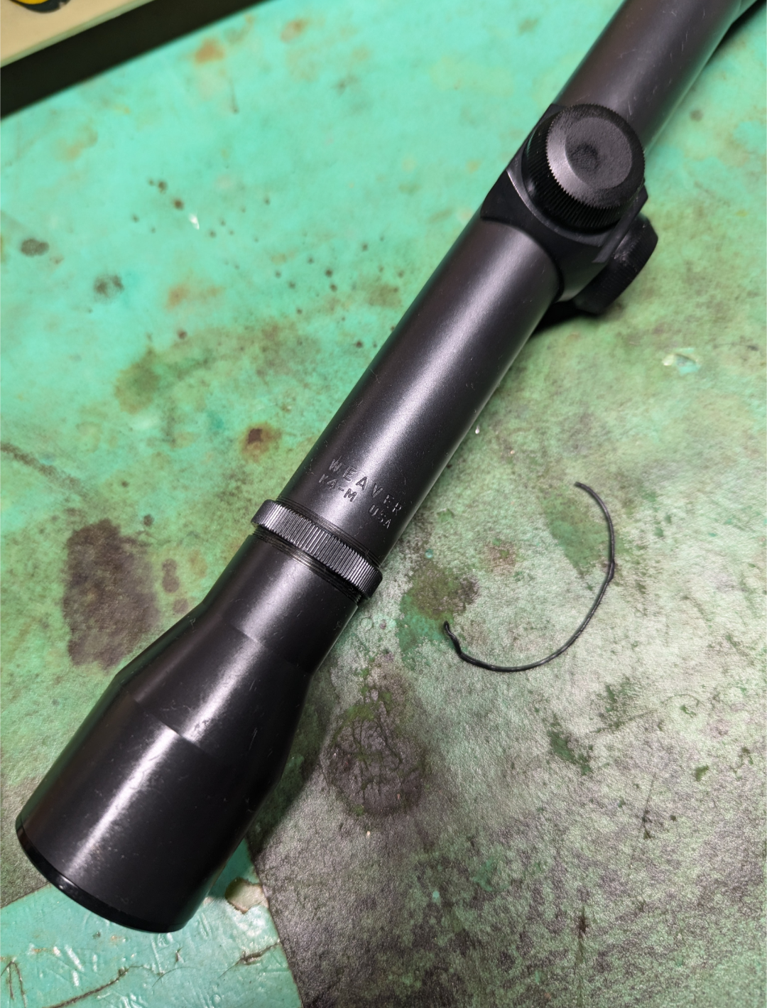

Still wondering what the 'M' in K4M means...I haven't found a single reference or mention..same thing with the 'tracker finish'. If anyone has any insight on either of those, I'd appreciate it.
This is a purpose 25/50 yard scope for CMP rimfire games.

That looks sharp! Did Ironsight refresh or change your reticle? I’ve got at least 1 K-4 with fine wire cross hairs that I’m no longer able to see. It might be worth to send it to them.
Thanks. Yeah, I had them change mine from duplex to crosshair. They have a couple other options too. A basic rebuild on the k4 is pretty reasonable. The reticle switch and having the target turrets were an added cost..in my opinion still reasonable though.

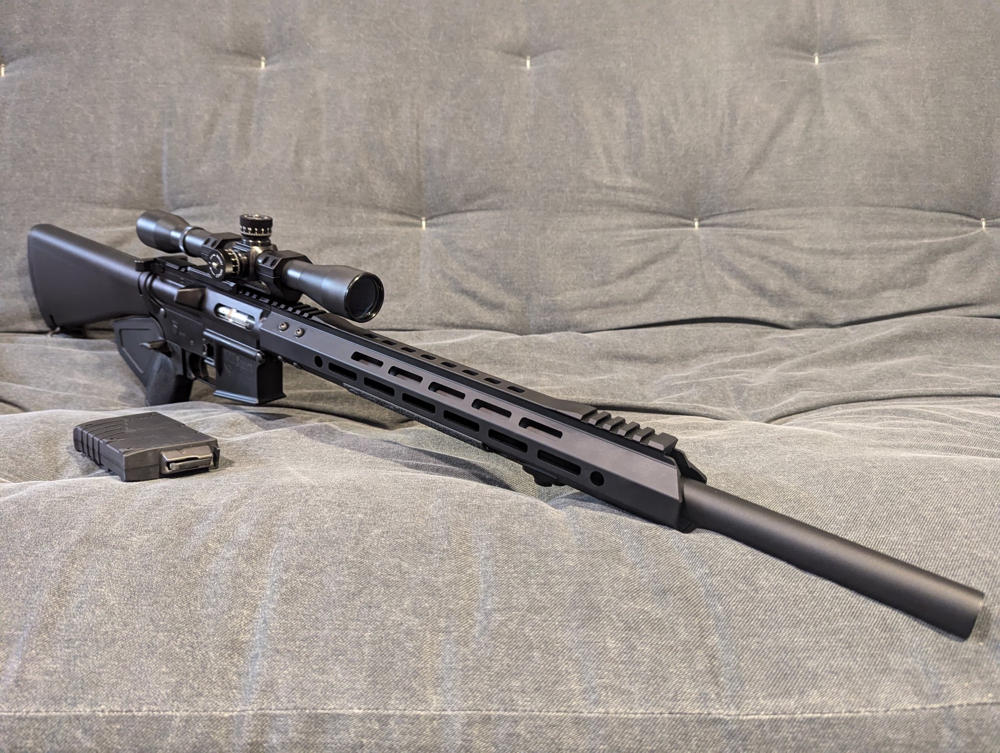

Curious about your AR setup - what upper is that? Is it a .22LR? It looks to have a dedicated magazine with a standard 5.56 lower.
Thanks...I had Ironsight redo a Lyman 20x for me a few years ago, it's still going strong... (y)
The upper is 22LR and is something I put together, definitely a one off build.
The upper receiver is an Anderson AM-9. it's a 9mm slickside upper, but works nicely with 22lr. I'm using an Acculite 22" Ruger 10/22 bull barrel with a KRISS barrel adapter and a modified CMMG bolt. The handguard is a random inexpensive 15" one I had laying around.
The lower is regular AR-15, but is dedicated to 22lr, it has a 22lr bolt stop installed, so using KRISS mags, I get LRBHO.
I'm in NY, hence the fin grip. Using this barrel system gives me plenty of options for non threaded barrels, and the CMMG bolt opens up a plethora of aftermarket mods and accessories.
Just a guess, but does the “M” denote Micro Trac? Those turrets look like the original T Series ones. They’re probably a direct bolt on with the Micro Trac scopes.
