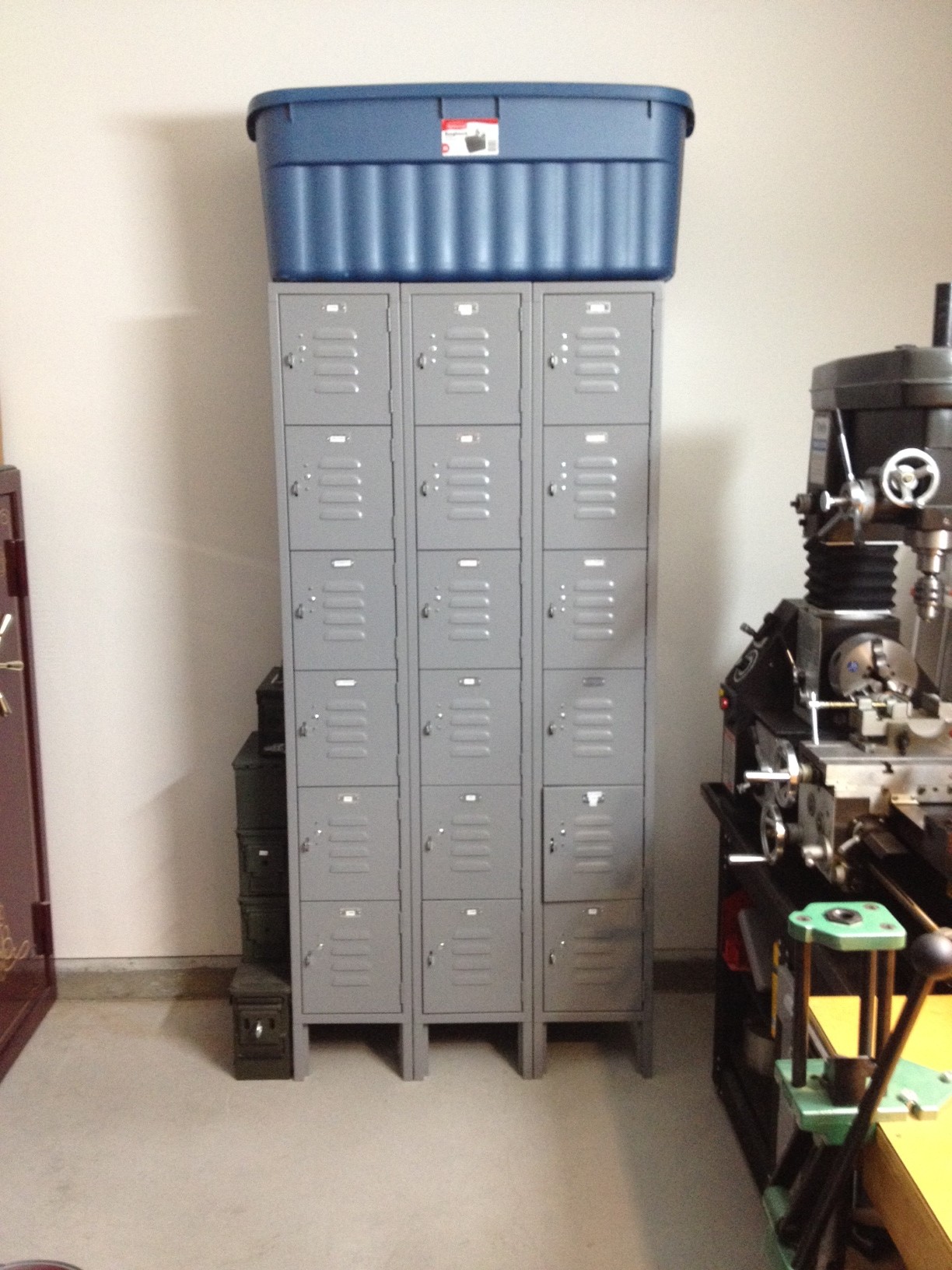

    I am not a fan off keeping powder and primers inside a safe. I keep mine in a gym locker and each bin is labeled for the powder/primer/bullets/loaded rounds that each one holds. These are nice as they are vented and allow expanding gases to easily escape without too much of an issue. While its not a full on flamable locker, it does the trick and keeps the stuff out of general sight and away from taking up room inside my safes.
