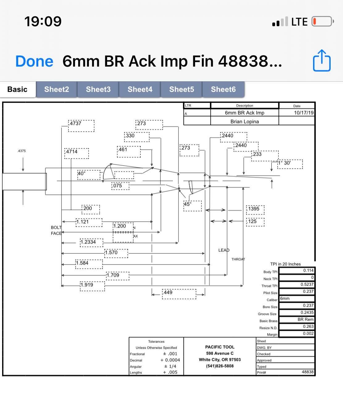

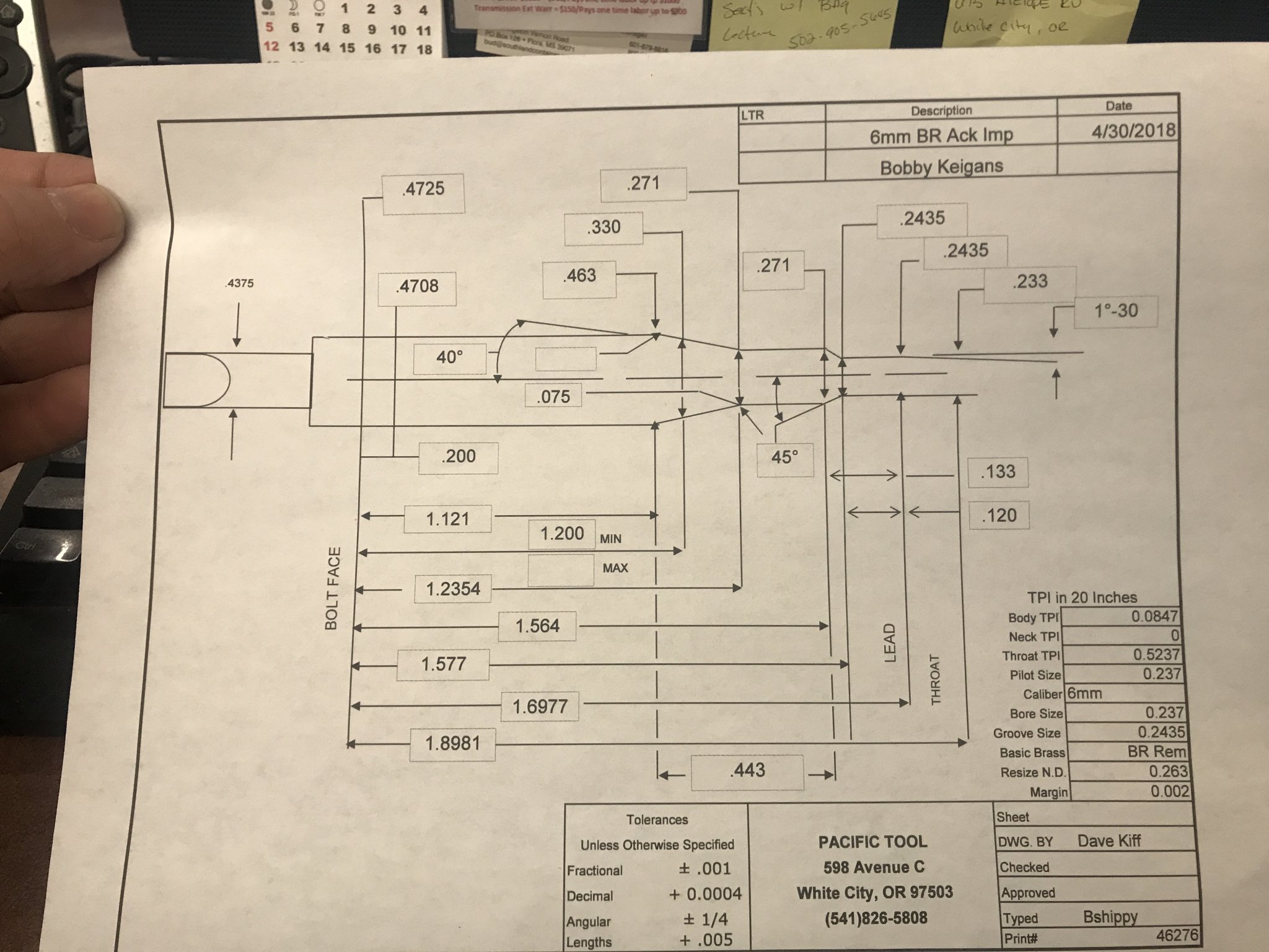

I’m wanting to order a reamer from PT&G to start a 6BRa build. The only sheet I have found so far is a .271 neck and I’m pretty sure I need a .272-.273 neck. I was looking for the Freedom Gunworks .273 neck with .120 free bore but haven’t found it yet. Anyone have any information or help on the best reamer for my application? Thanks guys.

Second reamer print is the one you want and aligns with the commonly used specs from the original Alex Wheeler print that got popularized. First one I would not recommend (base too small, shoulder too large, neck too tight).
