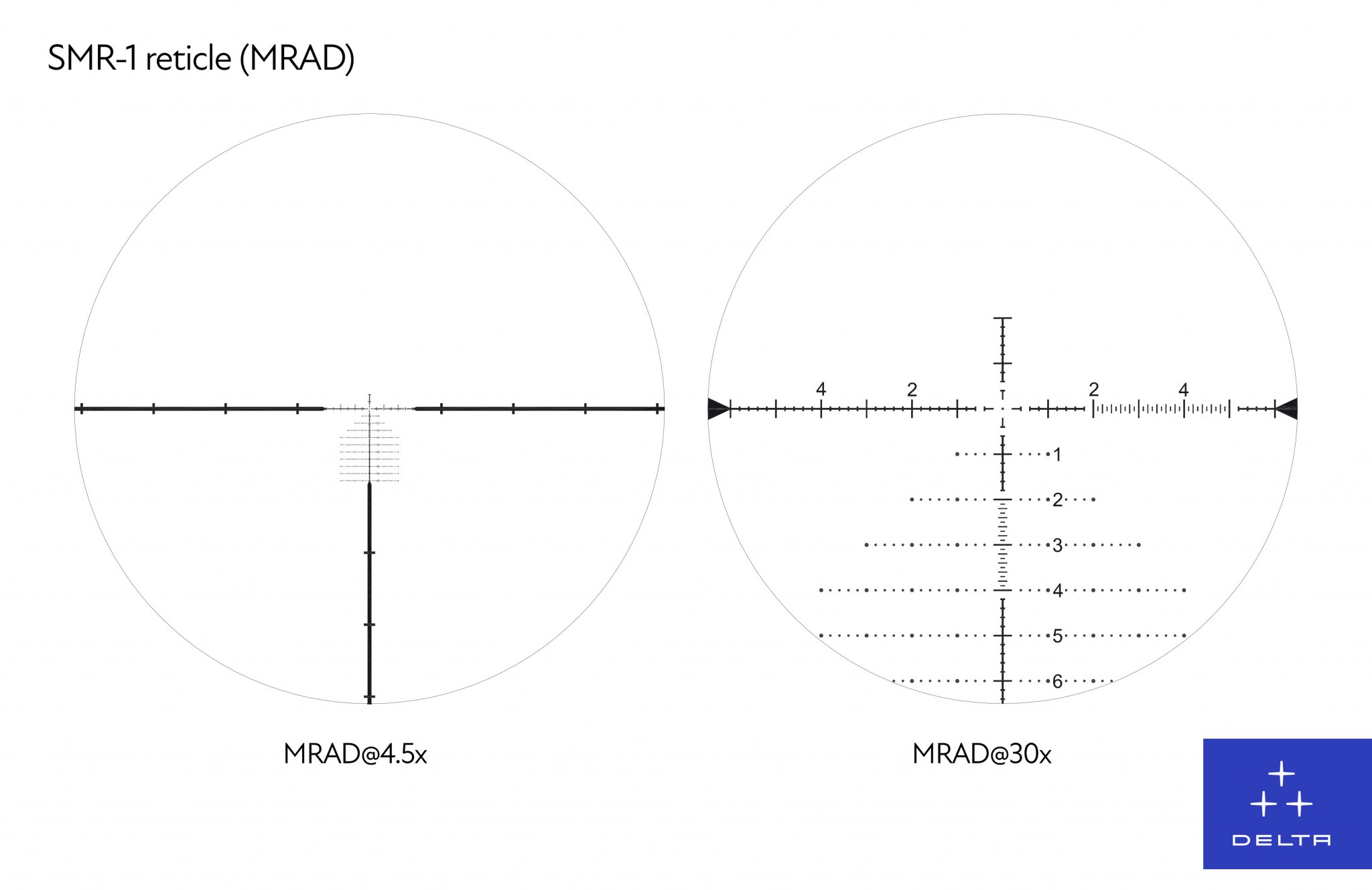

Just to clarify, the LRD-1T is only in the Stryker. The Javelin has the SMR-1 (tree MRAD) and SMR-2 (non-tree MRAD) reticles.

That SMR-1 reticle doesn't look too bad. If that had been available in the Stryker, I definitely would have considered it.

The more I look at it, the more I think I prefer the more intuitive SMR1 reticle in the Javelin... :unsure:
