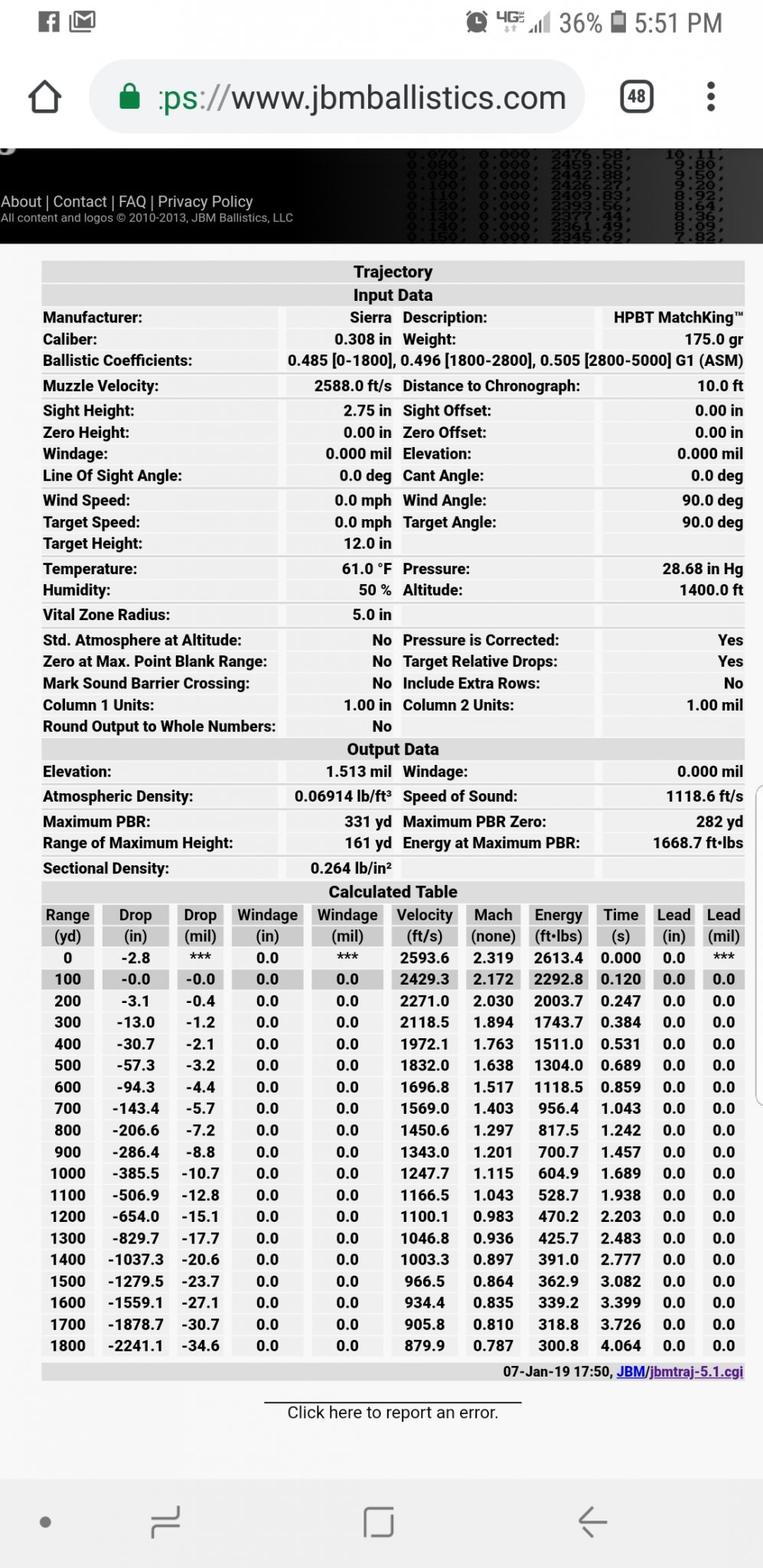

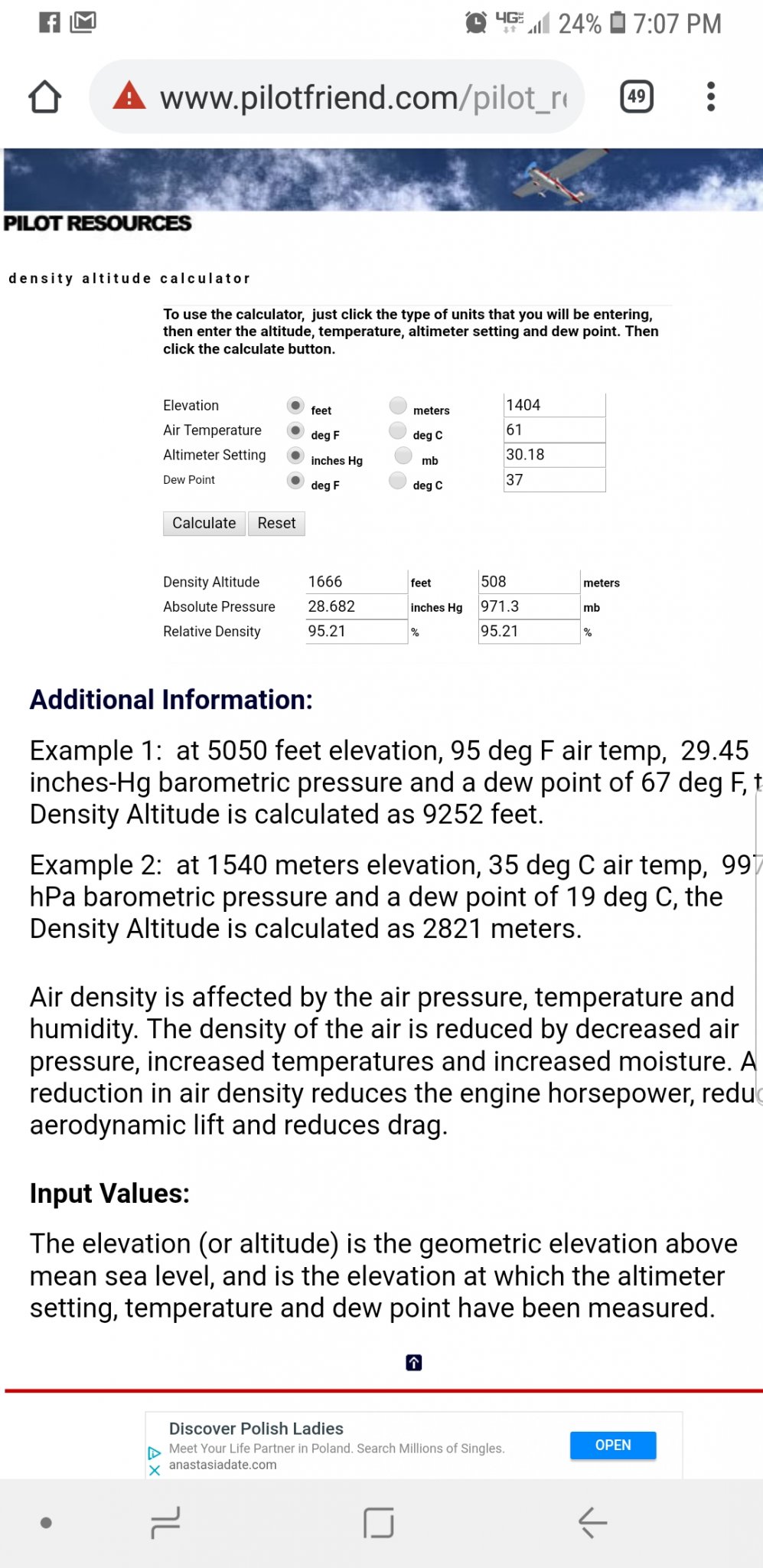

Ive been playing with JBM ballistic quite a bit latley and never realized how dramatic affect DA had on your trajectory. I ran the numbers of sierra 175gr hpbt doing 2588 out of my 20" ar10 and it shows going transonic at around 1100yards. Elevation of 1400'
DA 28.68
61 deg

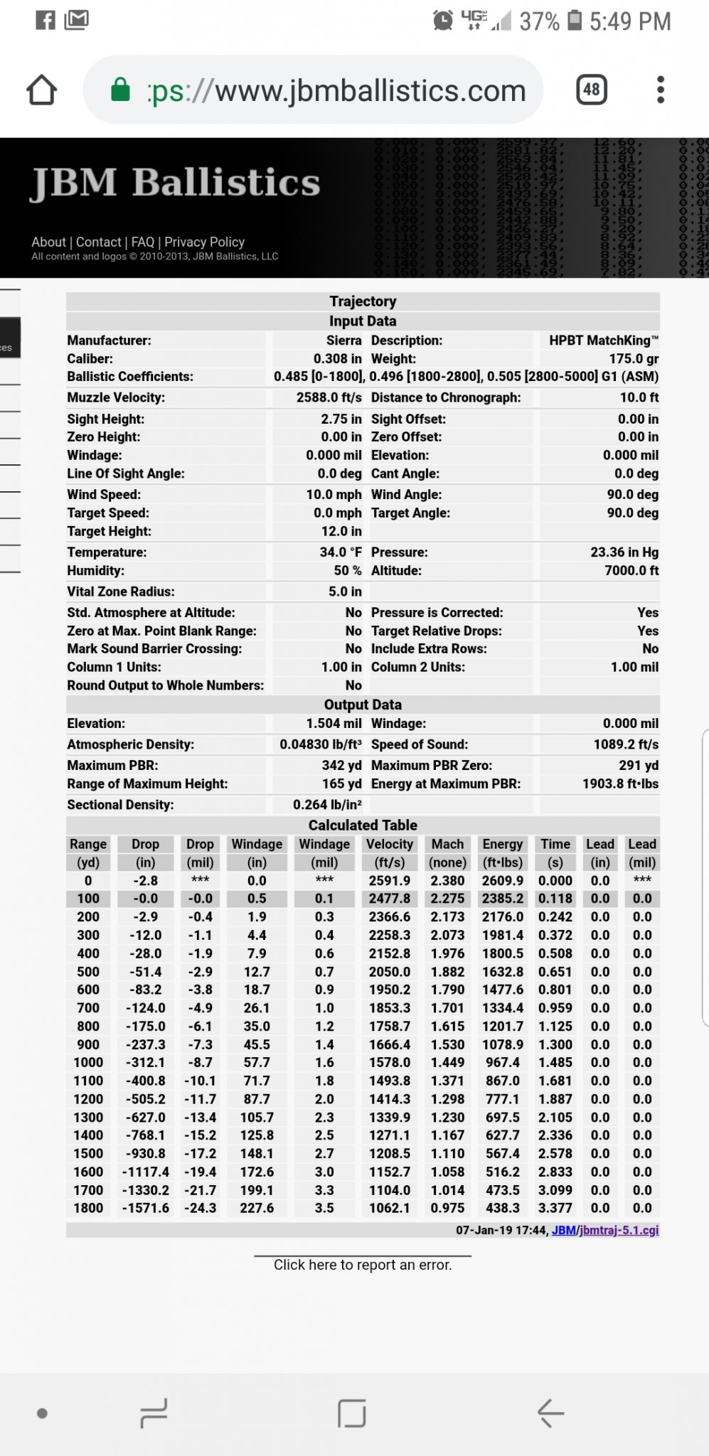

If I go 3 hours up the road the alttitude changes to 6990 and the DA is 23.36 @33 deg. It says I dont go transonic until just under 1800 yards. Is this right? Did I do this right? I am new to long range and still trying to learn this.

What you're calling Dendity Altitude is actually Air Pressure. Density Altitude is a number that combines Air Pressure, Temperature, and Humidity.
As far as going sub-sonic, you have to begin to be concerned when the bullet begins the Trans-sonic region. This is a little higher than Mach 1.

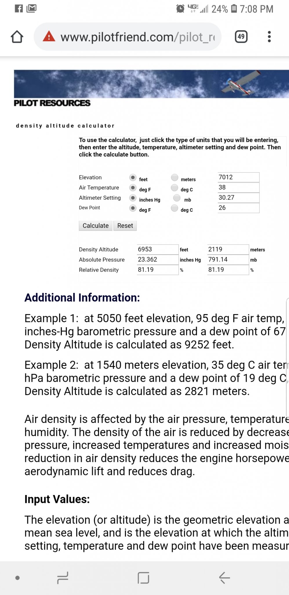

I thought the air pressure is the "barometric pressure"? The BP is 30.27 inHg. 38 deg F, 26 deg dewpoint and an elevation of 6990. Making the density alttitude of 23.36? I dont have a kestrel so im just inputing the numbers into an online DA calculator.
It takes pressure, temperature, and humidity and gives you an altitude. 23.36 is a pressure measurement. Should say something like 2000 ft which is simulating shooting at 2000 ft on a standard day.
^This. My Kestrel only outputs DA as a whole number. 23.36 seems rather low for pressure, though. Where are you located?

So when Im putting in pressure in JBM its not absolute pressure?
Barometric pressure is corrected for altitude (height above sea level) its what is commonly used by pilots, weather folks on the news, etc... Absolute pressure is not corrected for altitude. Most calcs can use either, BUT, you have to make sure the calc knows which you're using. It's commonly in the settings portion of the calc.

I see in the screenshot from JBM, it says "Pressure Is Corrected" which if I was a betting man, it wants BP. In your second example, you may have made and entry error as that pressure is extremely low, like hurricane low, that is if it's BP

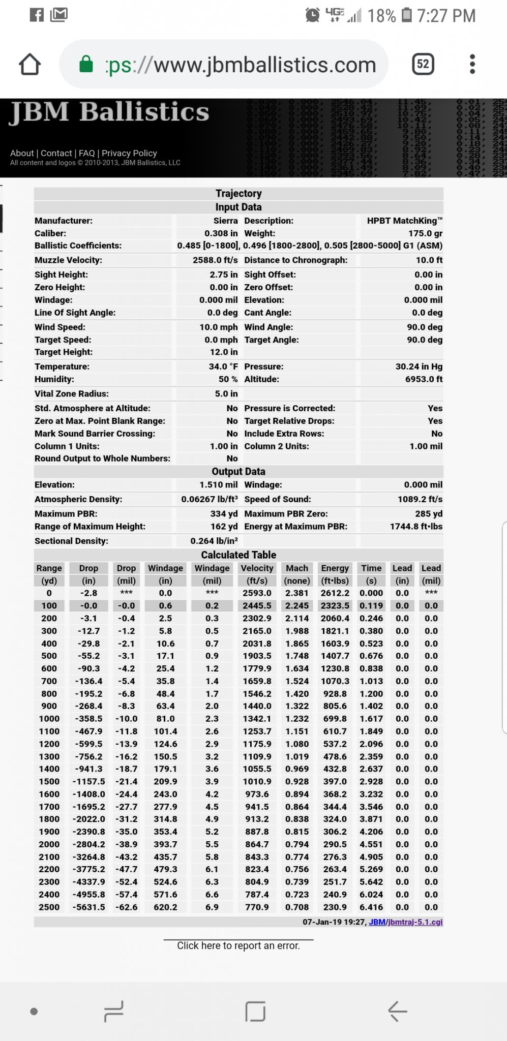

Lol so i was all screwed up. This would be more like it then?
So pressure would be BP. And when it asks if altitude is corrected, if yes, that would be DA?
That looks good to me if your putting in BP, and you would say yes because BP is corrected to sea level. If you input station or absolute pressure you would say no. DA is calculated for you after you input the pressure temp and humidity.
