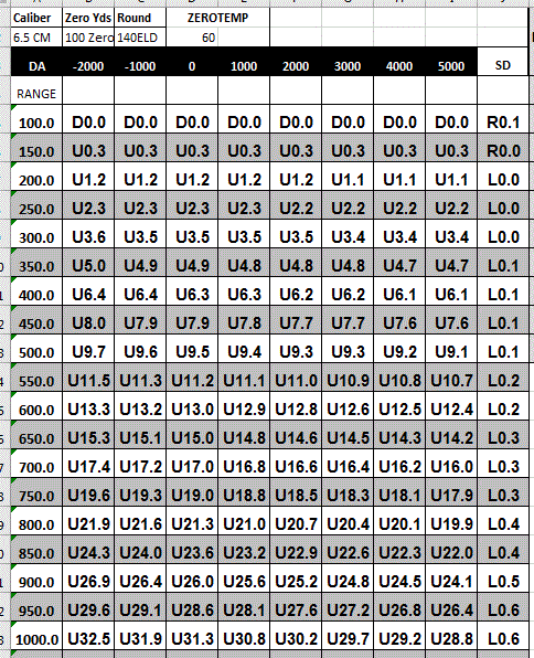

Ok.. so I zeroed in 1k DA. Then I plugged in all the different DA's in the screenshot into Strelok using my DOPE. I guess I am still at a loss as to why people say do not use it in ballistics calculators. How else would you do it without doing a whole lot of math? I downloaded all the different DA and copied and pasted them into my DOPE sheet. Am I wrong in doing this because it worked when I was out shooting 1k+.

DA for ballistic calculators was a bit of an afterthought they were originally written to use the raw data, but today it;s not much different to use the DA. In extreme examples, there are variations when you combine extreme temperature swings, but for 99% out there, it's a non-issue.
Not saying the data you posted is correct, but let's assume it is, you created the correct way to use DA, the software manages it and then you can print a hardcopy to reference absent software.
The difference is probably those who want to use software and electronics vs those who do not and want hardcopy data. You are probably hearing this debate.
There is no real rule of thumb with DA, so you have to use software to establish the values minus shooting under those conditions

Buddy you are kind of overthinking this. You are already setup and have a better understanding than 99% of the general shooting population, just forget about the “don’t use DA” aspect.
