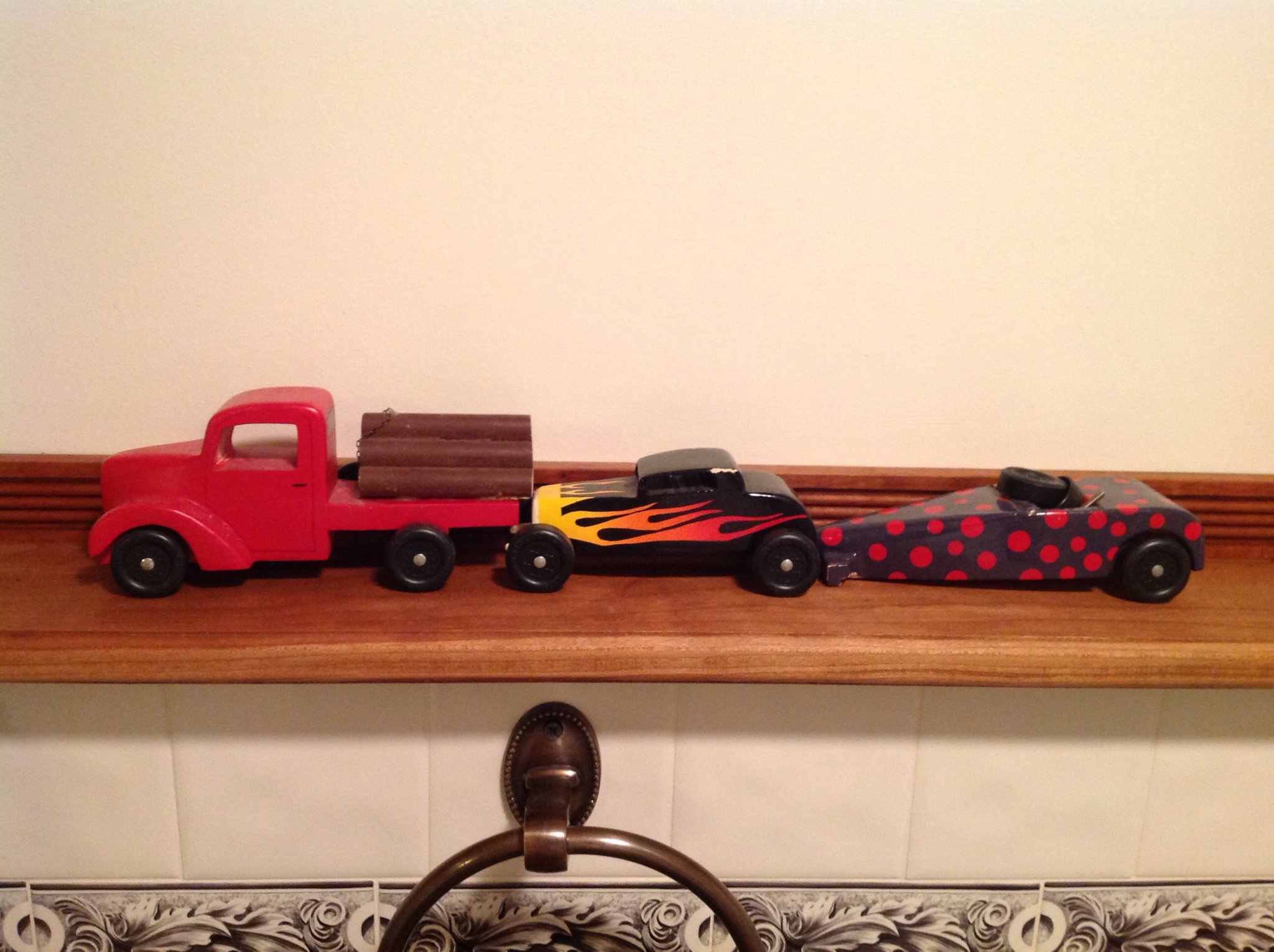

They are in need of some repair....
They never ran fast but they looked good.
