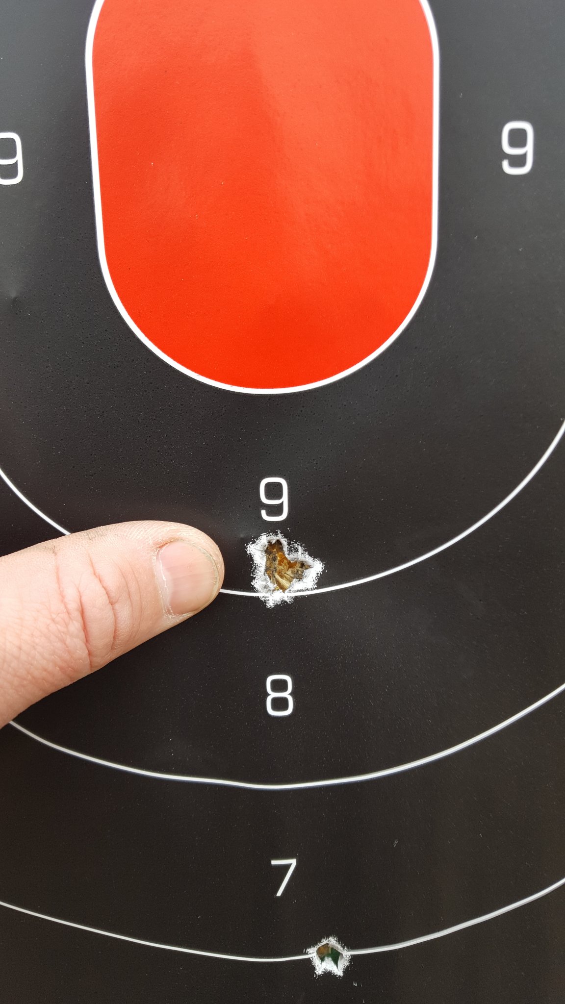

I love my 17" 260. I never developed a new load for it because it liked the same I shoot in two other rifles. That was a 3 shot group with less than 10 rounds through it. It's slow at just a little over 2500 bit with single digit sd's I figured it wasn't worth messing with.
Here's the picture since it wouldn't upload earlier for some reason.
