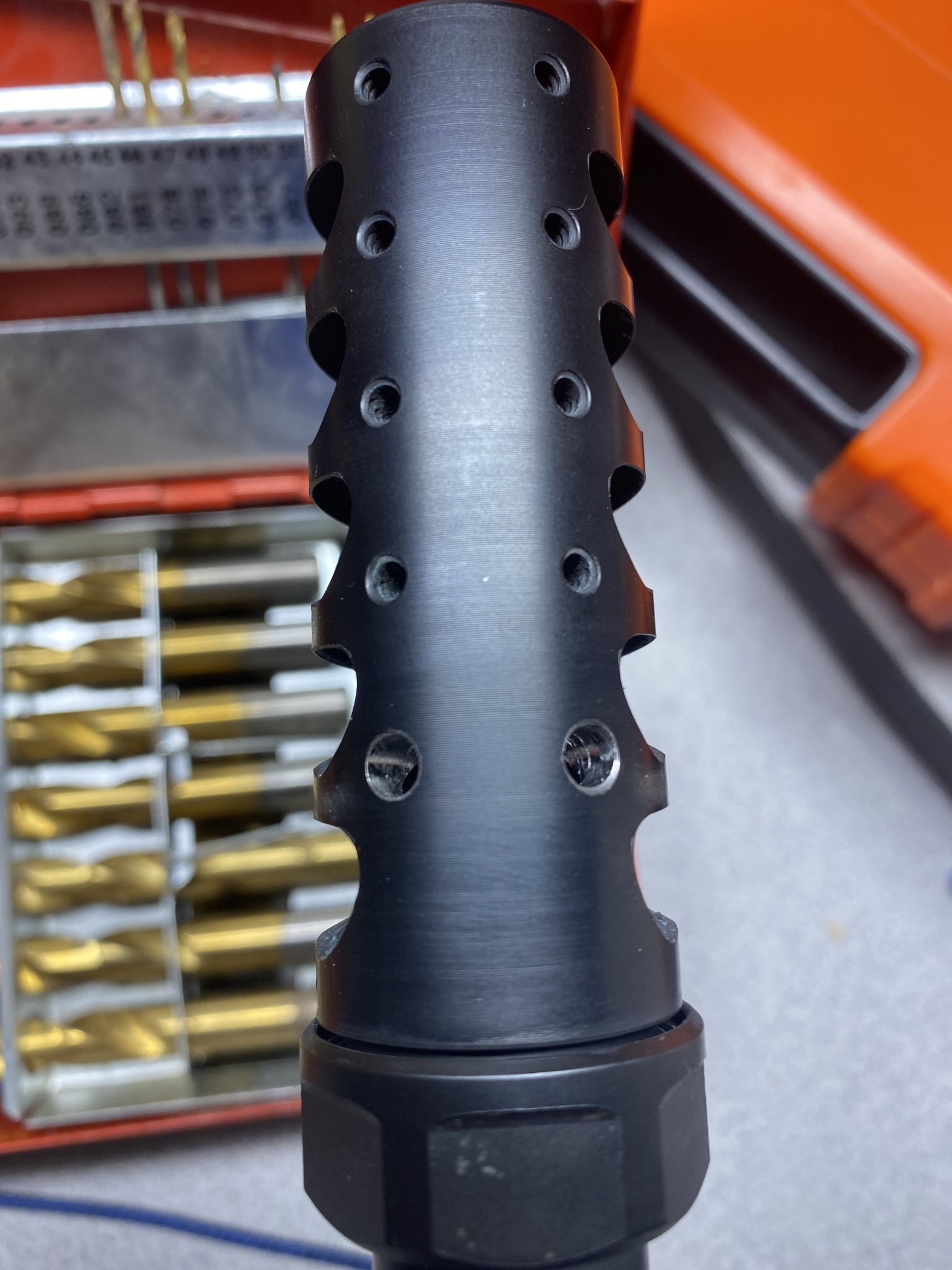

I drilled two holes out on the AP brake so I’m going to see if that helps at all at this weekends match. If it appears to help then I might drill out some additional holes.

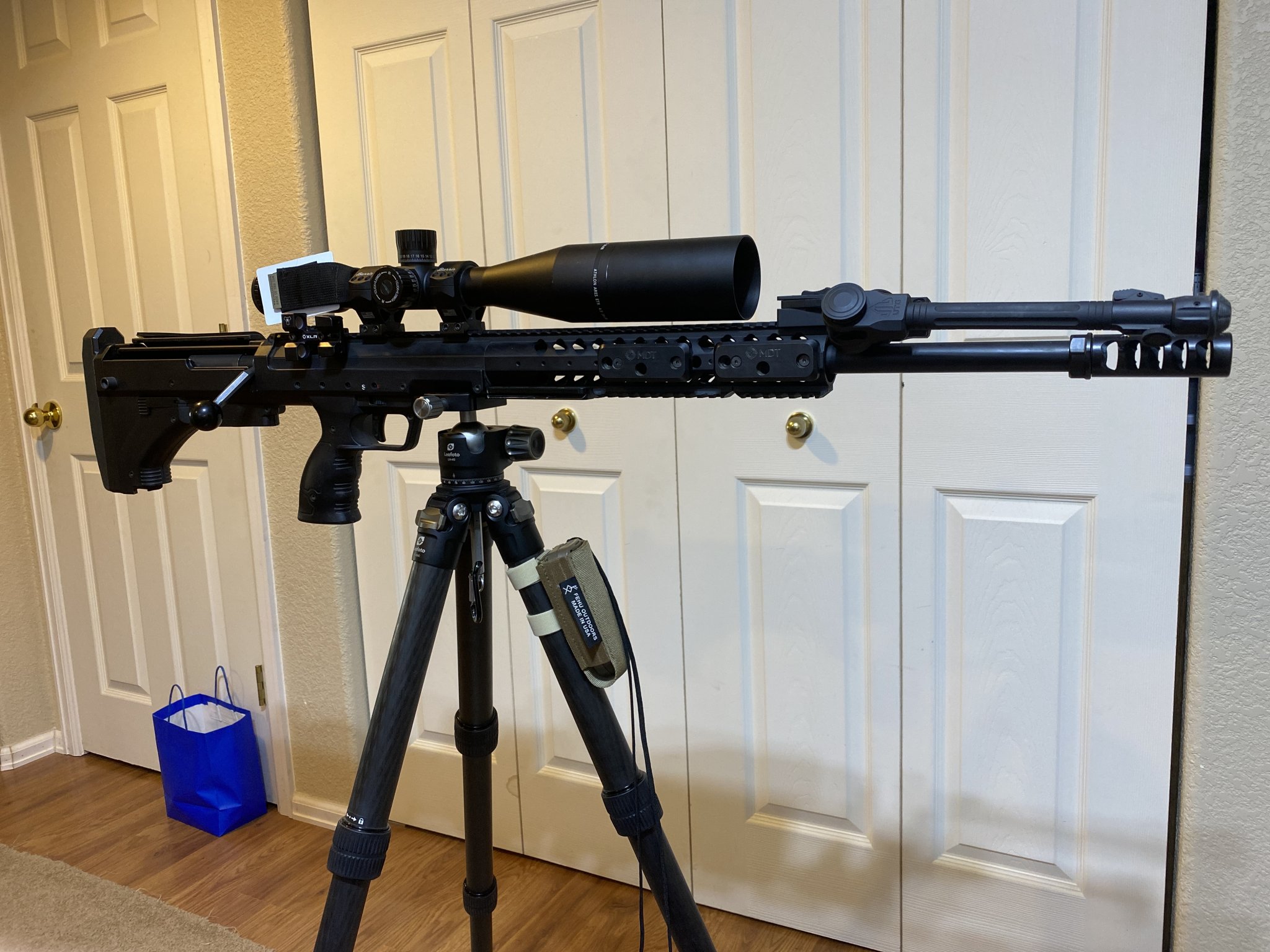

Here is my rifle and it’s balancing point (not clamped) with a 28” barrel and the weights I have added. Even removed the monopod but that’s not much weigh. Seems very balanced but yet a massive amount of muzzle rise. I have taken me out of the equation and just compared free recoil to that of a traditional action rifle. Massive difference and I just don’t grasp why. I might have to call you.
One thing I've seen a few times before is the "snaggy grippy" nature of the handguard to skin transition right there where yours sits. That stuff grabs onto your bag and will cause it to rock, rather than slide. The RRS plate I've mentioned helps considerably with that. What contour of barrel you have there? It looks like your balance point is just barely in front of the trigger guard. To help things out, you'll really want to get that balance point out onto the handguard a bit.
Hi,
In short.....
With the DT the "detonation" is on top/behind the user interface (Trigger Hand).
With traditional bolt actions the "detonation" is far in front of the user interface (Trigger Hand).
In layman terms.....Think of it this way.
Way easier to pivot something in the middle (DT grip location) than to pivot at a spot that is more off center.
Sincerely,
Theis
Reactions: Juggerxxx
