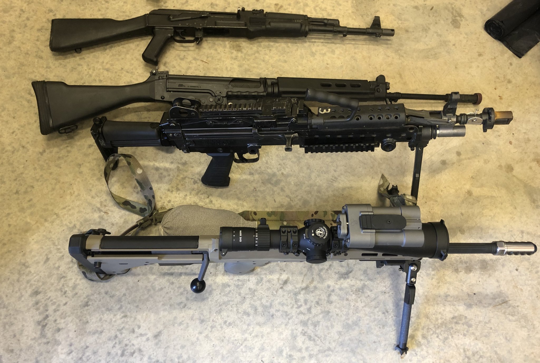

I honestly don’t know why more people don’t talk about these
best damn long rifle I’ve ever shot
best damn long rifle I’ve ever shot View attachment 7543759
Well, there is a 272 pg thread pinned to the top of the forum.
Otherwise, price vs niche. A lot of people will have no use for the pros of the bullpup design vs the cons (proprietary parts, questionable CS, ergos, no trigger options, etc.)
Reactions: illbits and SRPowah
