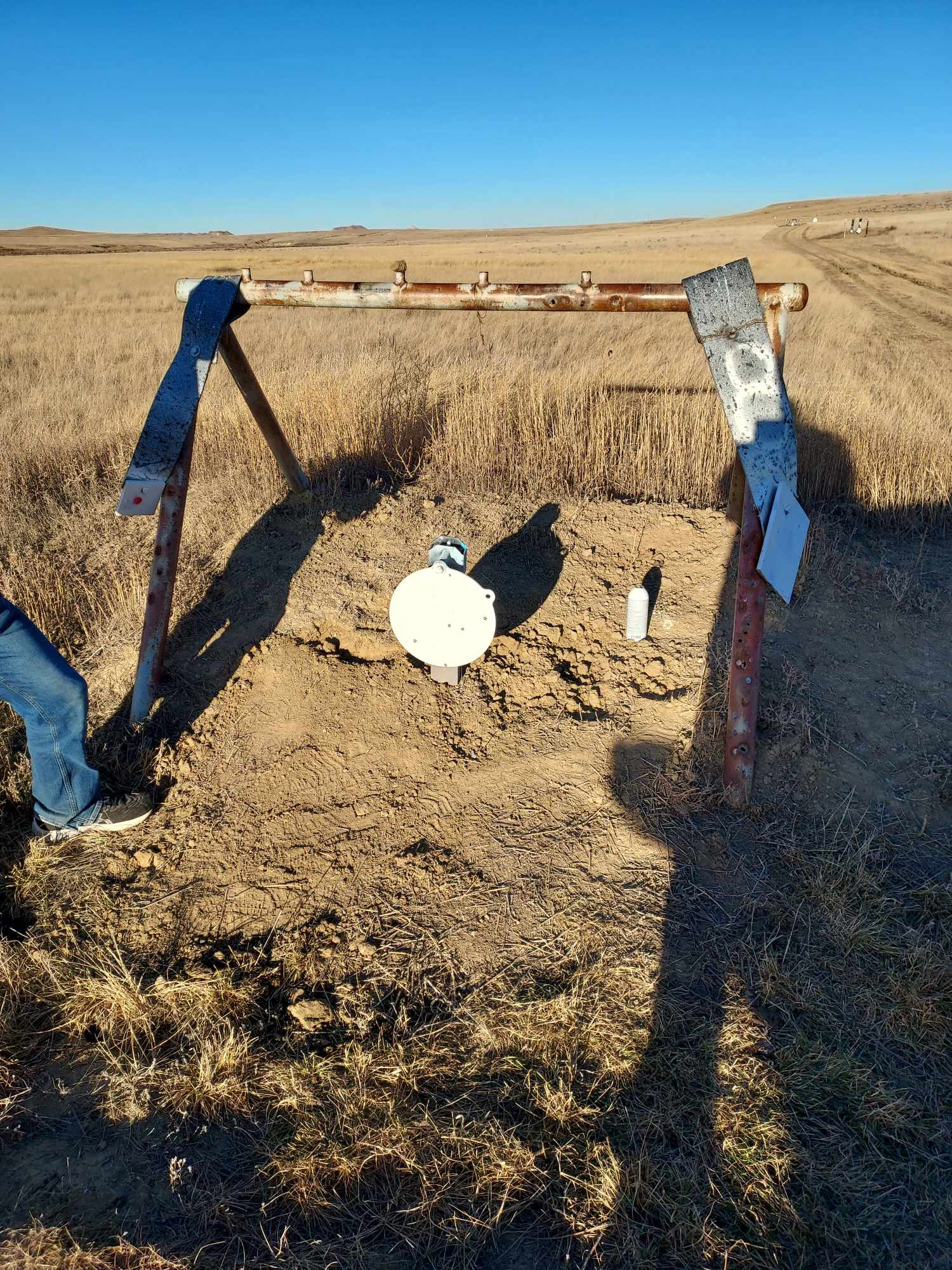

I shoot quite a bit at 600, at 4700 ASL, and if there is unpredictability, it is atmospheric conditions, not so much rifles or ammo, both 16tw and 13tw barrels.
I've had a couple decent days at 700 also, and we are talking calm days, and for 1day around Christmas last yr, we were hitting 800 with relatively< keep in context, accuracy, both 16 tw Vudoo and 13tw Rim X, Lapua and RWS ammo.
We TRIED 850 & 900 the next day, with a March Genesis mounted and failed miserably, why I am in this thread.
800 yards, 4 mags Rim X, 20rds on the 12" plate, 20rds at the paint can, we weren't missing by much. The Vudoo connected on a 24" plate earlier that day, but no resemblance of accuracy, also no indication of tumbling.
