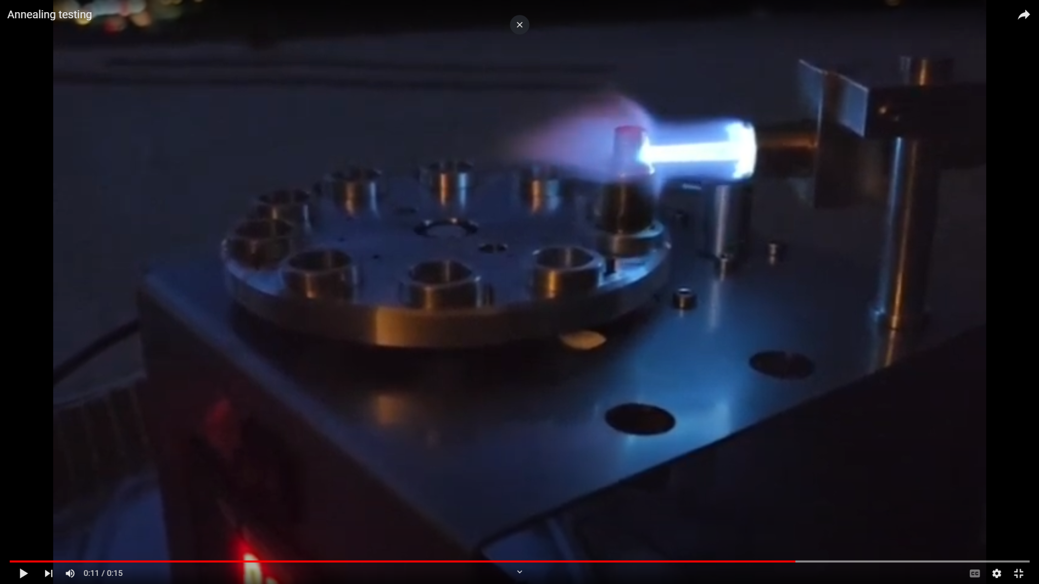

Maybe it's because the caffeine hasn't kicked in yet, but am I missing something here? Neck starts to glow at about 10 seconds (faint). Flame contact starts at 3 seconds, so you're at about 7-8 seconds anneal time. Just gotta ask, have you ever been diagnosed with color vision deficiency by an optometrist or ophthalmologist?
Initially I thought you were kidding, but with the timestamps you provided, I think you might be right.
I'll show the video in person to someone and see if they notice it. My optometrist didn't say anything, a few months back.

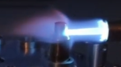

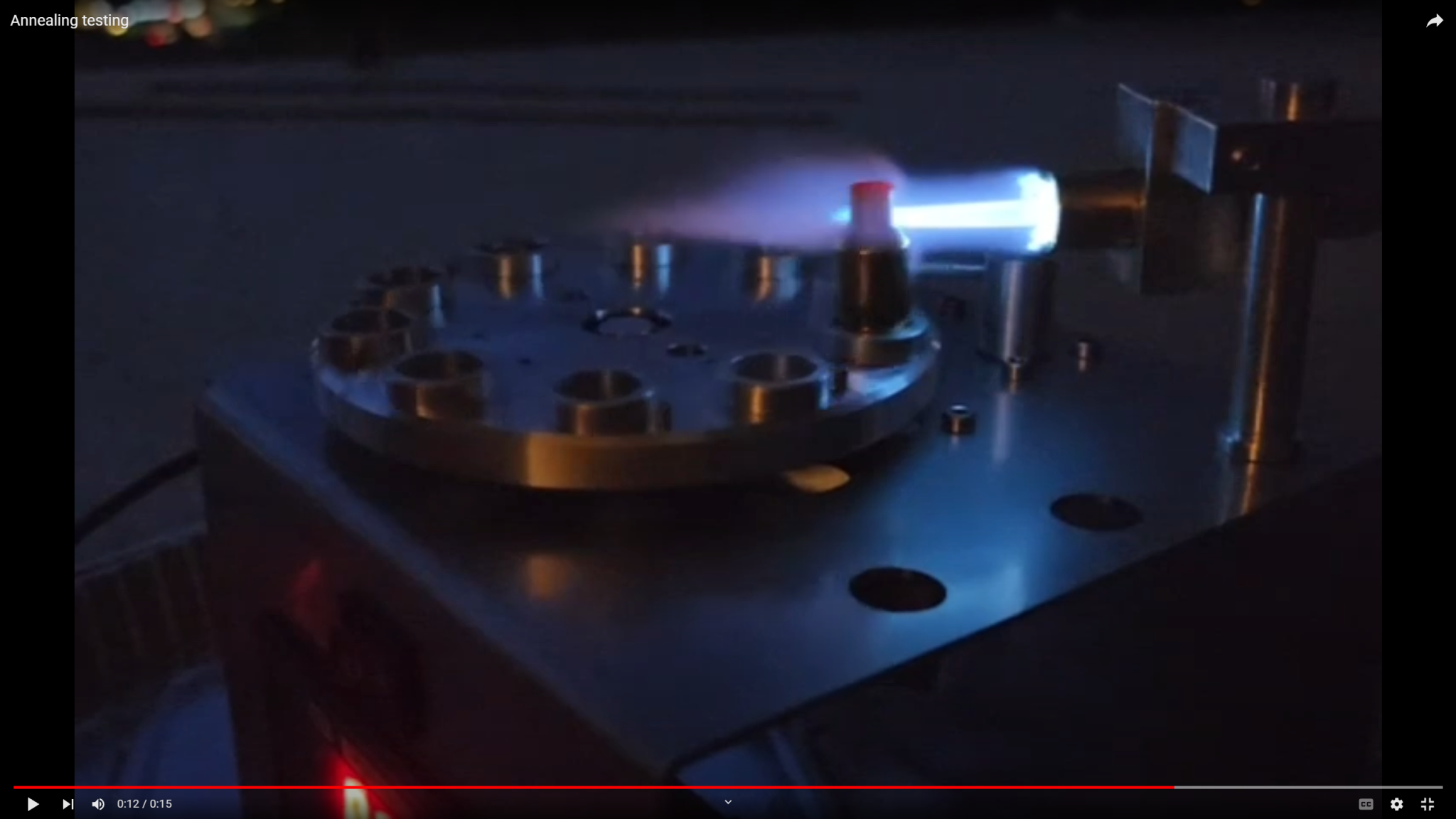

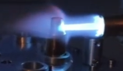

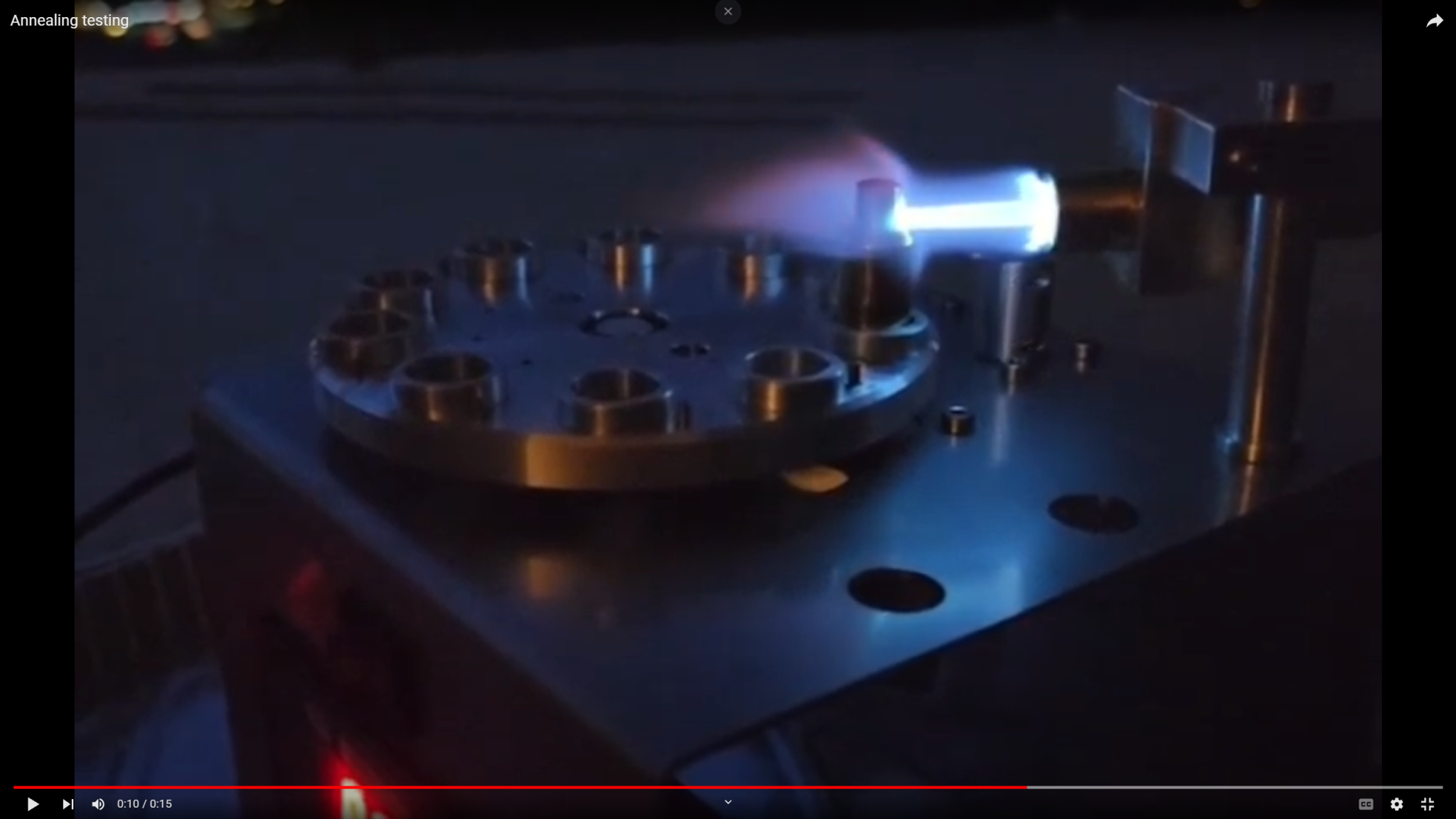

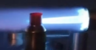

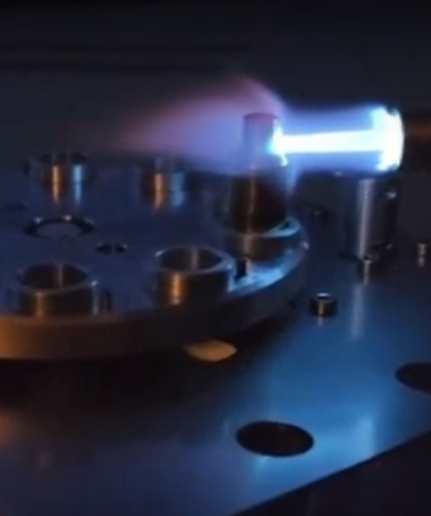

OP this is 10.0 and 10.5s,
the fram before the pictures above...
note 1 the "color flash" in the flame/halo...
this is a different indicator than the dull red neck,
but typically has some luminosity element vs just pure color
you maybe able to trigger off if you're having some color issues.
IIRC...if you see a later color flash with yellows, greens etc
thats typically bad means some alloying elements are burning off
this looks pretty decent to me tho...
las frame shows brass out of the flame with red glow,
no crazy rainbow colors...
I think overal (eg...last frame) looks good ...?
