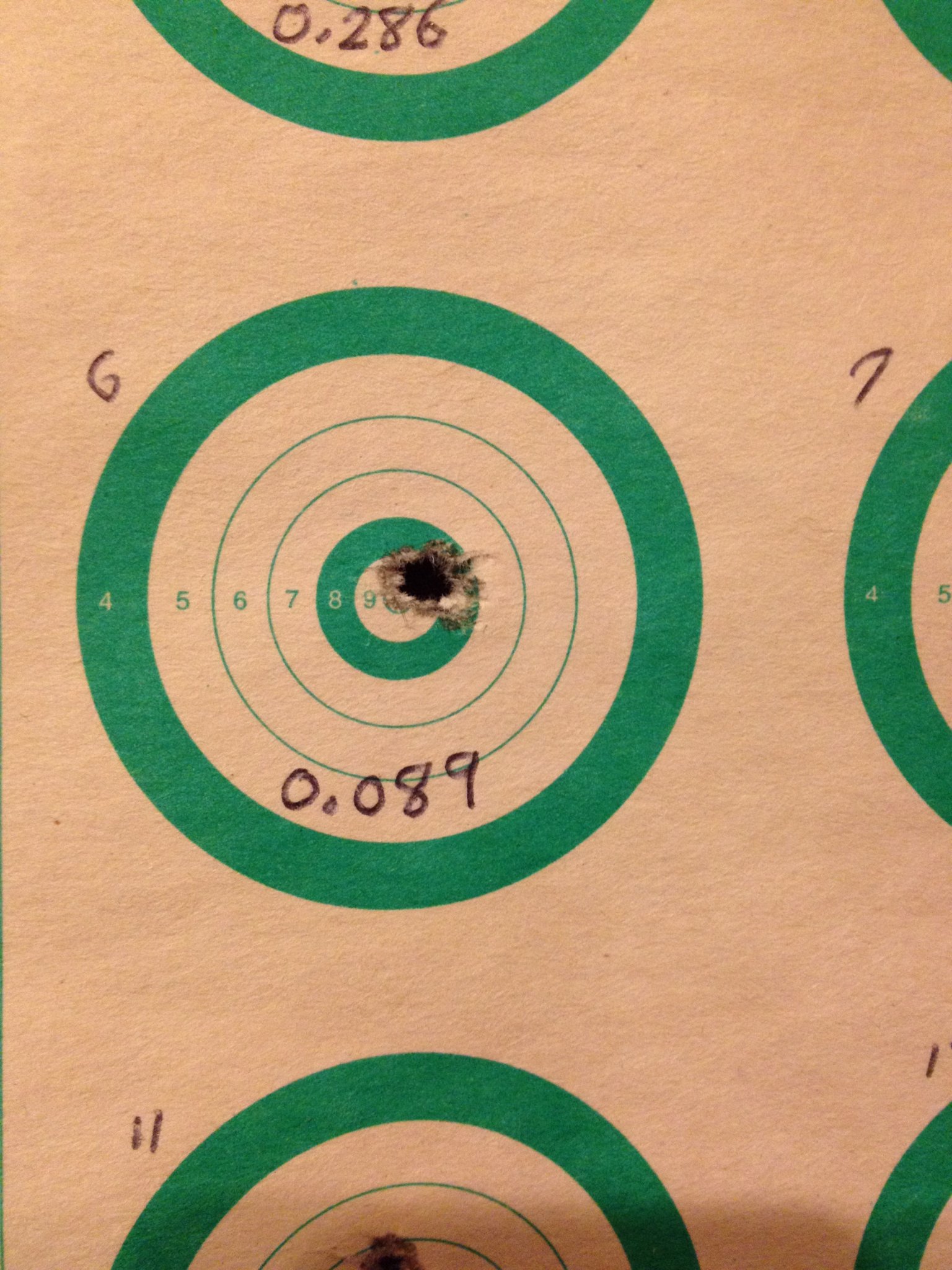

Once you do find that magic lot#, and buy a truck load of it, be sure to properly store it in a cool, dry comfort conditioned space so it will not rapidly deteriorate over time. Even with all that, I have found that fresh 22lr ammo shoots the best and lots that are even 2yrs old usually have a few more flyers than they did when new. Unless your rifle shoots 1/4" groups at 50y, you will never notice this. The testing process is one of the fun things about rimfire and the reward is a rifle that shoots way better than it should. I attached a pic of one of my Annie's results for 5shots at 50y using Midas+ That is what you are looking for.
