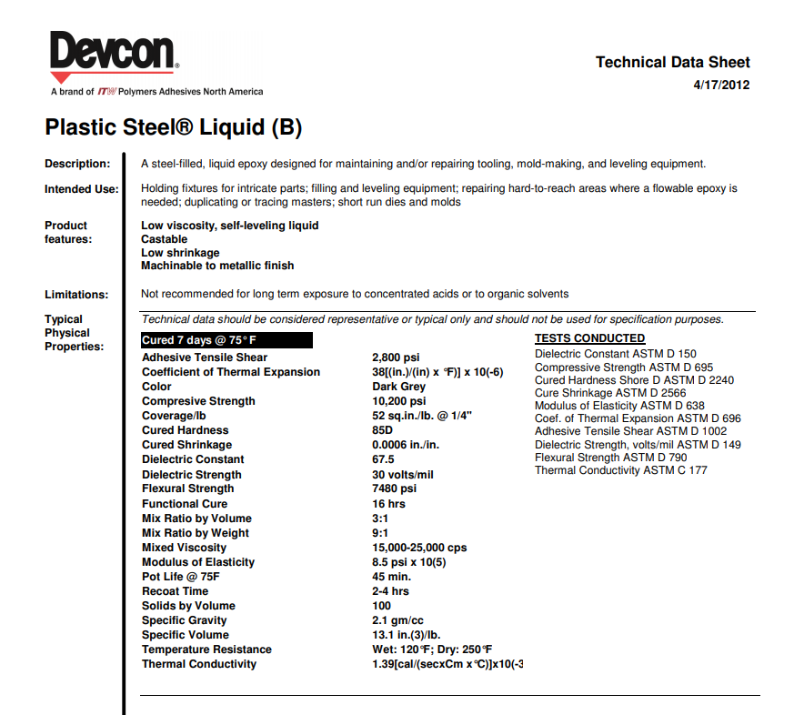

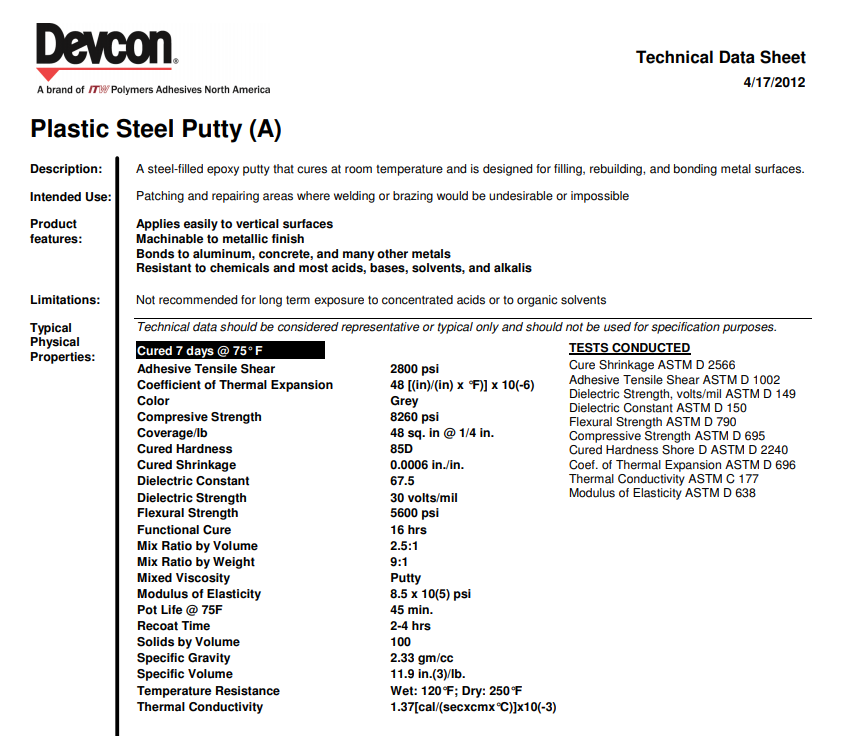

I did a little more digging and found out the the residential "Home" Plastic Steel is also known as Devcon 10210. It has the same specs as the Devcon 10110 "Putty". I might try the putty next time. Anyone have experience with this?
Looks like the specs are a little better for the Devcon 10210 vs the Putty 10110.
