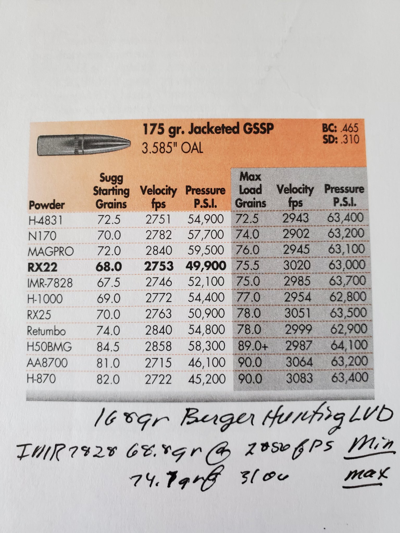

Hello everyone,
Long time stalker first time posting up. This is my first precision gun of any type. I came across something from a seller and we made a deal. Picked up a very clean REM 700 Sendero 7mm STW . Well I really didn’t think getting ammo or brass for starters would be as hard as it seems in today’s market. I have read several of the posts from others here but wanted to reach out to all the professionals in the community for some guidance moving forward. Frankly I’m not a reloader because I have never had the need. Well that’s changing ASAP it apparent. Is there anyone out here that’s shooting one that’s been reloading or also knows were I can get some factory ammo still? I have found some Nosler off Ammoseek and picked it up so I have some brass to learn to reload with. Any help would be great and thanks again.
This will be a long range Elk and Mule deer gun mostly and maybe a speed goat gun too.

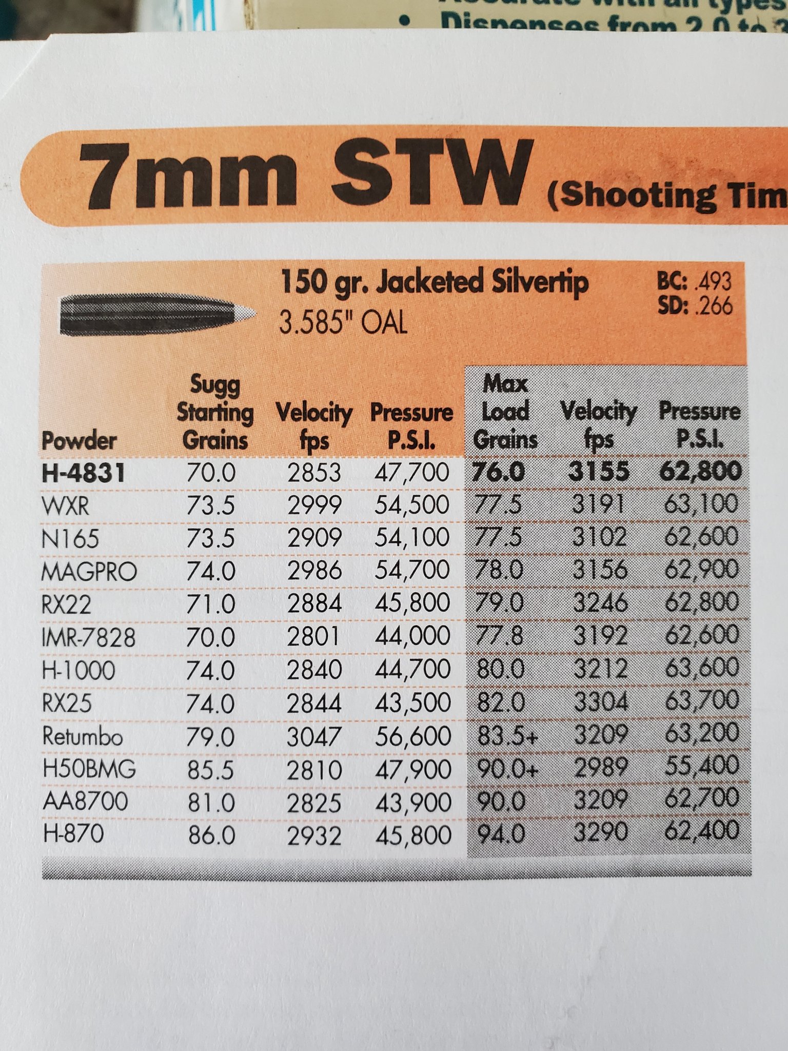

If I reload I’ll reload some heavy just to see how it likes the heavy Bergers. I think I seen some 190 or 195 bergers at the last gun show. I would hunt with 160 or 175’s at least. I just don’t like my game to turn into fast food and run off.
Yeah I don’t want to even tell you what I have gave for the factory loads I have dug up already just to get brass for reloading. I have a line on a few more boxes of Nosler 160’s but they are not cheap. I think I have a good 300 rounds of factory ammo right now. I still feel like that’s just a good start and I want to find brass to reload and it looks like 8mm REM Mag will be the most available right now.
Don't get me wrong. I am very set up to reload and have been doing it for decades so I would probably just get stuff as I find it and keep that old rifle as a 7STW. Just for the heck of it. I have LOTS of other options to shoot with so that one would just be another and unique.
However, since you have never reloaded and do not have all the gear, it will prove expensive to get it all set up. There is a lot to it and it gets more expensive the more you get into it and search for perfection. You can be well above $1000 in a hurry and that is not buying the outlandishly priced stuff. And I am not even including the brass, primers, powder and bullets. Of course, once you have all the measuring tools and the basics (like a press), a new caliber is not much more than a new set of appropriate dies.
I am not trying to discourage that either. IF, big IF, you want to get into reloading. It's the way to go, as far as I am concerned, to gain the most from your shooting rig and especially for the more obscure cartridges.
I'd say that 300 rounds to reload with are PLENTY for that hunting rifle.
But...there are other chamberings that are more readily available as factory ready to shoot off the shelf ammo. Barrels are not exactly readily available right now either but you can get a blank for around $400 if you shop the want ads and another $400 or less to have it fitted to your action in the chambering you want.

For reloading, I'd jump up to the Berger 175 Elite Hunter bullets, backed by Winchester StaBall HD powder, or H1000, and some CCI 250 primers.

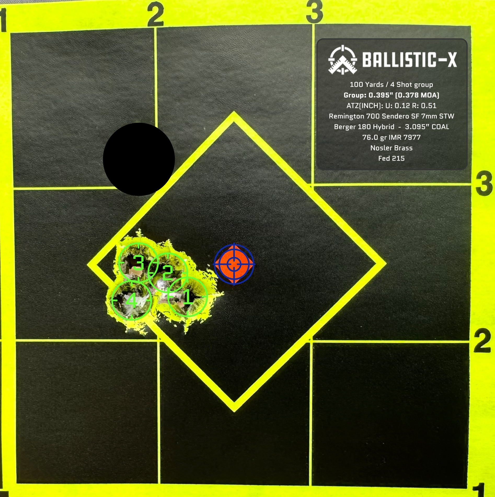

In any case, I am all in, doing the accuracy reloading with 0.310 sizing for a 0.001 neck tension on factory Nosler brass with loaded 0.311 necks with Berger 180gr hybrids using Retumbo (starting low at 70 grains and working up to 80 or so). Goal is long range steel banging with sufficient cooling times in between. Barrel gets changed when its time, not worried about it; like a tire, change it when you have to. Lots of decently priced factory 7mm barrel pulls with no rounds down them on the Hide Exchange, eBay, etc. MODBB from Bartlein I do not think is worth the money or the time given the short barrel life; rather, just will go with off the shelf pulls on the relative cheap. Figured good to have one hot rod in the stable that has an excellent pedigree and not as bad of a kick as I thought it would have. Then again, it is braked well (spiral radial brake flush fit on M24 profile barrel) and I only shoot it when no one is within 10 feet of me.
