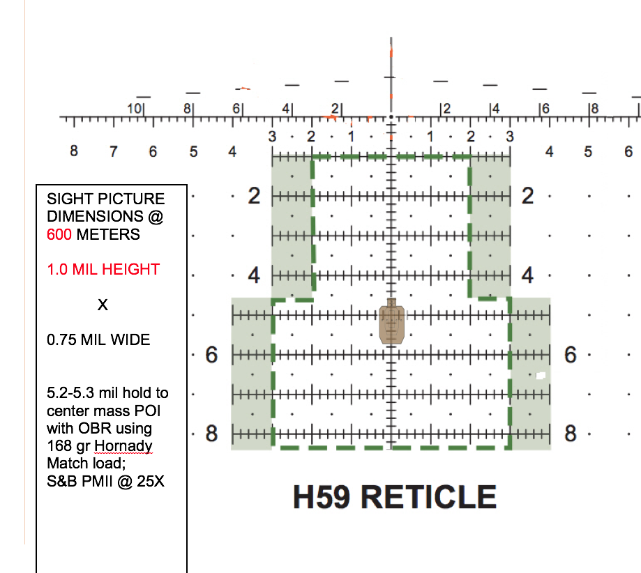

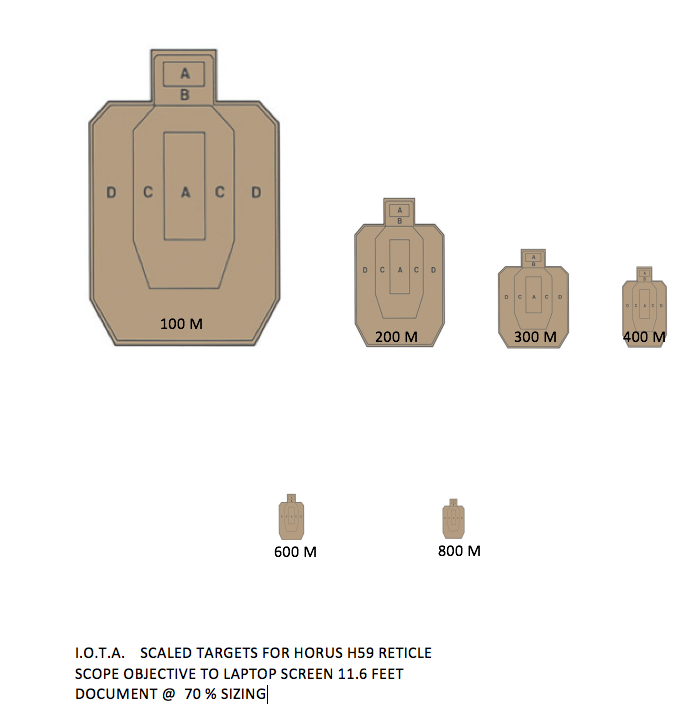

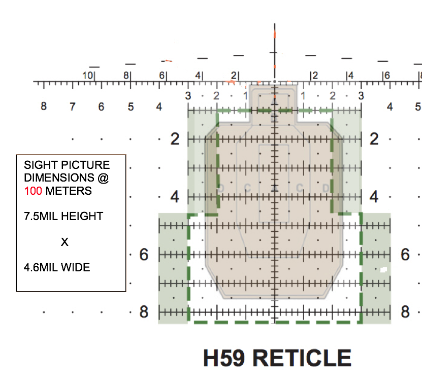

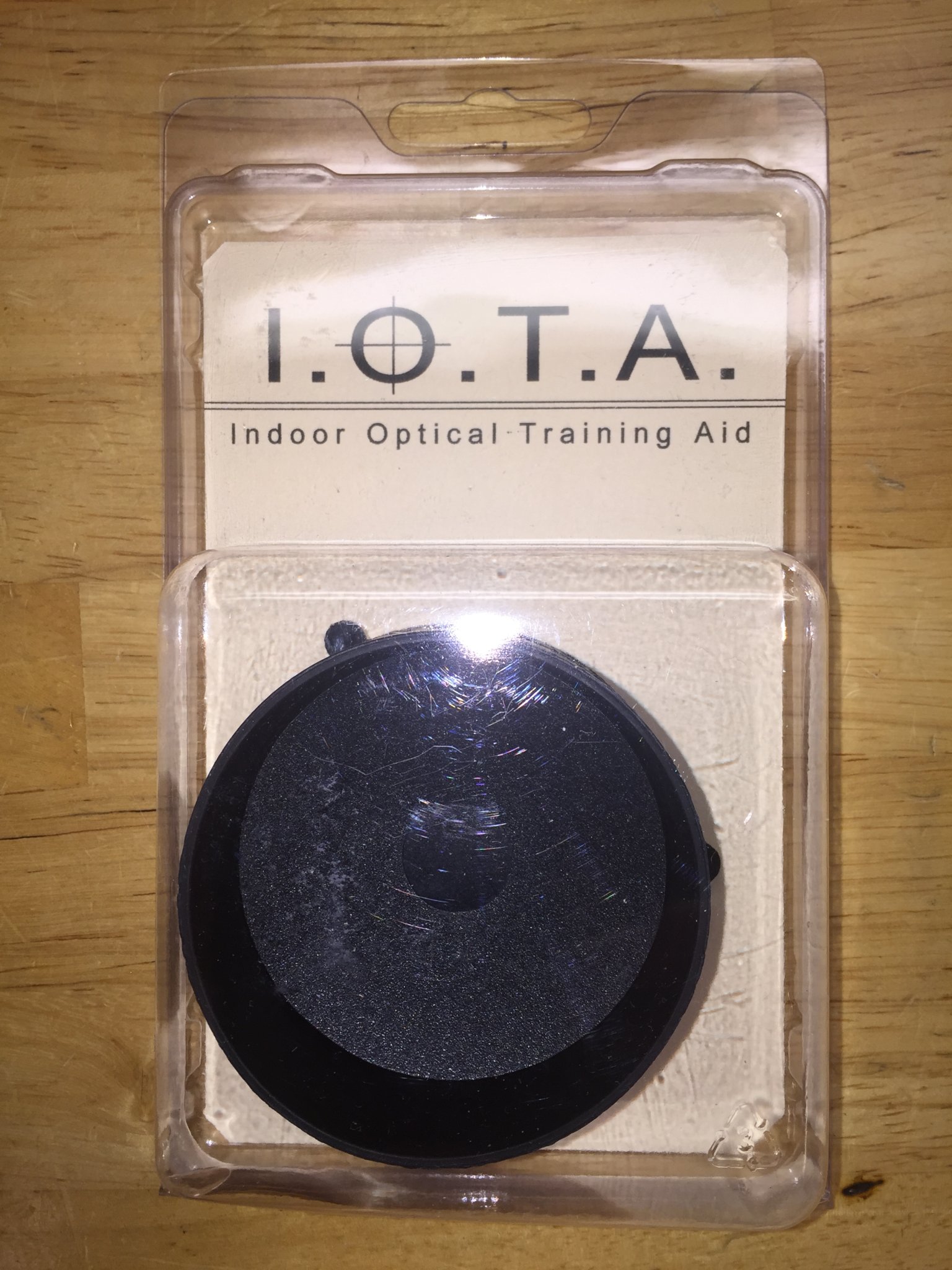

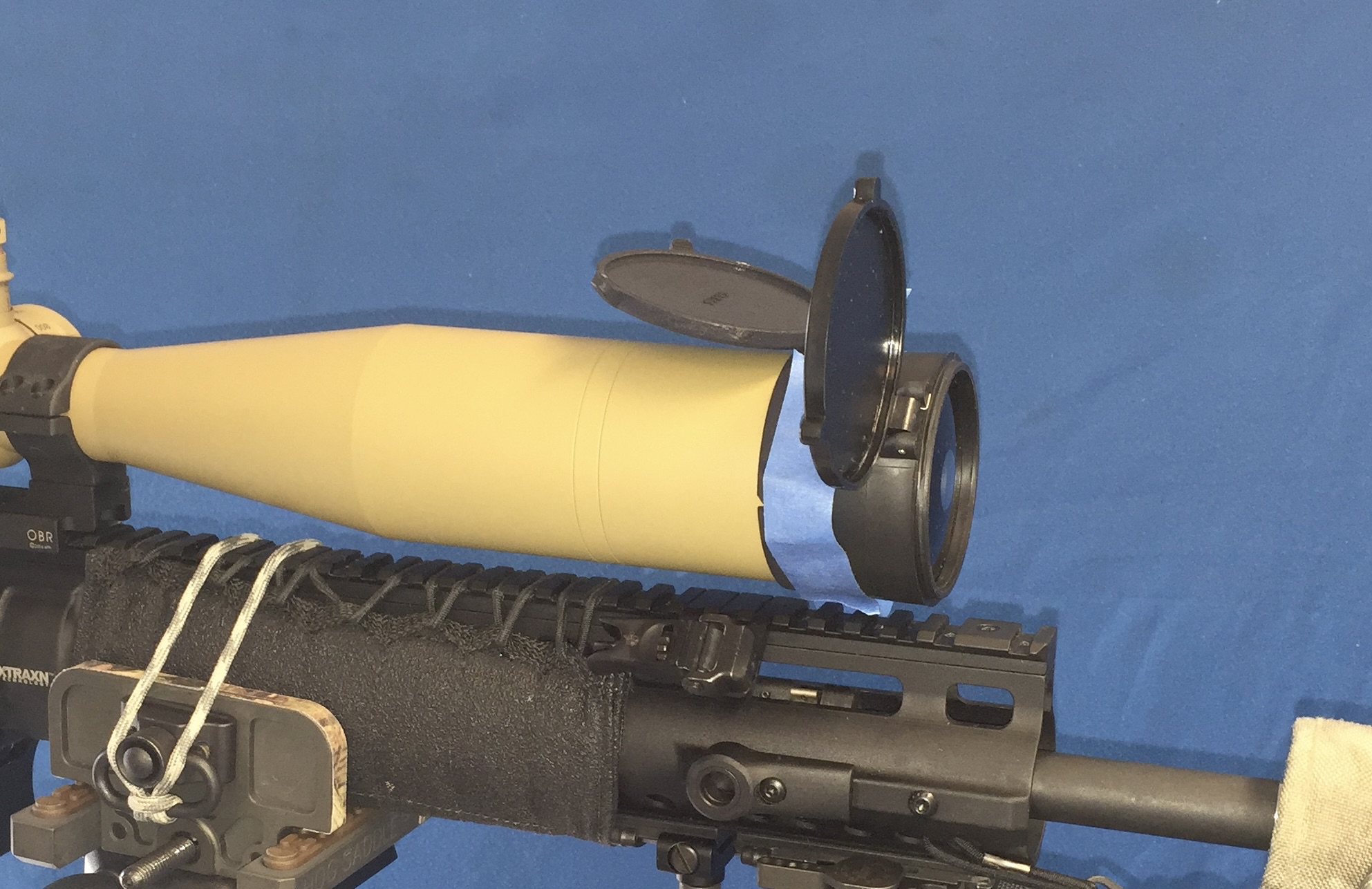

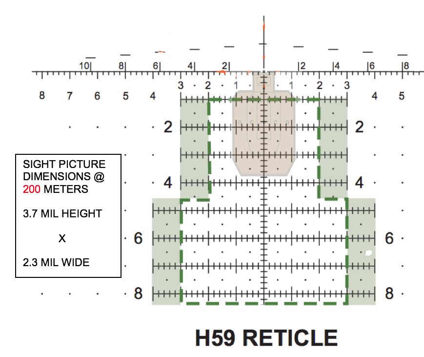

I use the I.O.T.A. system with a laptop computer. IDPA target sizes accurately scaled with H59 reticle over-lay on a Word document. Each target at various ranges is labeled which are then dropped and dragged on to separate document page that has a photo of my shooting range. I can then arrange the targets in any desired order on the range. The laptop screen is 11.6 feet from the front of the scope objective. Use the screen brightness to control what see thru the scope. It provides clear sharp targets to practice on.
I use blue painters tape to secure the adapter to the scope objective.
I use blue painters tape to secure the adapter to the scope objective.View attachment 8479279View attachment 8479280View attachment 8479281View attachment 8479282View attachment 8479283View attachment 8479285View attachment 8479286
