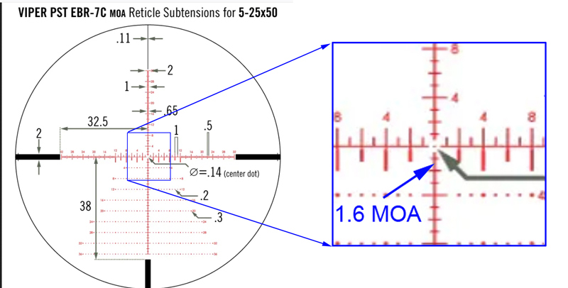

Pretty noob to LRS. (other similar threads, but pretty old)
Been getting better at 200yd on my AR with a bare bones reticle on a SFP scope. Looking to do more, and go farther.
Got a...
Brand new Ruger Precision Rifle in 6.5CM
Brand new Viper Vortex PST FFP; 5-25x50
All shooting prone with front and rear bags.
Looking to get a solid 100yd zero.
3 shots at 25 to make sure I'm on paper and large corrections. Good to go.
4 shots at 100yd and pretty sure its dialed in.
Mag set to about 8x
3 shots at 100yd and got a 3/4" group - centered in the red. (Scared myself at how accurate this set up is)
I'm determined to learn to use holdover effectively. Its the reason I got a scope with a real reticle for this.
Went out to 200yds.
Mag set to about 11x.
Pre-dope says up 1.6 MOA.
Tried to hold between 1st and 2nd MOA hash to validate the 1.6.
Managed a 5" group. I was hoping for better. (Ok, now as a realist, first time throwing lead downrage with this rig I might be dreaming)
Ok - now here's the question...
Does it make sense to even use holdover for a "small" distance change / short distance? I'm under no time constraint besides what I impose on myself. I've read other old threads here that recommend "holdover always" and I'm trying that, but looking for experince to get better at holdover tricks, or dial util I go out to 300+. Do you have a distance range that you dial for, and beyond that use hold over?
Thanks!

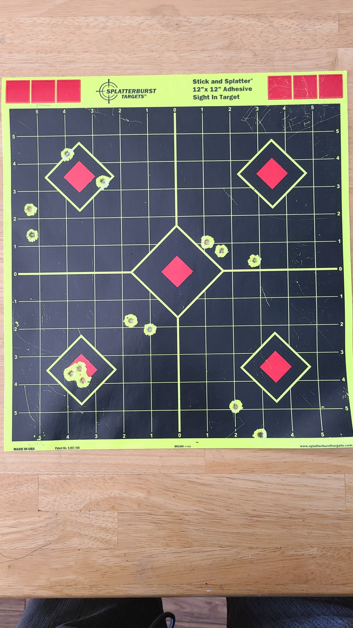

= 100 yds =
Top Left - 4 shots to complete 0
Bottom left - 3 shots for accuracy
= 200 yds =
Center - 5" group
Bottom Right - 2 more at 200 (not bad group for 2 shots, but not accurate)

My guess, if I dare...
Changed magnification and distance, but probably didn't adjust the parallax.
A "newbie" tried to use the blank spot between two subtensions (1.6-MOA) for his POA to attempt a precision group on a paper target at a longer distance. That's not easy to do. That's quite different than holding elevation on steel targets.
So, add that all up, and you get a nearly 2-1/2 MOA group at 200 yards.
My advice... dial your elevation and use the center of the reticle to aim. Focus on your fundamentals... sight picture, breathing, trigger control, recoil management, follow-through, etc. You'll shoot a much tighter group at 200 yards.
PS... I have almost the identical rig.... RPR 6.5-Creedmoor with a Vortex Viper HST (SFP) 6-24X50. It is capable of remarkable performance for a (relatively) economic rig. Did this at 300 yards.
