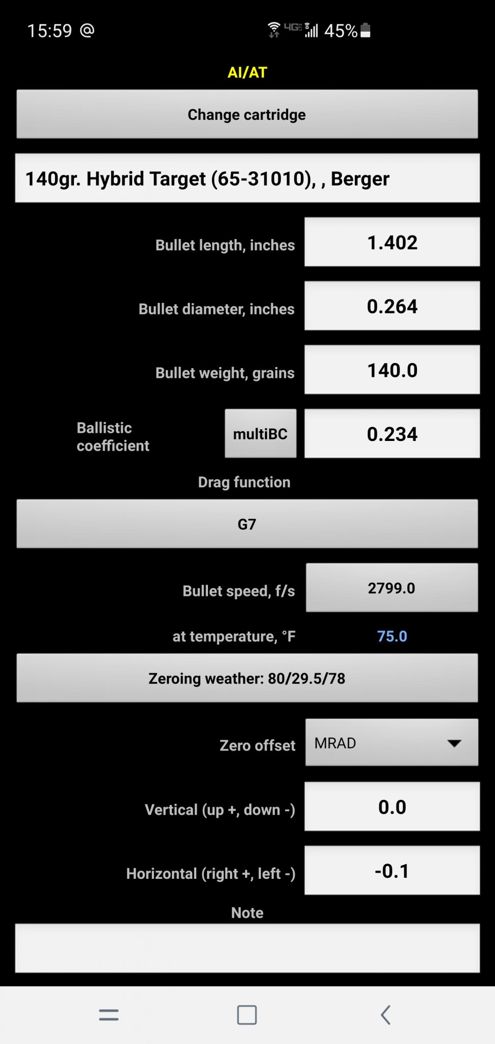

    The error can be mitigated. Use the offset feature in a ballistic calculator to refine it. It unless your scope is 1/8 MOA or .05 mil turrets it can only get so refined. Being within 1/3 MOA is pretty fuckin good
    Reactions: djarecke and 6.5SH
    I use Strelok Pro...do you know if that has similar functionality as what you are mentioning? If so...where in the app do I note that my POI is 0.1mil left of POA?
    I'm thinking this is it below...
    Also, many people zero .1 left on purpose. Helps with SD. Pretty sure that’s a common practice for @lowlight

    I just happened to finally have time to document and post about something I have observed (on my rifles and others) a few times in the past. There has been some helpful advice here that I am going to take with me back to the range, also some entertainment value.
    I wasn't aware of the functionality in Strelok Pro to input a zero offset. I will try that. And, I will also look at remounting the scope.
    It isn't the end of the world for my shooting (maybe I should care more). Yes, 0.1mil off at 100m is nothing, but at 800m it is ~3inches (?). So long as I am made aware now of the dynamic I can compensate with my dials and holds.
    At the end of the day, 2 shots one hole, then 2 shots one hole 0.1 click away shows my turrets track (at least at 100), so that's the silver lining here. :)
