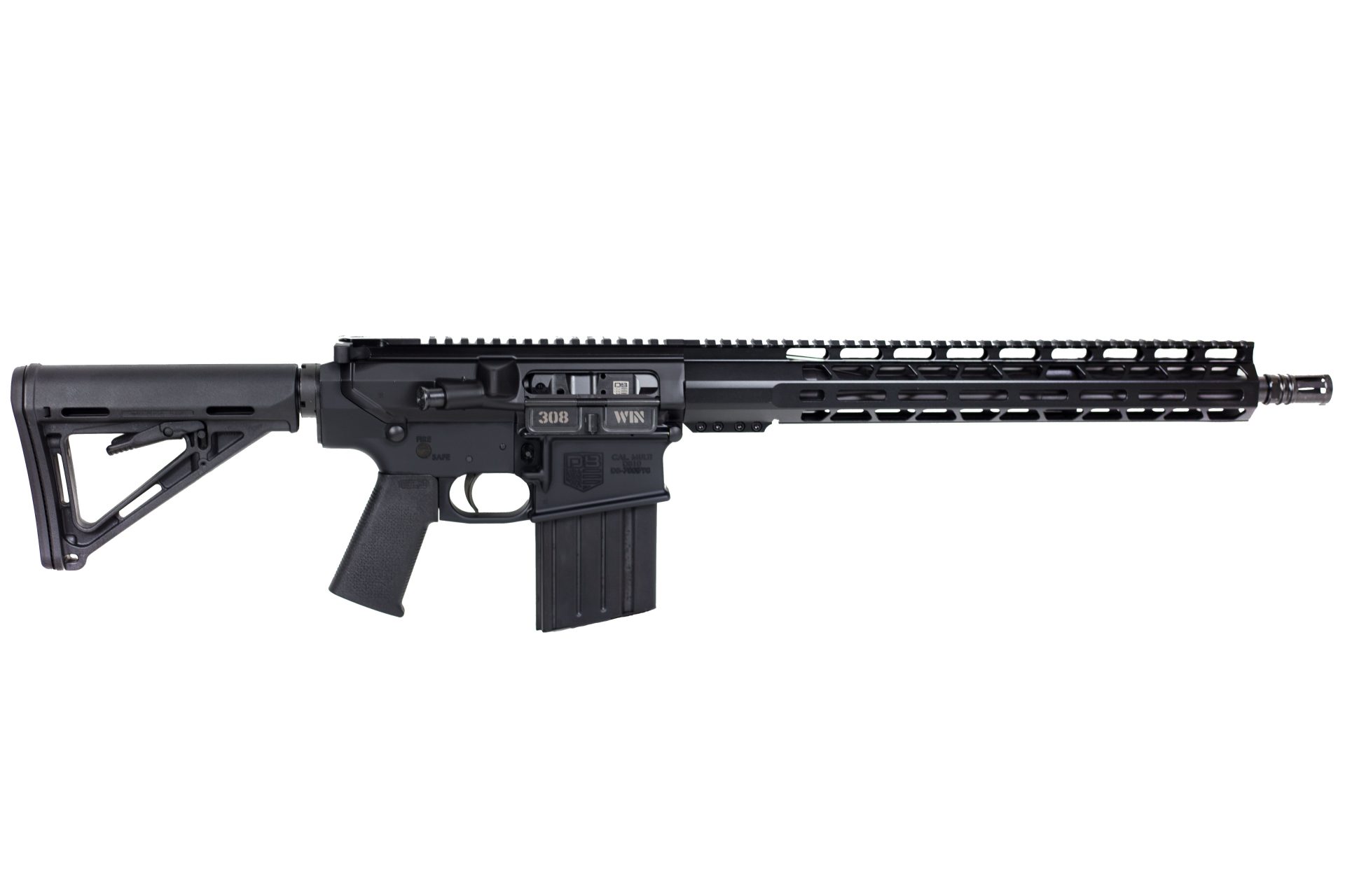

What's the general view on their budget line of rifles? The carbon series.
For now I'm hitting a dry hole finding an AR rifle in 308W in Europe, however, this model DB10CCMLMB is part of the DB carbon series (budget line)).
How do you rate the carbon series in regards to design and durability? Are the hand guards on the DB10 carbon series stiff and rigid? I'm looking at mounting a bipod, so I want to make sure I don't get a hand guard with wobbly tendencies.
Looks and finish can always be improved by ceracoating and after market products.
What I'm trying to say: Is the carbon series worth your money or better spend elsewhere?

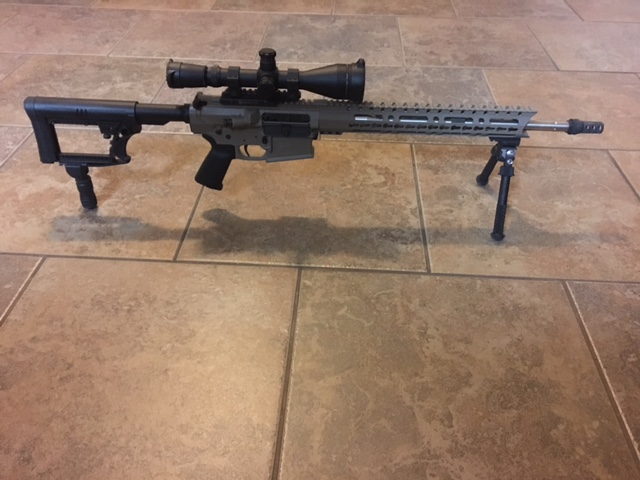

I used to sell them as my value brand. They always sold well. After 3 customers said they were getting sub MOA accuracy I bought one. It shoots sub MOA all day long with Federal Match 175g Ammo or my hand loads. I did need to increase the buffer weight for suppressed. Also add a different stock (Luth AR), Geissele trigger, Bipod, monopod and scope. I have another upper with night vision for hog hunting. It is the 16” barrel (not the 18” stainless) it isn’t as accurate as the 18” shown.
