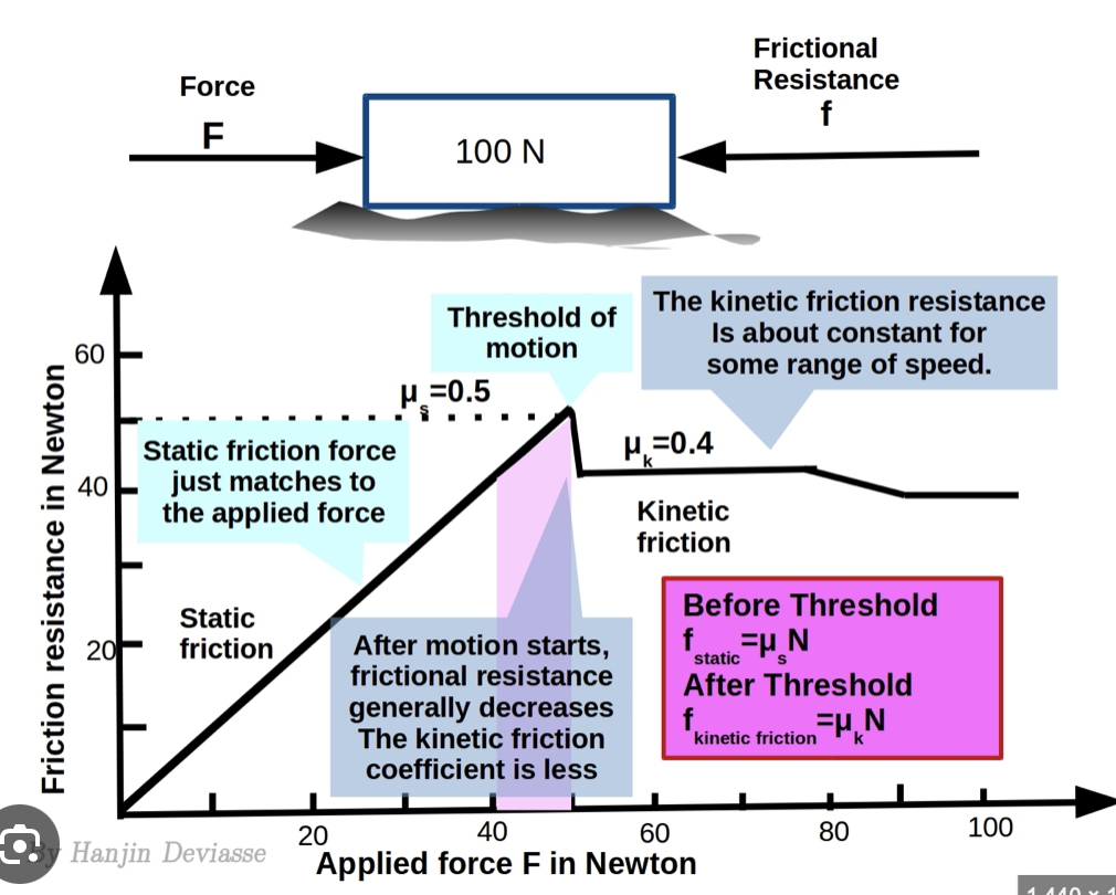

Here is where I was coming from on the friction thing and somewhat dismissing the pressure thing when it comes to bullet weight...
Disclaimer: I will try to explain where my opinions originated from and I will do an extra sucky job of writing this...
I regularly find out a lot of things I took as fact in the past were wrong or have changed considerably. I'm all ears and definitely don't want to pass on bad info to other, newer rifle peeps.
Friction?

With this in mind, the conclusion was that the friction from jacketed projos had a very minimal impact on barrel bore wear. Of course the pistol ammo had miniscule pressures and heat compared to modern rifle ammo so that took more of the heat and pressure variables out of the wear equation leaving only jacket to bore friction as a potential major player. Again, seemingly little or no wear from friction.

Question for those advocating that friction between the bullet jacket and bore has a major effect on barrel wear:
100% of shot out barrels have the most damage immediately in front of the chamber. The lead and throat have the most severe damage and that damage decreases with distance away from the chamber. Even the most severely shot out barrels have almost pristine bore condition for roughly 2/3 to 1/2 the length as measured from the muzzle back. This pattern exists in barrels that were shot out with 100% heavy bullets (competition shooters) as well as those shot out with 100% light bullets (coyote and PD hunters).
This is exactly why many discuss and elect to "set a barrel back". I am not a fan of that approach at all but it does acknowledge that the only damage is immediately in front of the chamber.
If jacket friction was a major contributor to barrel wear, why does that wear hardly exist as you approach the muzzle?
Wouldn't heat from friction increase as the speed differential of the two surfaces increase? Wouldn't heat from friction be greater toward the muzzle compared to close to the chamber?
Thoughts to the contrary?
I don't know enough to opine on the subject of barrel death. However, static friction is different than kinetic friction. And, an object experiences less friction in motion than it does when static. Just a thought that I don't think is counter to any of the real world observations...
Reactions: Terry Cross
I tend to agree Terry, the example I would put out is the 6 Creedmoor which is a known barrel burner. That said it is also known that barrel life decreases almost exponentially as velocity increases. But when the barrels are examined the throat area is where the most damage is seen. The lands are not torn up or worn. If the bearing surface has that great of an impact I would expect the lands to be worn and rounded.
