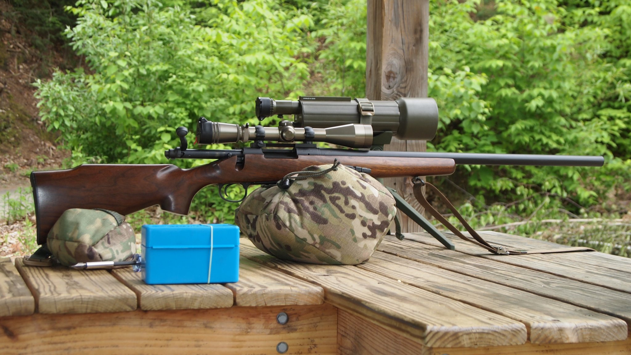

Its not an expensive scope by any means, just a standard Redifield 1 inch tube meant to replicate a scope the USMC used in Vietnam....
As you see it mounted in this picture the magnification adjustment ring works fine. When I first mounted it I had the scope forward maybe so the ring was .25 inch or less from the zoom ring and the scope was binding up. That was at 12-14 inch pounds using a Seekonk torsion beam.
