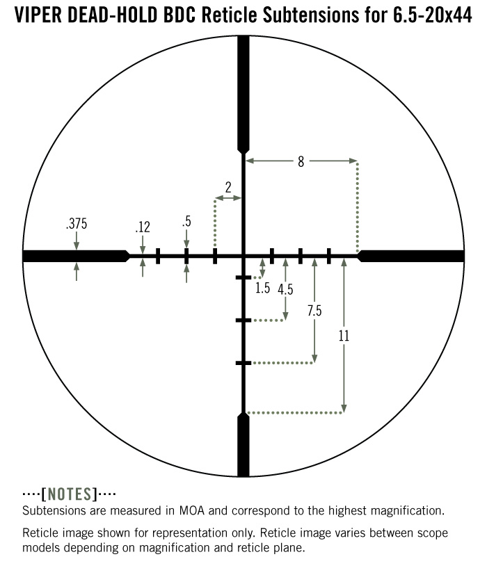

I think you will be fine with the BDC reticle, I use one exclusively on my groundhog AR. I shot a known distance match and was able to compensate for wind as there are hash marks for holdover and windage. I was also able to figure out my windage miss by using the reticle. Just remember the hash marks are a set value for a certain magnification, usually the max .
To combat that i have "cheat sheets" with the reticle values at full and half magnification.
If you use strelok on your phone you can bring up a picture with the reticle and get approx yardage for each holdover hash.
Here is the reticle breakdown
http://www.vortexoptics.com/uploads/sub_vpr_s_65-20x44_bdc_moa.jpg
I have had good luck ranging a groundhog at little over 300yds and making a first round hit.
