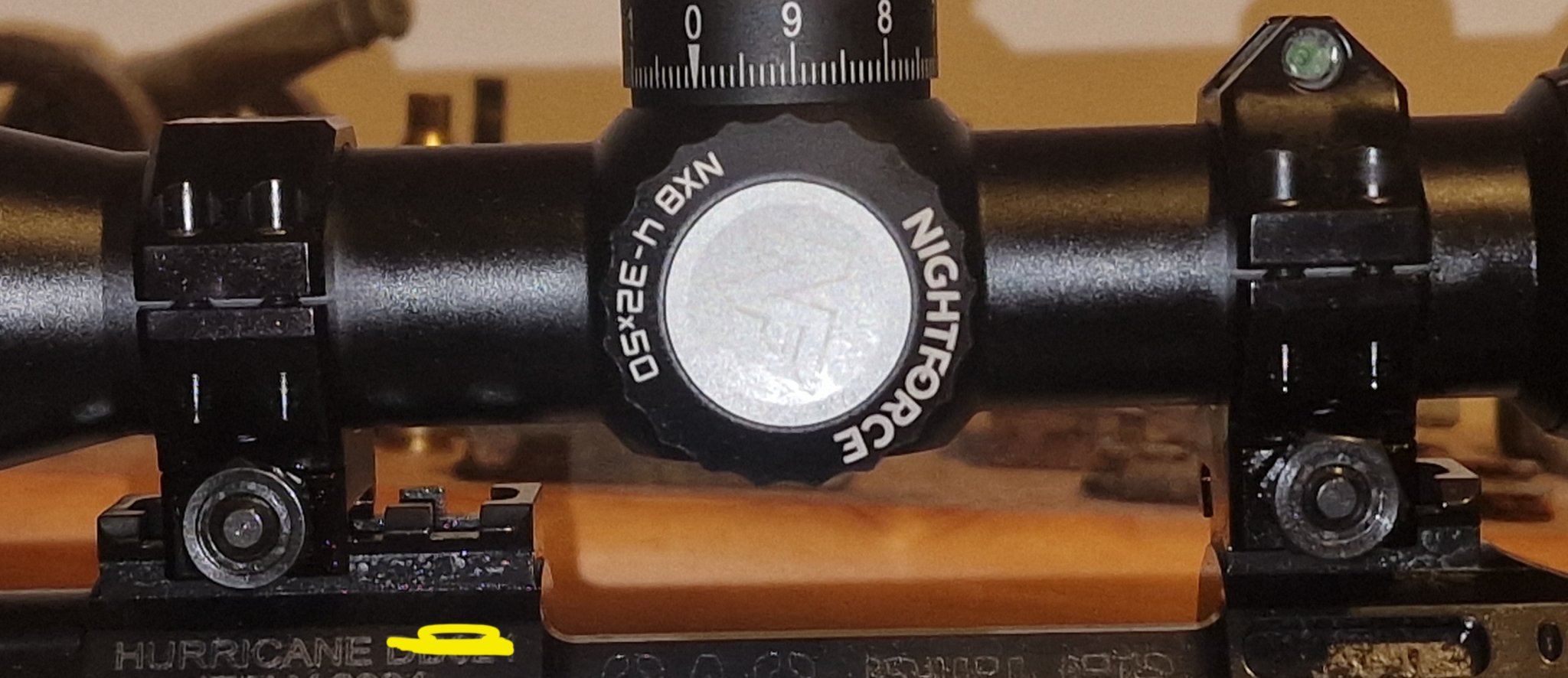

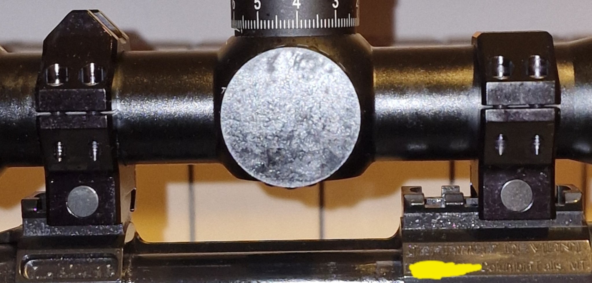

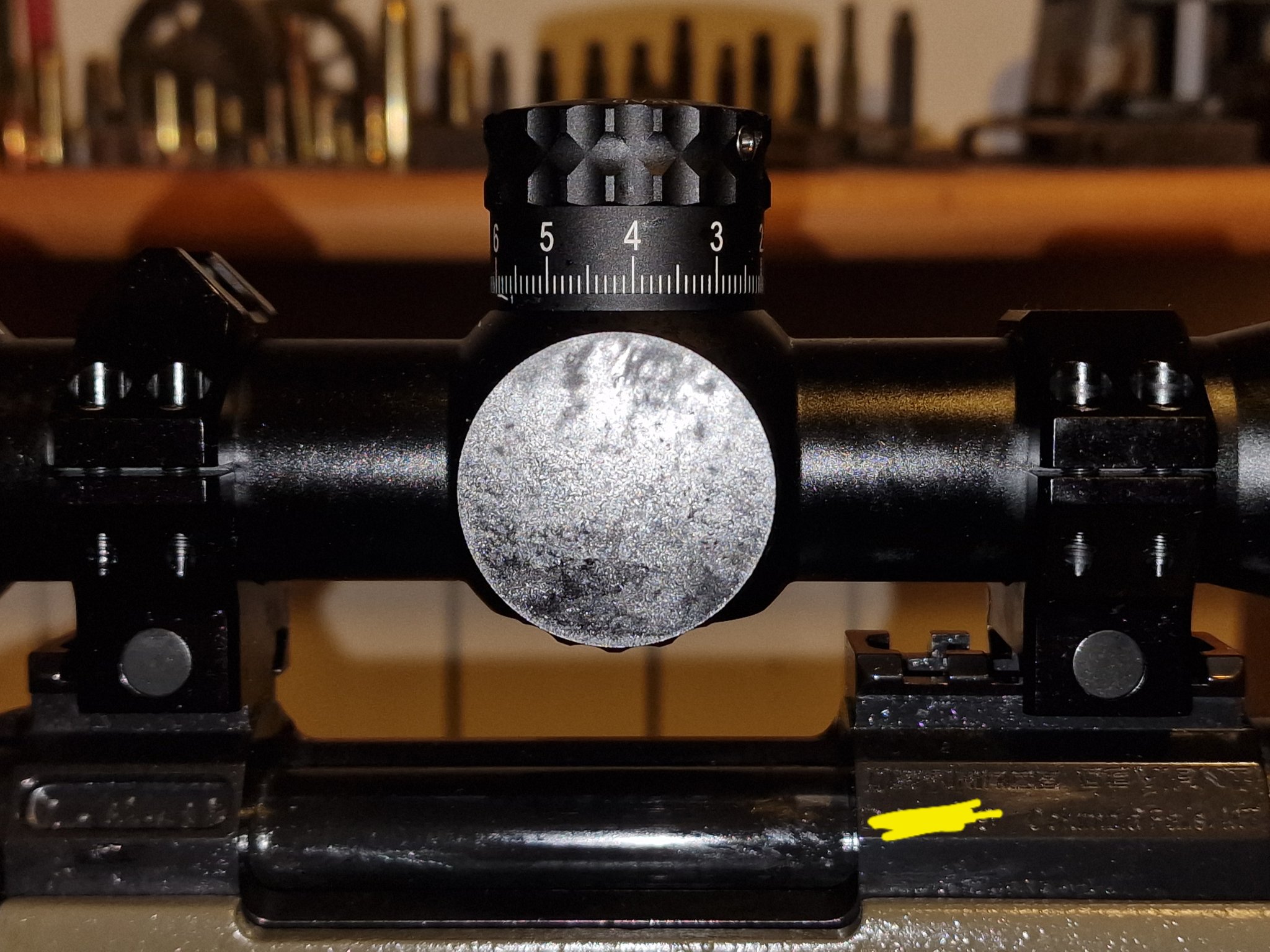

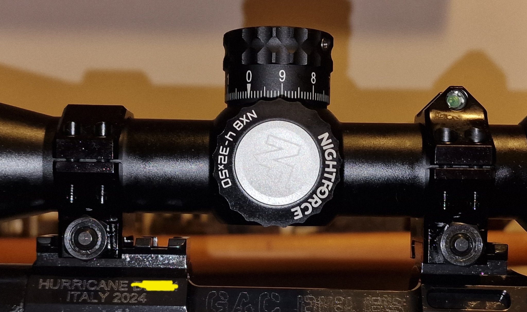

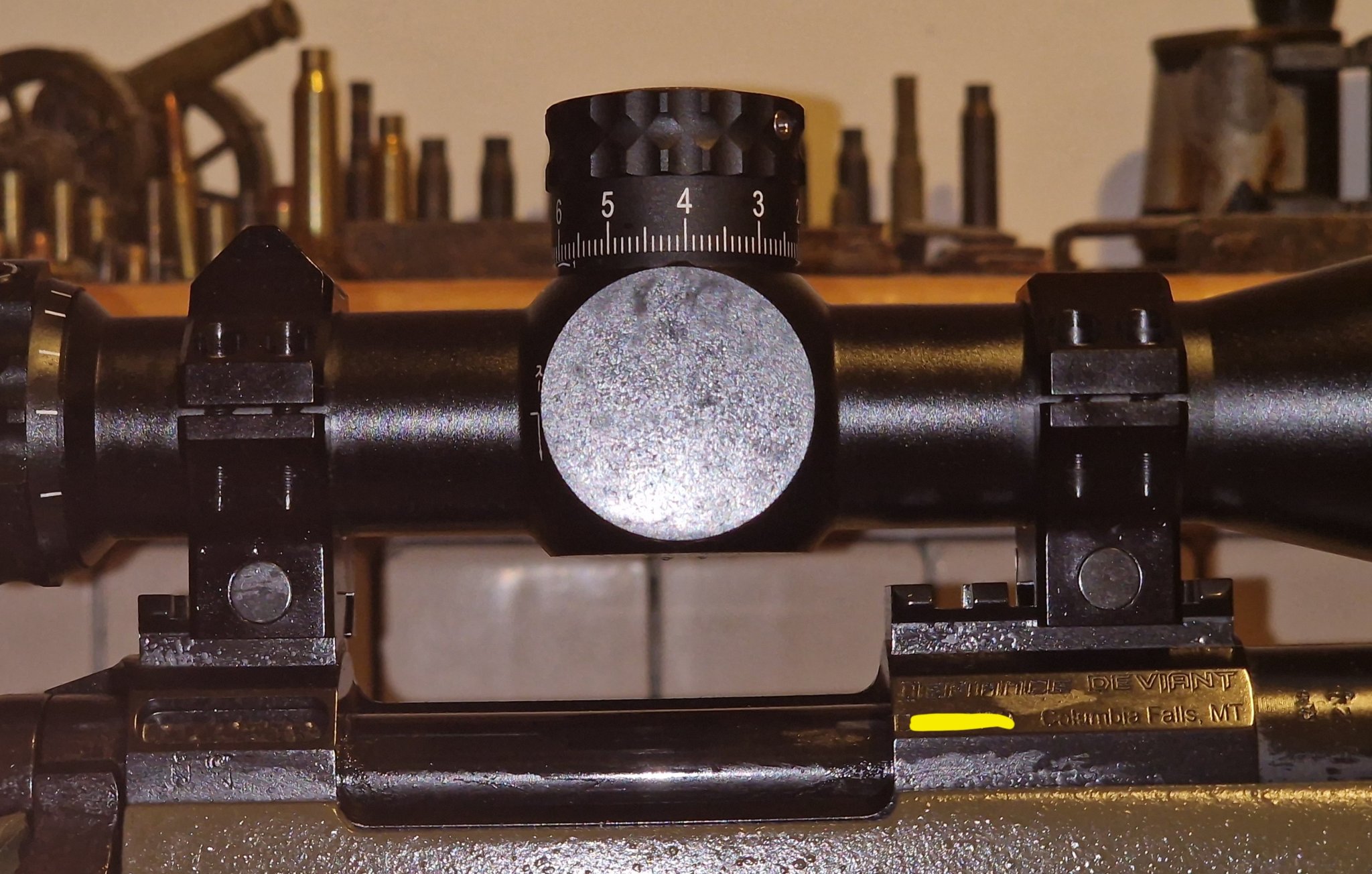

Hi, i am probably massively overthinking this but, since this is a pretty expensive rig, i want to set it up in the best way. I mounted the scope following a strict procedure (the crosshair is level to gravity and to the top ring bubble, everything is torqued down to specs). It was a long process and i wish i won't have to do it again.
Using the typical criss cross pattern method i torqued every top ring screw to 25 in/lbs with these hawkins light tactical 30 mm rings.
At the end of the process i was very satisfied because the system crosshair-bubble is perfectly leveled to gravity. I noticed that the gap between the front and rear rings is not perfectly even. I read somewhere that someone is even using feeler gauges to check fo uniformity in the gaps. Since of course having the exact identical gap is impossible, i want to understand if in my case the gap differences are acceptable or not.
I measured with a feeler gauge: rear left 0.9 mm (0.035 inches) gap, rear right 0.9 mm gap, front left 0.80 mm (0.031 inches) gap, front right 0.85 mm gap. So basically there is a max 0.1 mm (1/256 inches) difference between the rear and the front rings, while there is a max 0.05 mm (1/512 inches) difference between left and right.
i will post some pics. The gap is not easily visible in these pics i think but when looking in person i notice it.
what do you guys think?

Looks fine but if your OCD is bothering you then adjust one ring and then go adjust the other. That way the one holds the scope in place and level while you adjust the gap and then do the other. Simple. But if you left it as is then you will be fine too.
Now that the scope is correctly mounted, another suggestion is to put witness marks on scope and one ring so, when you inevitably have to remove the scope, putting it back is vastly easier.
So you think it is mounted correctly despite the uneven gaps?
Yes. If it was me, I'd leave it alone and go shoot.
If you can't leave it alone (aka OCD) - as Rob said, you can fiddle with the rings one at a time, or you can do the witness mark thing and just start again. Or do something in between.
Or leave it alone and go shoot. The gaps are fine.

I try to even gaps out, but it depends on the rings. Badgers have huge gaps for instance, but others have smaller gaps. If I feel like the light’s playing tricks on me I’ll get the feeler gages out, but I only do one ring at a time to keep the scope level. You can go nuts doing this stuff; as long as it’s close and the torque values are correct and applied in the proper sequence there shouldn’t be an issue.

Notice that not one person has given you an example of what could happen if that gap isn’t equalized? That’s because there is likely no one who has tested this to see if there’s a problem.
In my case, I’m a jeweler and gun Engraver who works to exacting tolerance. So equalized gaps are just part of my procedure. But I seriously doubt that if they were not dead requiem that I worked see any difference on target.

You’re worried about a gap difference of 4 thou(.004)? That’s around the same thickness of a human hair…
I know it's not much, i was hoping more people confirmed me that this is not even considered an uneven gap. That said, most people told it is fine, I am not even sure is it doable to do so much better than this without really spending hours or going crazy. With the top level that has to be spot on, it's not that easy to even the freakin gaps out

If you have it level the way you want and torqued properly (and you say you have), then I wouldn't even consider messing with it further. Go shoot and be happy.

I typically hand tighten all screws evenly, as in, just the torx bit in 2 fingers, just until the bolt seats. I will futz with things until equal, as measured by feelers. Once I know the gap, I remove the hardware, apply small amount of loctite 243 (check expiration date first!) to bolt (making sure to get a smudge on the underside of the bolt cap also, as that's a interface that will gall) and bolt hole of mount, and then throw the ring cap back on there and quickly (you have about 3-5 minutes from when you cut loctite off from air. Nearly unlimited time before) hand torque it down. I will then "clamp" the correct thickness feeler on 1 side while doing so, to ensure the pre-established equal gap is there. Then, once all bolts are fingertip/torx bit seated, I remove the feeler, and torque by 1/8 turn on each bolt, correct crisscross pattern, until the specified torque (15 in lb for my Reptilia mount) is reached. I do this by "chicken winging" my arm forward so my elbow is at 90 from my side. I then close my "wing" until my triceps hits my lat. This is about 1/8 of a bolt turn. This and using quality mounts has prevented optics turning in the rings 100%. I will remove my phone from the case and true it to my Badger Dead Level, and then to the uncapped turret on my nightforce. I've never had to unclamp or adjust a ring due to turning of scope as I tighten. Annoyingly, even when ring gaps are almost perfectly equal, my Acro P2 has about 0.2* axial rotation as measured against the top of the acro's turret vs the Badger DL. It just can't be 100% perfect I guess. Somehow I doubt it matters.
