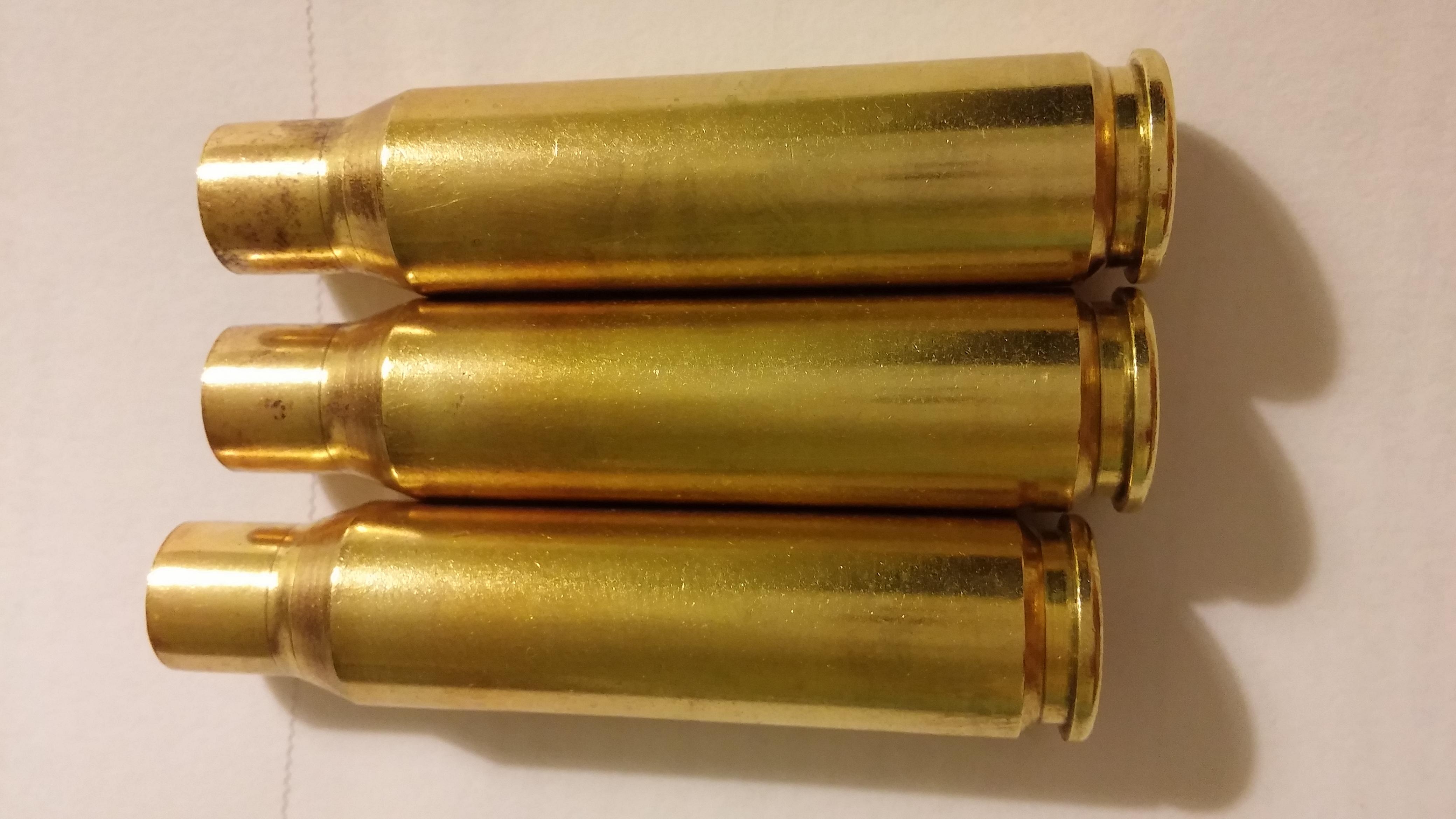

I just set up my new Bench Source annealer and had a hell of a time trying to determine if I had correctly set the dwell time and height of the torches. I am annealing my Lapua 308 brass which has 7 prior firings and has never been annealed before. When I ordered the Bench Source, it was recommended to me that since my brass had not been annealed in so many firings, I should run the brass through twice. I used Tempilaq 650 on the neck/shoulder and 400 on the body. I had a hard time reading the Tempilaq 650 since it wanted to turn black instead of clear. I finally decided on 3.8 seconds where the Tempilaq 650 turned clear around the shoulder and the Tempilaq 400 did not turn clear on the body. The case necks never turned red or glowed at all (I turned off lights). I ran the brass through twice, per the recommendation of Bench Source.
Now, heres the issue. I tried sizing the brass on the FL type-s die (334 bushing) like I always do (I neck turn). Usually, with the same brass prior to annealing (fired 7 times), my sized neck diameter was 0.3325-333. However, after annealing, this same brass is sizing to a neck diameter of 0.330-0.3305. What gives? Why is it sizing much smaller than before annealing? Did I over anneal and now the brass is too soft??

What does your brass look like after annealing? See any grayish/bluish color just below the shoulders? Can you post a pic of some pieces?
Looks pretty much like the brass did prior to annealing. See picture.

I'm thinking you under-annealed the cases...no dark, cherry-red glow, 3.8 seconds under the flame, and the absence of the bluish/gray coloring just below shoulder are indicators that they just did not get hot enough.

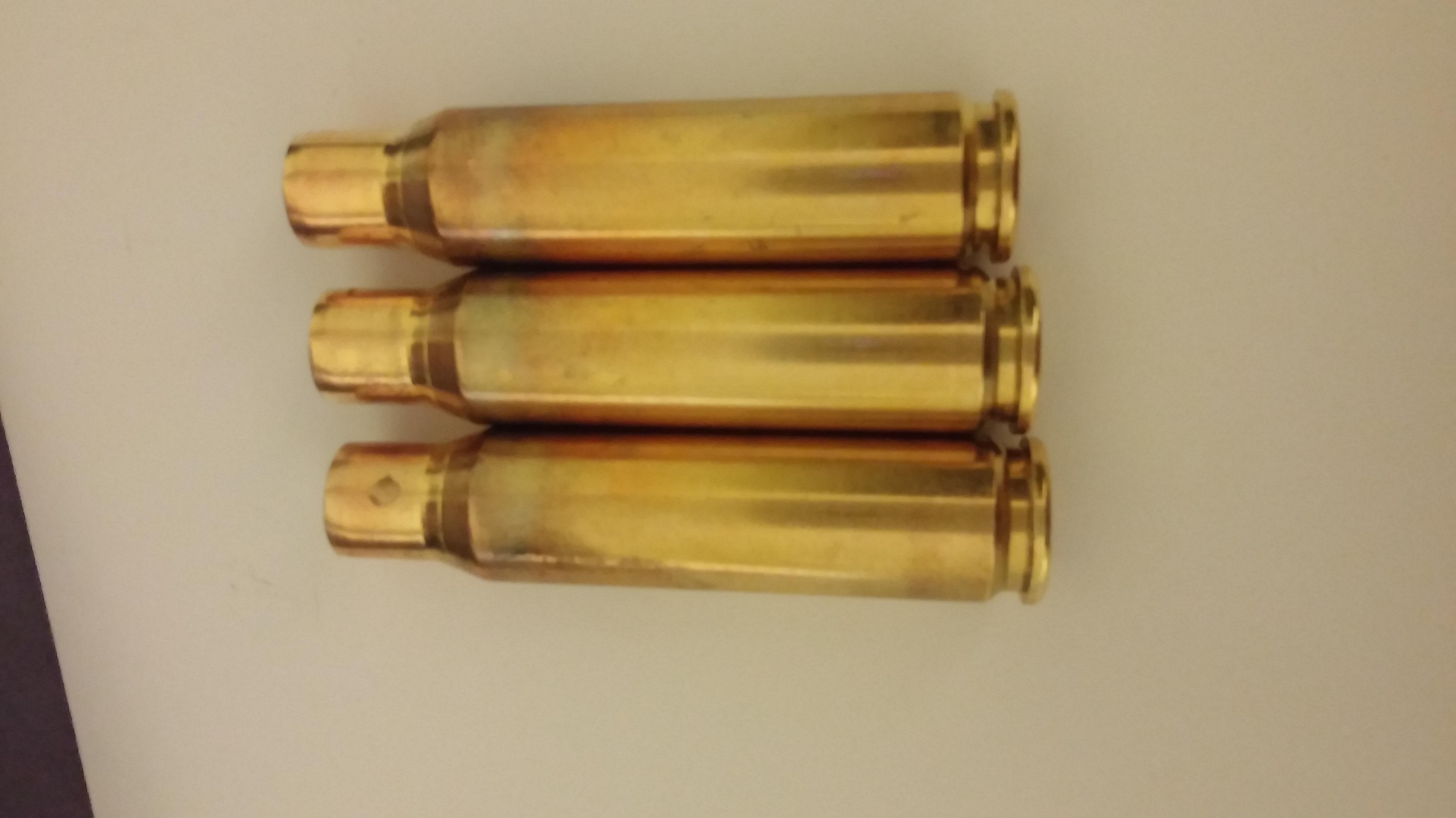

So, I repeated the test with spare brass. I left the height of the torches and torch intensity the same. Currently, I annealed at 3.8 secs and the case neck remains dark (with lights turned off) as it leaves spindle. At 4.5 secs, I see a very slight dark red glow just as it leaves the spindle. The Tempilaq 400 stripe 1" from case head does not melt. At 5 secs, the case neck has turned a slightly lighter shade of red just as it leaves the spindle. The Tempilaq 400 begins to slightly melt at the 1" mark on the case. At 6 secs, the case neck glows cherry red and the Tempilaq 400 melts to about 0.5" from the case head. Interestingly, even at 6 secs, there is no blue/gray ring below the shoulder. The neck does begin to darken at the 4.5 sec mark, though.
Sounds like 5 seconds is good.

Here is your answer to both the annealing question and the sizing. Like Timelinex says, you want to adjust things to cycle the brass out of the flame just prior to that change in flame color. Your necks shouldn't be glowing cherry red or any BS like that, but you also need to get the brass hot enough to accomplish the task.
So, I did some more testing at a slightly longer dwell time (4.5 secs). At that speed, the flame turns to yellow about 0.5-0.75 sec before it moves off the spindle. The case mouth glows a slight dark red just as it leaves the flame. See the attached picture of case. It shows a slight gray mark just under shoulder. I've given up on the Tempilaq 650. It seems to turn black and never get clear, regardless of whether I put it outside or inside.
