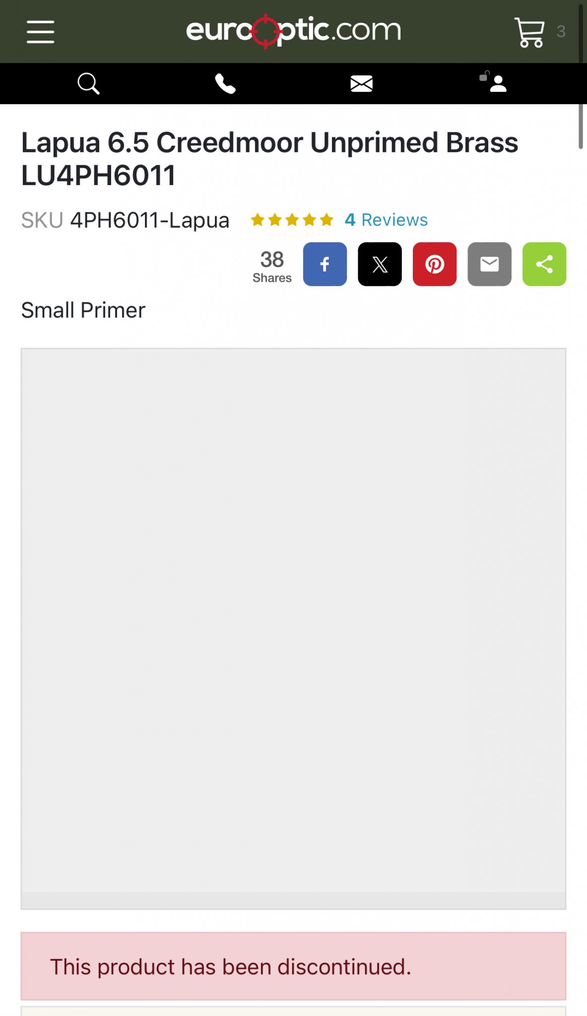

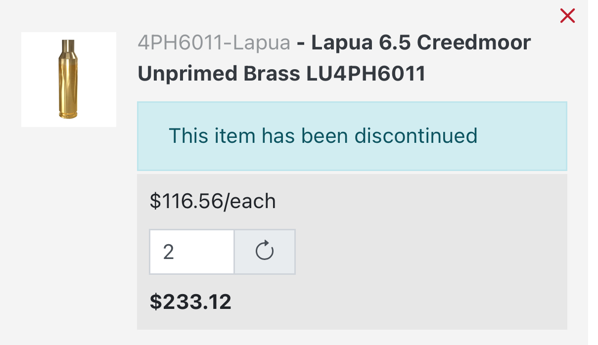

    Just had something weird happen today. I just bought my first 6.5CM, and I ordered 200 pieces of Lapua small primer brass from EuroOptics yesterday to start reloading, and I got an email from Euro today stating that this brass has been discontinued…..
    My brass is on the way, but I called Euro and they don’t have any idea why Lapua discontinued it….
    I hate that I spent 233 dollars on brass that’s obsolete….anyone here have any leads on what’s going on with Lapua?
    Thanks!

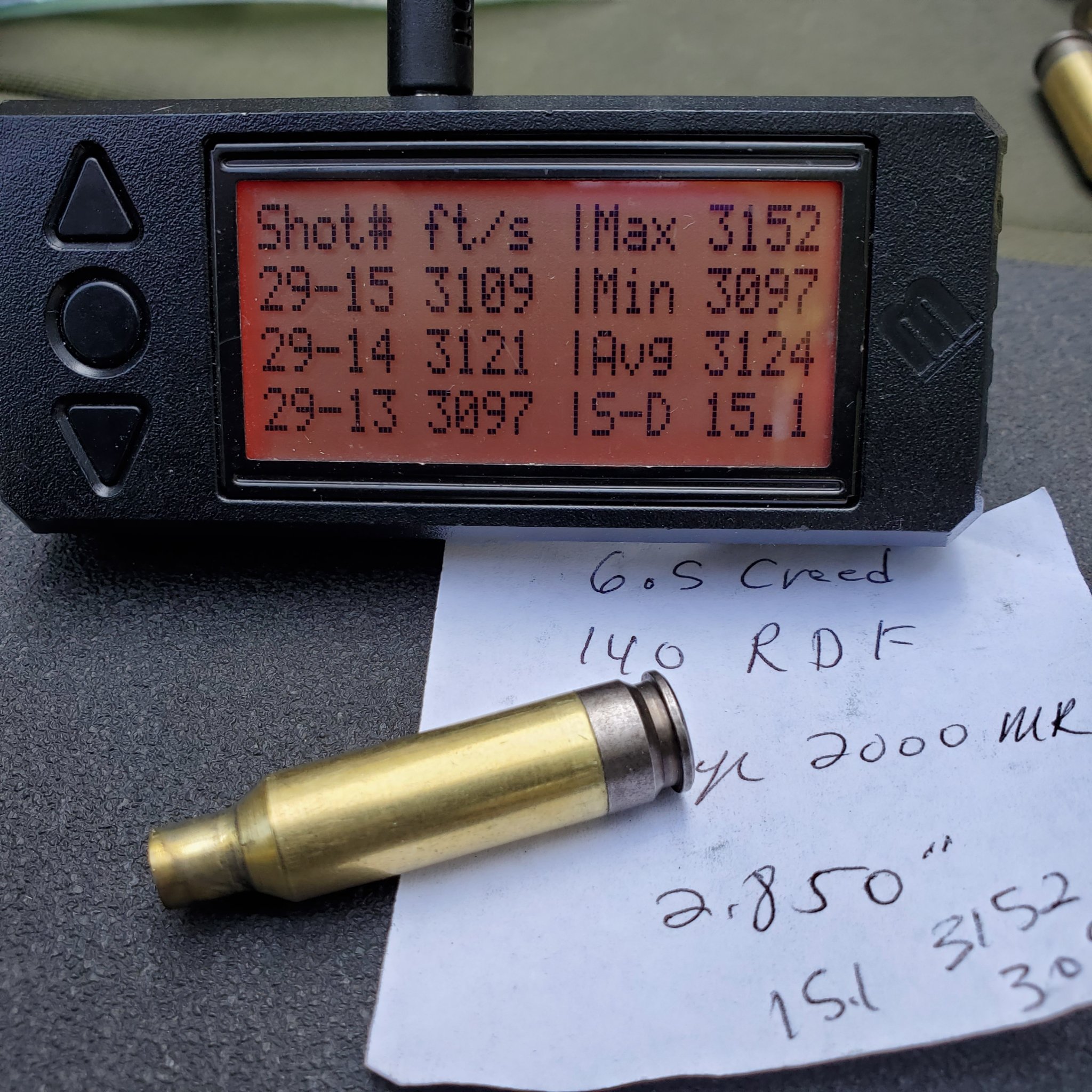

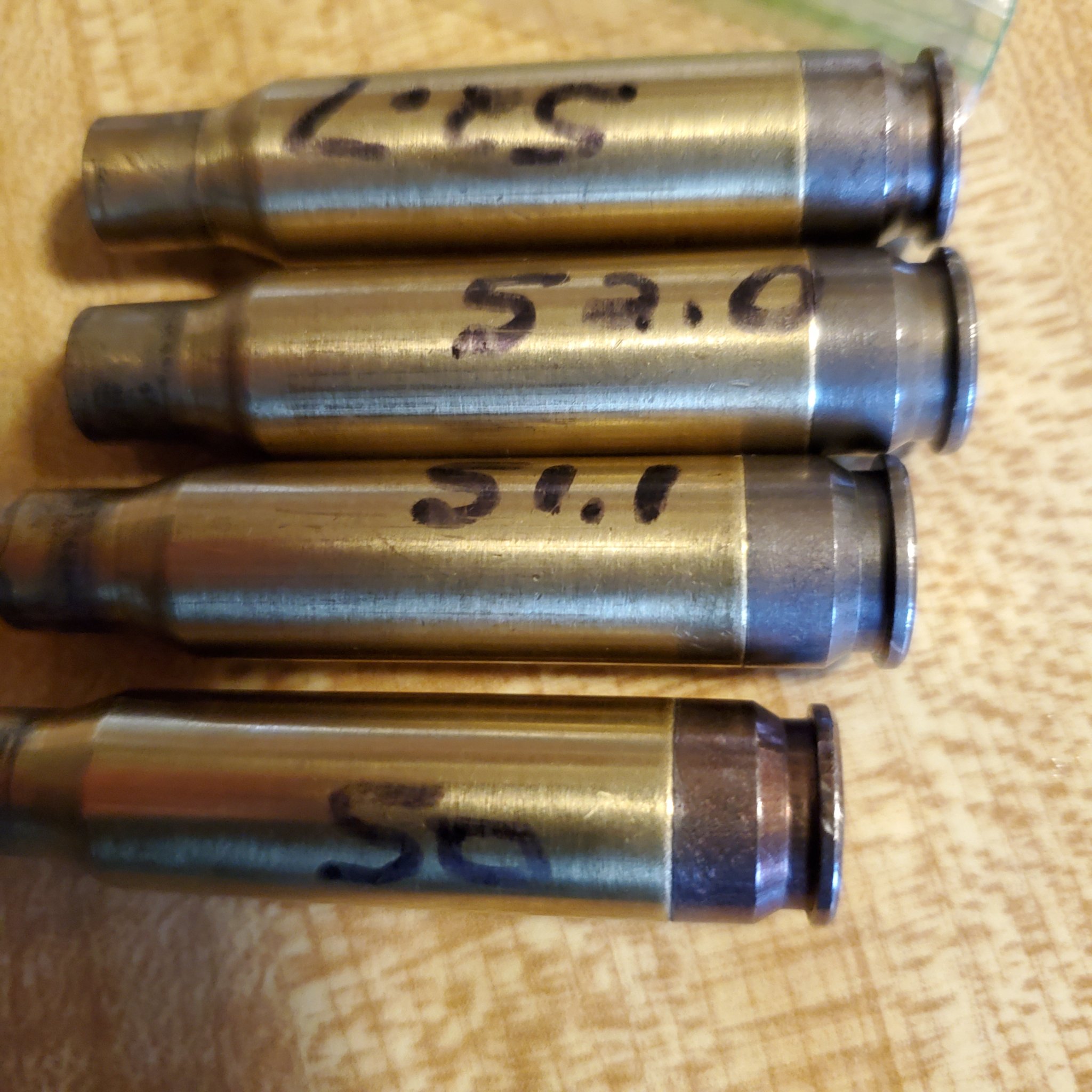

    Here is a picture of hybrid cases.
    And a ladder test running 140 gr to 3152 with this test powder. They are 6.8 X 51 military cases that run at high pressure, and reformed to civilian cartridges like 358, 308, 6.5 CM, 8.6 blackout for more performance.
    The best powder for the 6.5 CM hybrid case was RL 26 and 150 gr SMK at 3000 fps, accurate and fast.
    Step down to the 140 for 3150 fps...but ya don't have to run them here...they give extra protection for the normal handloader pushing the limit, with normal brass cases hitting the next accuracy node.
    It's just a newer military development, available to the public, for those interested.
