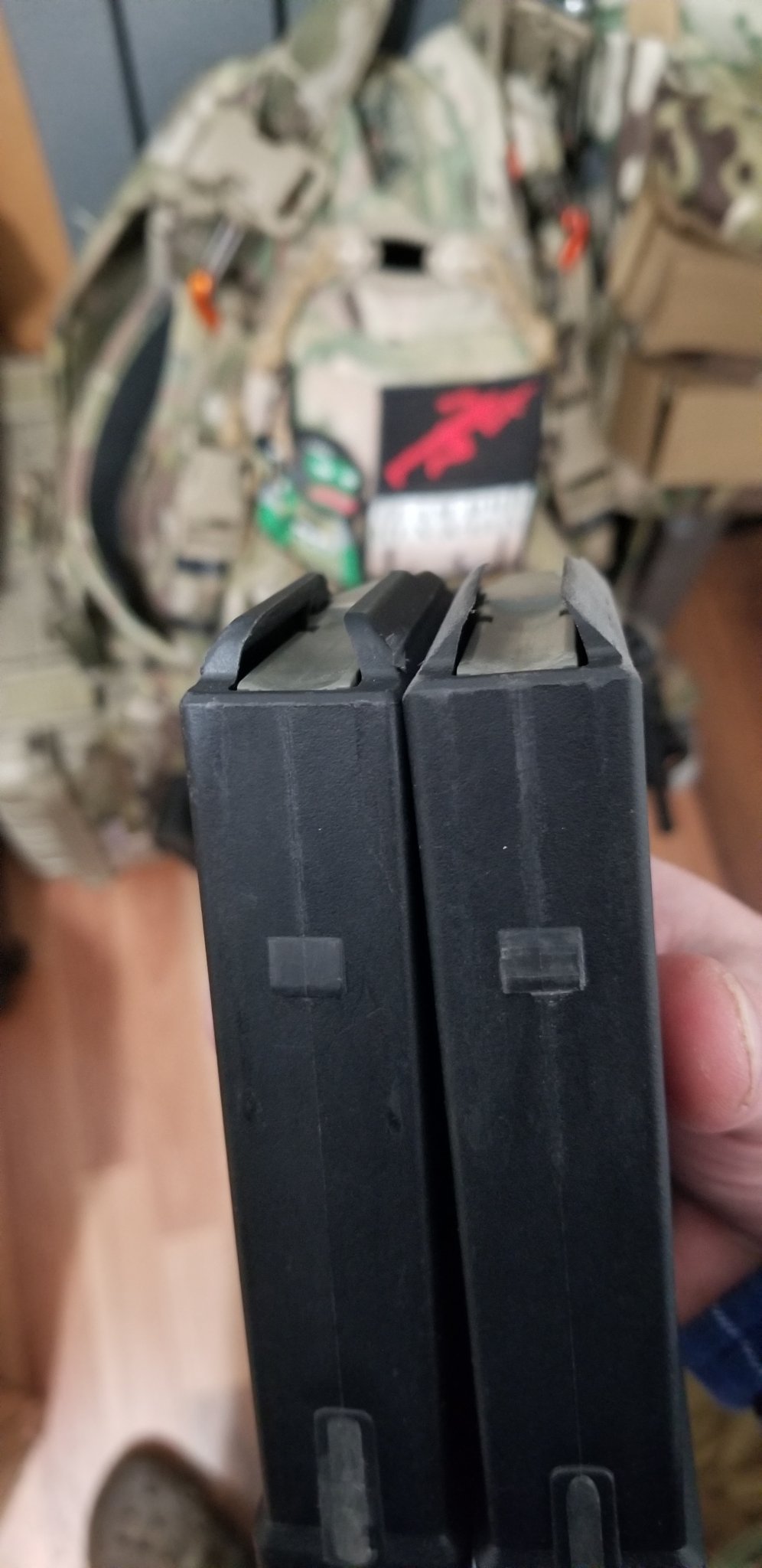

Picture from here (not mine).
As an aside, after reading all these similar frustrations over the last 15 years …. Why on earth do people persist with trying to make LA tikkas work with anything but factory stocks and mags. Such a waste of effort.
