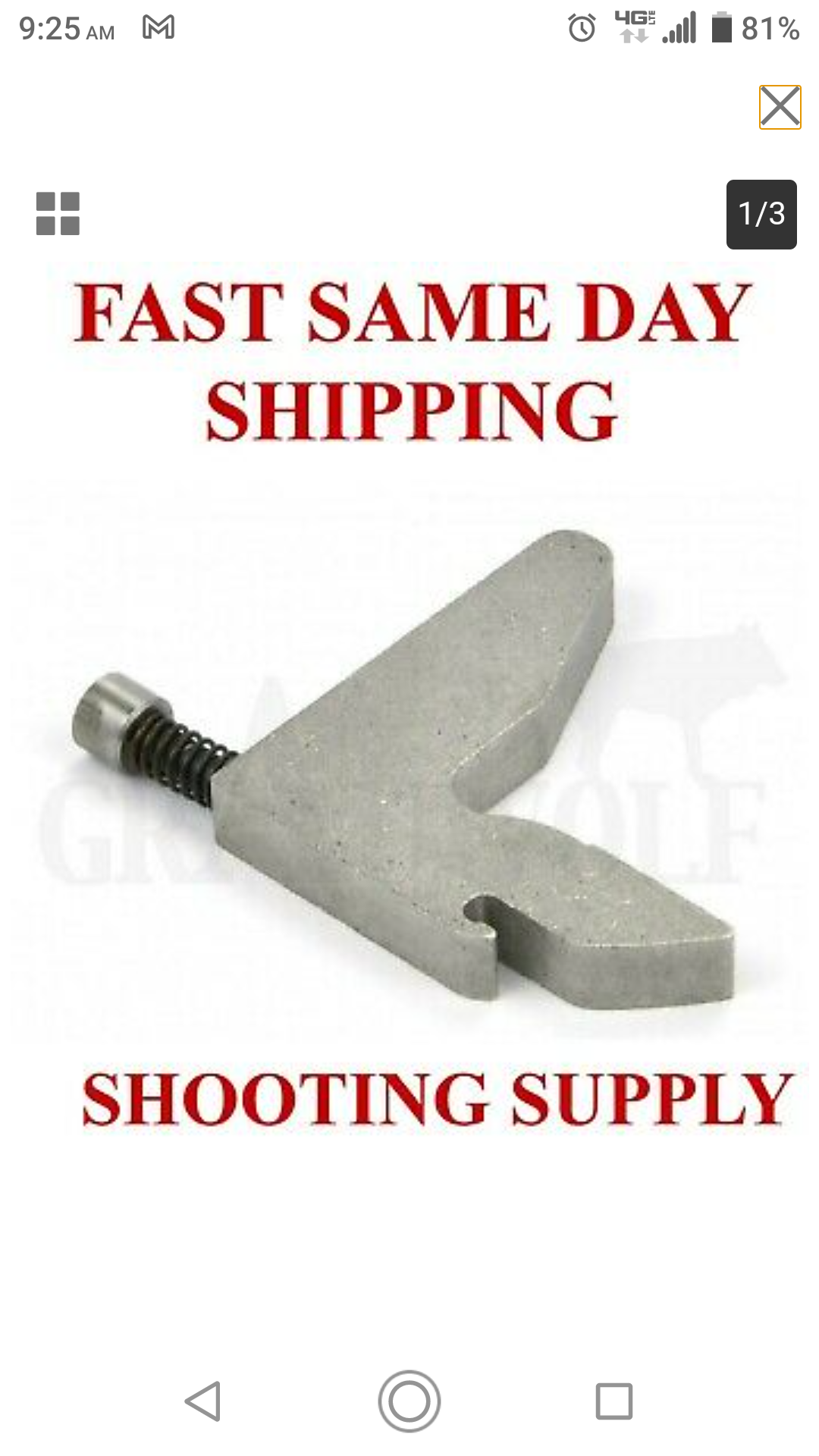

    Looks like K&M has a similar concept patent dating back to 1989. Even requires Lee shell holders. It is not super heavy duty and requires your hand but it is the same concept for competition.
