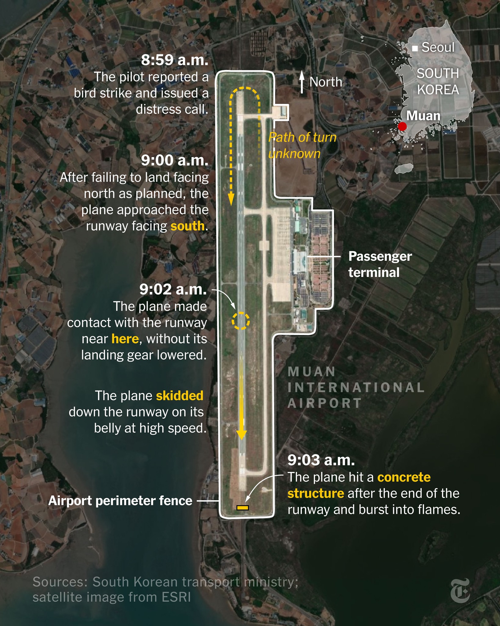

Didn't stick the landing...
What.The.Actual.Fuck.
A no gear, no flap, possibly no slat (can't tell) landing at a VERY high rate of speed to a 2800m (9100') runway with big-ass walls maybe a thousand feet off either end???
I'm not 737 typed but I can't imagine a circumstance (short of maybe a cockpit fire) where you wouldn't take the time to hold, run checklists, manually extend the gear, burn down fuel, recover as many systems as you could, and go looking for a longer runway.

This is the best synopsis I’ve seen so far on the crash. Big picture to me is that a possible bird strike followed by gross pilot error and negligence will likely be the determined cause of the event. I have a whole list of questions as it seems they ignored several critical emergency/abnormal checklists and brought the plane in for a no flap, no slat, no spoilers, no gear, landing in which they touched down more than halfway down the runway; what could possibly go wrong doing that?
This is the best synopsis I’ve seen so far on the crash. Big picture to me is that a possible bird strike followed by gross pilot error and negligence will likely be the determined cause of the event. I have a whole list of questions as it seems they ignored several critical emergency/abnormal checklists and brought the plane in for a no flap, no slat, to spoilers, no gear, landing in which they touched down more than halfway down the runway; what could possibly go wrong doing that?
As a 737-800 typed pilot.
This is most likely correct. Panic, zero crew coordination, wrong identification of the problem and rush to get down on the ground.
Also keep in mind the Korean airline culture is extremely bad, CRM non existent. The capt is God and cannot be challenged especially if he’s ex-AF or from high society and if he decides to plow this aluminum tube into the side of the hills then the first officer will closes his eyes and thinks about flowers until the impact.
Now unto this accident. Bit of system knowledge, even a full loss of hydraulics, you get flaps 15, leading edge devices , manual gear extension and alternate brakes. It’s a bitch to fly but it’s still absolutely doable.
This is clearly a crew that panicked, didn’t run any checklists, didn’t run any landing distance numbers and completely lost their situational awareness of what was the initial problem. In many ways it’s very similar to the Cargojet/Amazon PrimeAir B767 that overran YVR couple of weeks ago: minor flap issue on the approach, crew panics, doesn’t take time to run checklists, continue the approach, lands long, fast, don’t manually deploy speed brakes and then overruns by almost 1900’ which could have been fatal if they landed on the 26R or almost any other runway in any big city airport.
It’s not impossible that a bird strike can trigger an engine severe damage that compounds into a loss of hydraulics. It’s still not that big of a deal but Boeings 737NG and MAX are of an older design that requires the pilot to be a thinker and understands what happens, unlike the more modern triple hydraulics with digital checklists and crew alert systems based airliners such as the 777/787 and all Airbuses. These modern airliners are much more suited to third world and (some) Asian countries but the accountants just love the 737-800 for its lower CASM to the Airbus 320.
