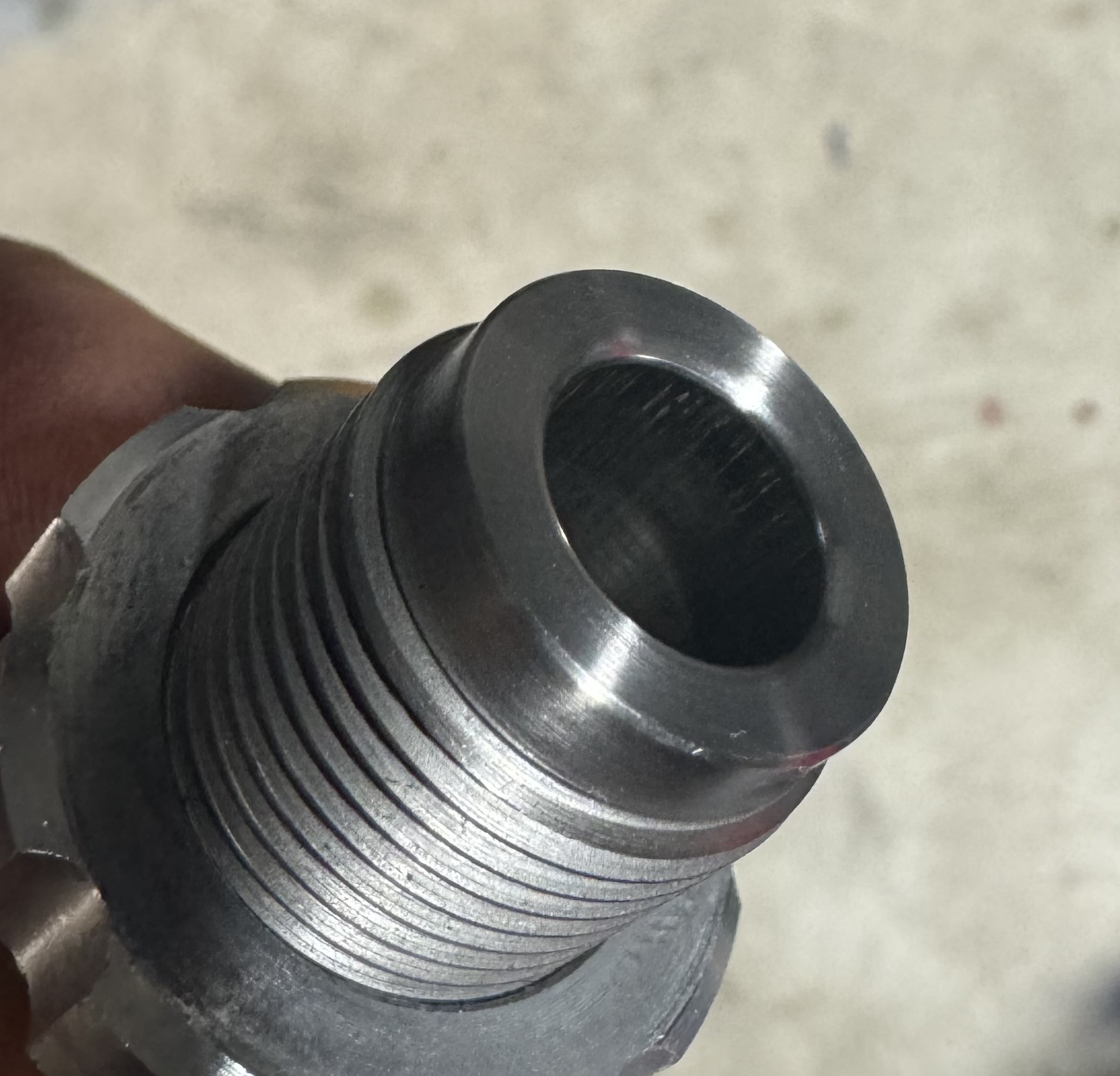

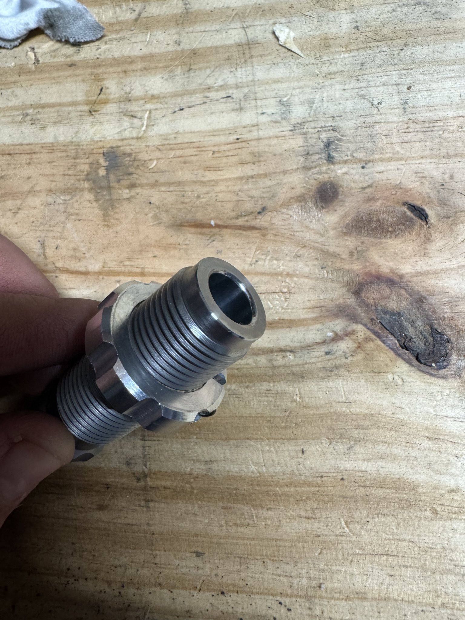

Die Scratching Brass
Lilfry
Mar 5, 2022
144
26
Texas
Looks like the inside of my die started scratching my brass when sizing. Not sure how the die got scratched inside. I clean my brass prior to sizing. I tried cleaning the inside of the die with a nylon brush but it didn’t do anything.
Whidden die for reference. Am I going to have to buy another die?
Looks like brass galling to me. A LOT of it. Probably caused by insufficient lube on the cases... tiny flakes of brass get scraped or sheared off and essentially pressure-weld themselves to the die wall. Ask me how I know. And ask me whether anything like steel dental implements will pop the flecks off the die wall... and I'll tell you nope, won't work.
If there's a solvent that will break it loose... that would be great. I never tried that approach. I used 1500-grit automotive wet-lap sandpaper spinning on a dowel. Royal pita to get the brass out. Afyer which I never underapplied lube again.
Damn, are you me in an alternate universe?
I think you guys are right. I usually put my clean brass on a loading block and use one shot. I think the one shot was not reaching far down the body of the brass. Sounds like over time it might have caused galling like you guys predicted.
I just used some flits and a shotgun bore cleaner to polish the inside. It seemed to work until I loaded like 5 pieces of brass and it came back.
That's why I asked how you lubed your cases. You can see the bottoms of the cases aren't being lubed enough and the resulting galling.
Do the flitz thing again then clean it really well, then do flitz, then clean it again, ect... polishing compound will work with the right sized bore mop and a drill

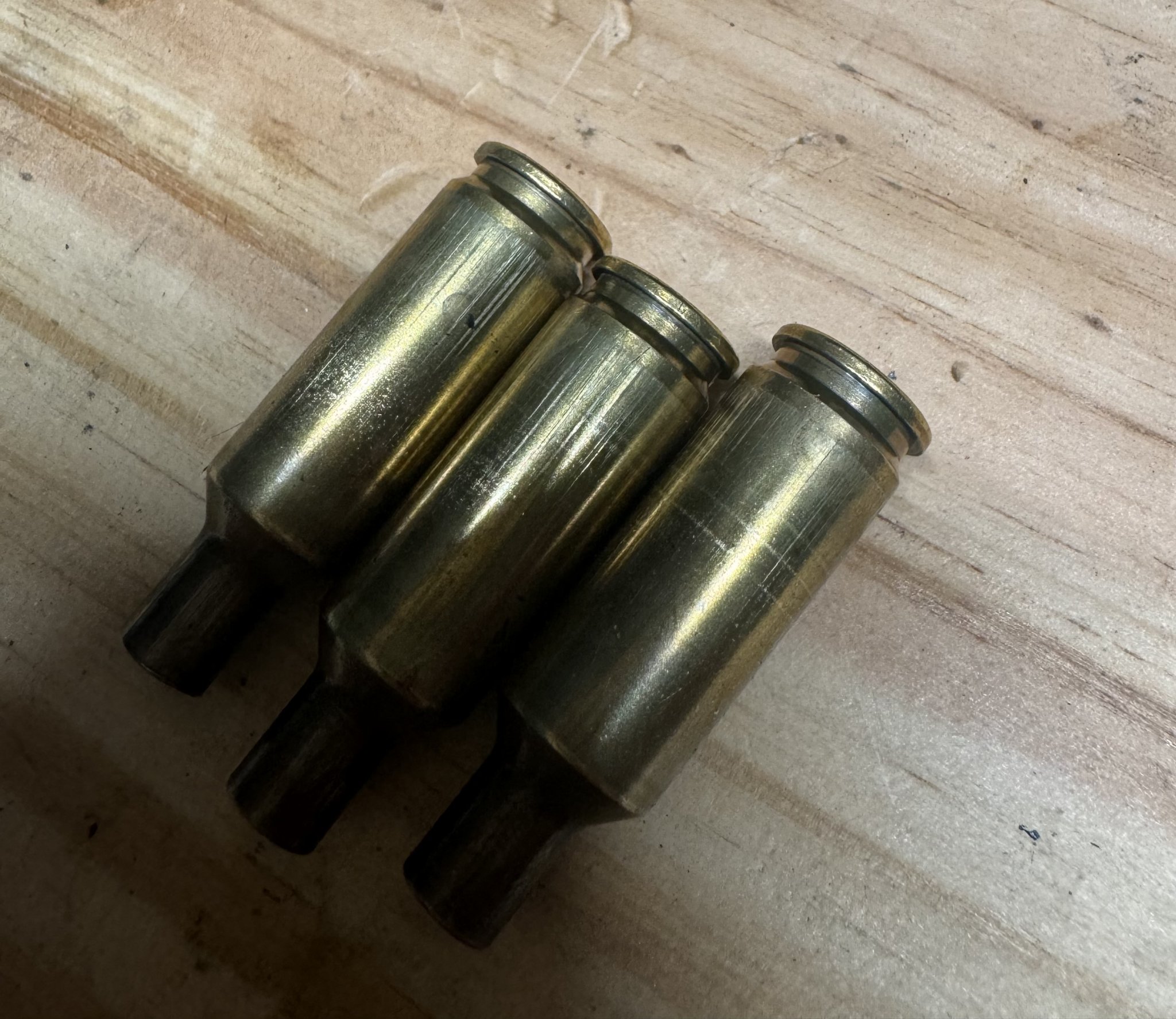

Are these pieces of brass with burrs safe to shoot or should I toss them?
Can usually either scrape out the deposits carefully with a hard steel tool (be careful not to engrave your die), or strip the die down and let it soak with something like BoreTech Eliminator. It will eventually dissolve or at least partially dissolve the brass so you can scrape it away, give it a light buff and carry on.
