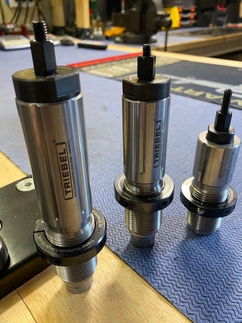

For my next (4th) barrel I’ve ordered a reamer of the same dimensions as the DT chamber and will get custom dies built from that reamer. I wish I had done that on prior builds. It will also make your custom does have more resale value because whoever buys them will be able to recreate the chamber they’re made for. For custom dies look at WTC and Triebel (Germany).

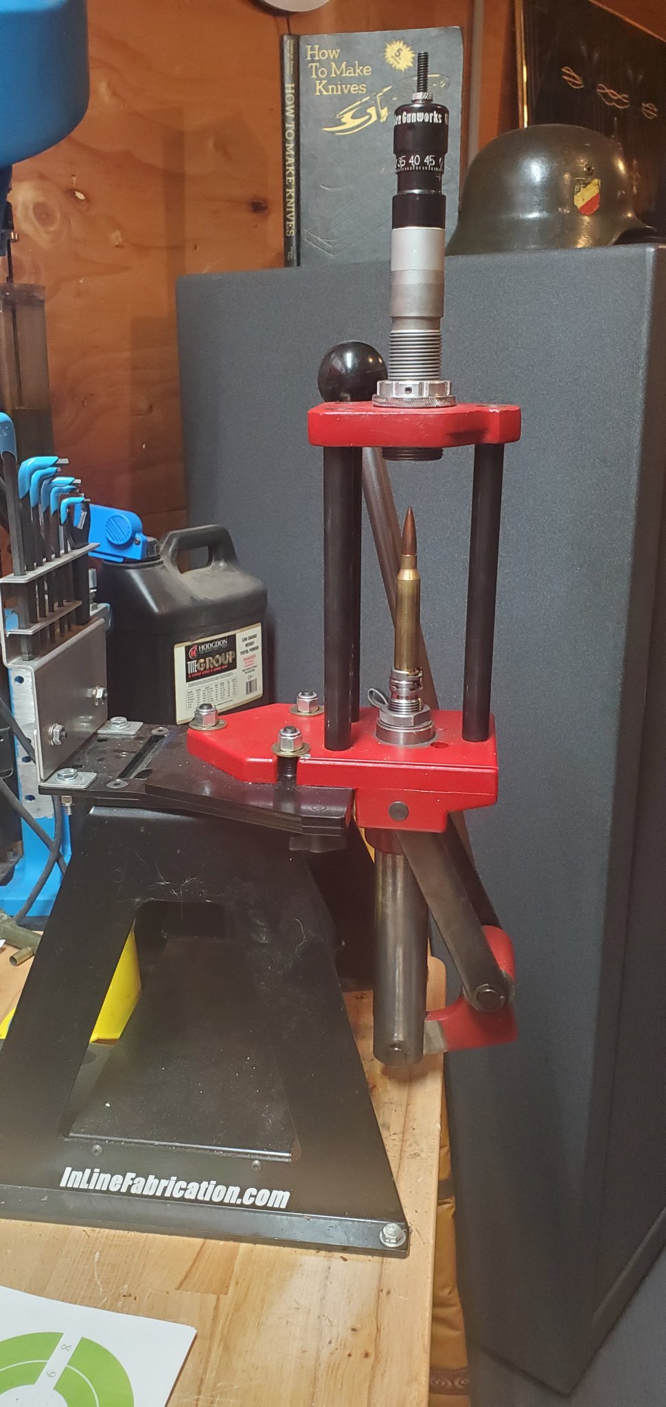

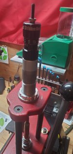

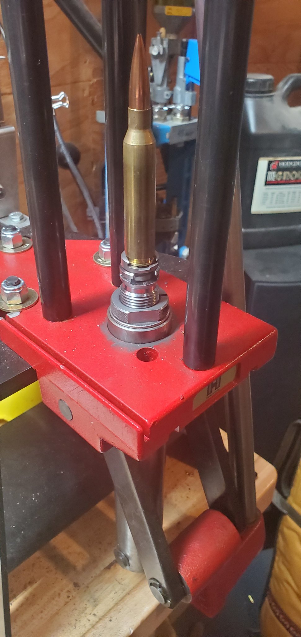

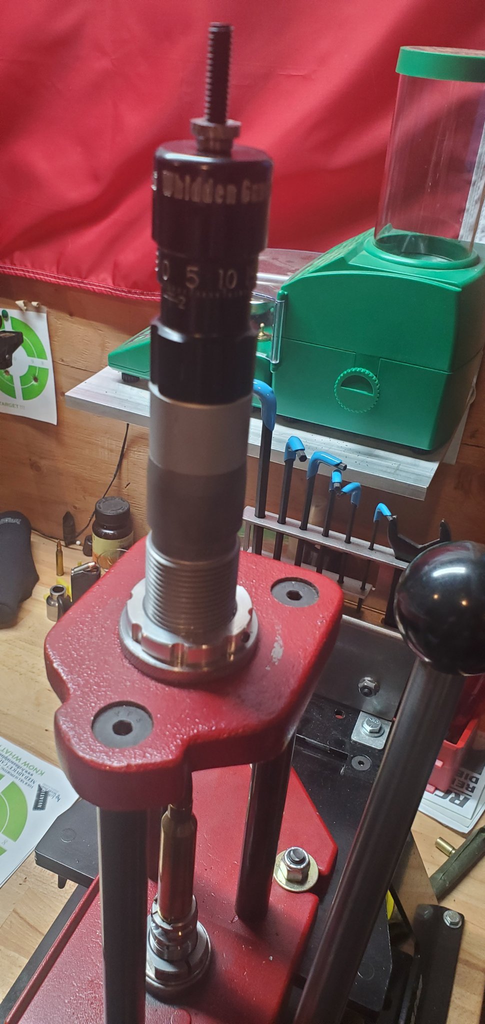

This is my setup with a Hornady 50bmg press. Pacific Tool and Gage 1.5x12 to 1.25 adapter was a pos, and I had to run a tap thru it and chase the threads(should have made my own). I went with this setup, as I have 2-650's and a Forster coax. Whidden dies are as nice as any forster product I've seen. I really like the LNL as I mainly use the press with a bulge buster to take the glock bulge out of 9mm.

As another poster said on SH a while back when I was complaining of the cost: "WTC dies are the finest piece of steel you will ever own." True statement.
Its really simple in a world where new brass is not properly formed to spect and chambes are all over the place and with that sizing dies and reamers being .003 .004 .005 under sized (003 is typical) its no wonder there is issues warner tool understands this. They understand what it takes to make your high doller build function properly. The high doller dies are worth every penny. Thanks Alan and Dan Warner for understand My and John pierce vision and being able to make what we needed and wanted to make our 416 colossus function flawlessly.
Reactions: Dan Warner
