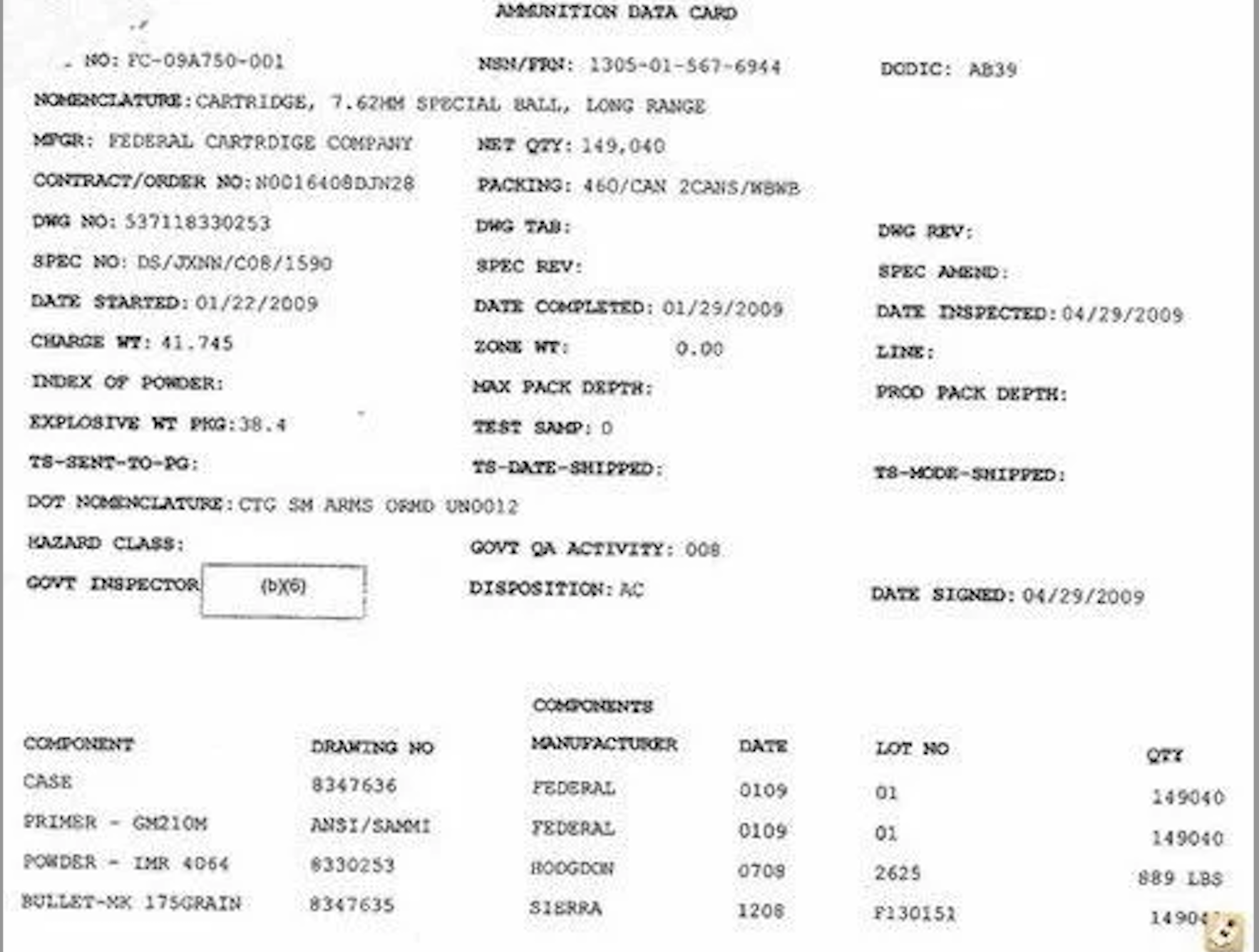

"I contacted FEDERAL with these same questions I'm seeing here. their response was. GM308M2 175gr is loaded to SAAMI specs. GM762M2 and M118LR are identical loads to military specs. They also said that usually the GM762M2 was slightly more accurate." - RICK (06/09/2017)
What is interesting is that FGMM 308 175 was found to be about 41.8 gn of IMR 4064 and M118 Mk 316 Mod 0 was listed as 41.745 gn of IMR 4064 with a Federal case and FGMM primer. This was back in the 2009-2014 time frame. Federal had a contract to produce the M118 Mk 316 Mod 0 Special Long Range after it developed the Round for NAVSEA Crane after issues showed up with M118 LR in Afganistan (the RL-15 issue).
The general consensus in that timeframe was that the rounds were the same but the case markings were required to be different. Whether the cases were actually different no one was certain at the time.

M118 Long Range is prior to M118 Mk 316 Mod 0 Special Long Range. When the FGMM box changed from the orange box to the current design the powder in FGMM changed. The new load seemed to be about 40 gn of what may have been AR-Comp.

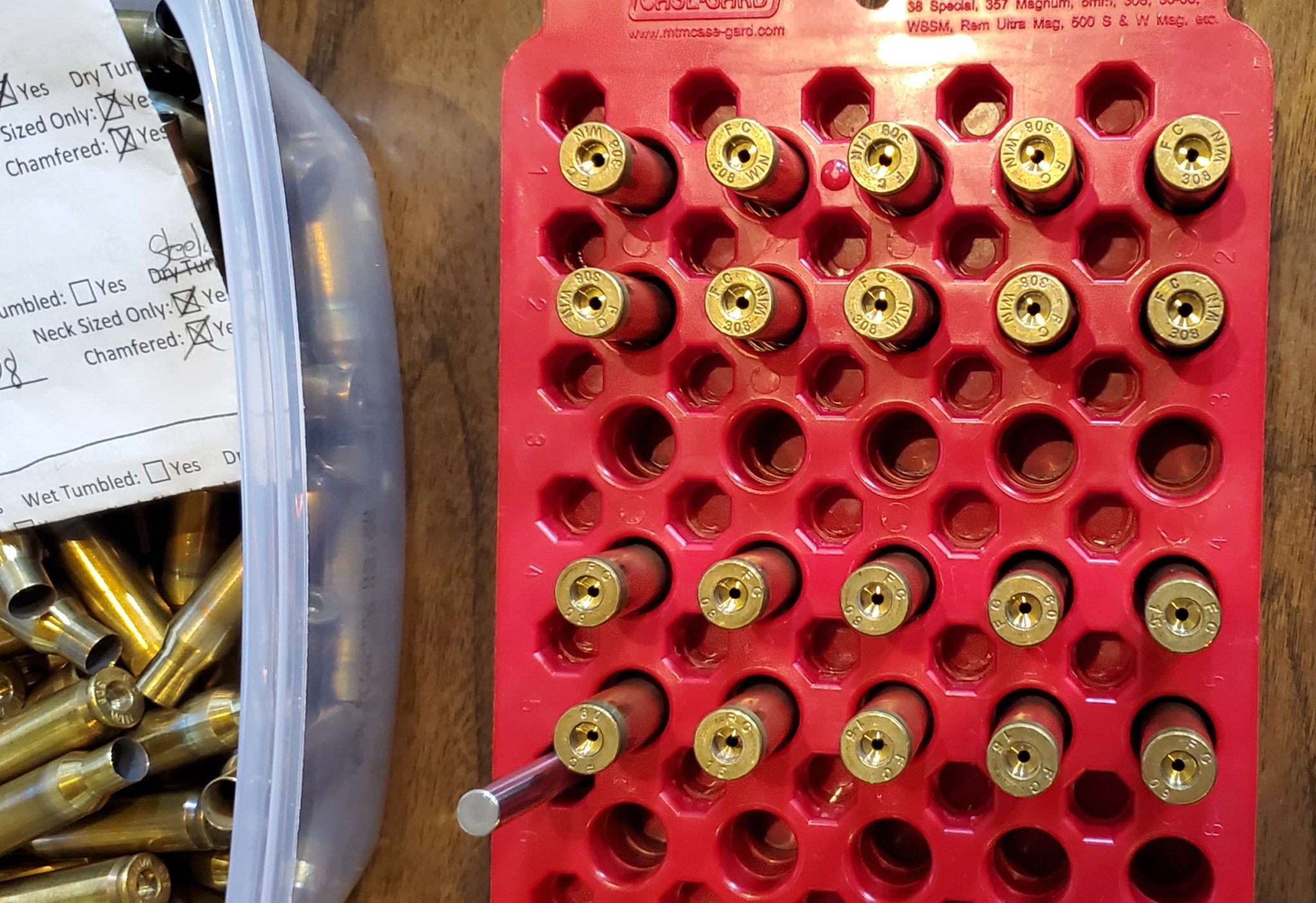

For those wondering still, this is what FGMM 7.62 looks like.
I've had this brass stored for a few years now after firing them 4 times and only just now measured their case head thickness. I found the FGMM 7.62 case heads averaged .202" in thickness and the Win. .308 cases measured .200"; not a lot of difference and well within variances one can find from one lot to another.
How do they compare to other brands? Well . . .here some case head thickness:
Lapua - .171"
Peterson - .185"
Starline - .210"
Alpha - .183"
When I weigh the cases, I can find no real discernable difference in weights. PS: all these cases have been uniformed, like. . . trimmed, primer pocket depth, neck turned, flash hole deburred.
