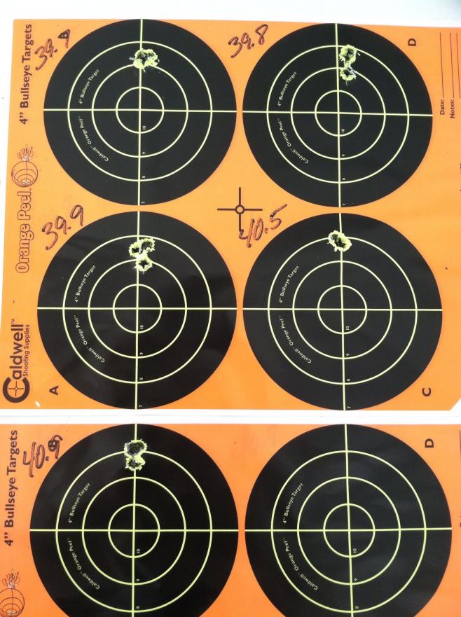

I shot this OCW test a couple of days ago with the 130g target vld's through a 6.5CM. As you can see, the accuracy potential for them is there.
