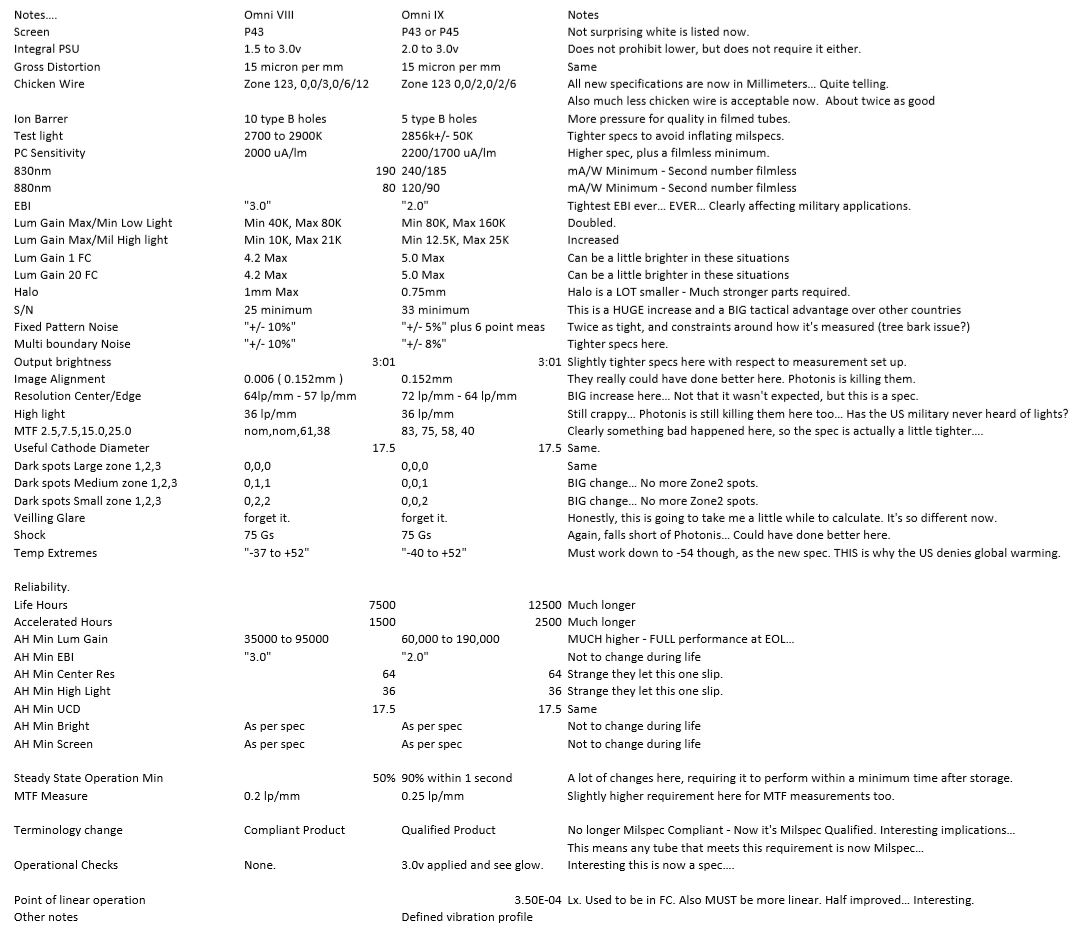

By the way guys if you check the Omni nine specifications, the military has decided that the tubes need to be a lot better in certain areas
This may explain why we’re starting to see much better tubes

Those Omni IX spec sheets floating around and are NOT final, just preliminary if someone see's those. We had meetings with L3 yesterday and the latest numbers for Omni IV are still being worked out. We are in for some treats though with some pretty good baseline numbers.

No offense taken here. Just passing along the specs that have been discussed a bit out in the open for a little bit here. If they’re expected to make big changes to them, no big deal. I’m definitely not privy to any of the behind the curtain stuff that goes down.
Either way, it’s been exciting to hear about civi-available tubes getting better and better lately. If that’s because the gov is holding people to higher standards, I’m all for it.
