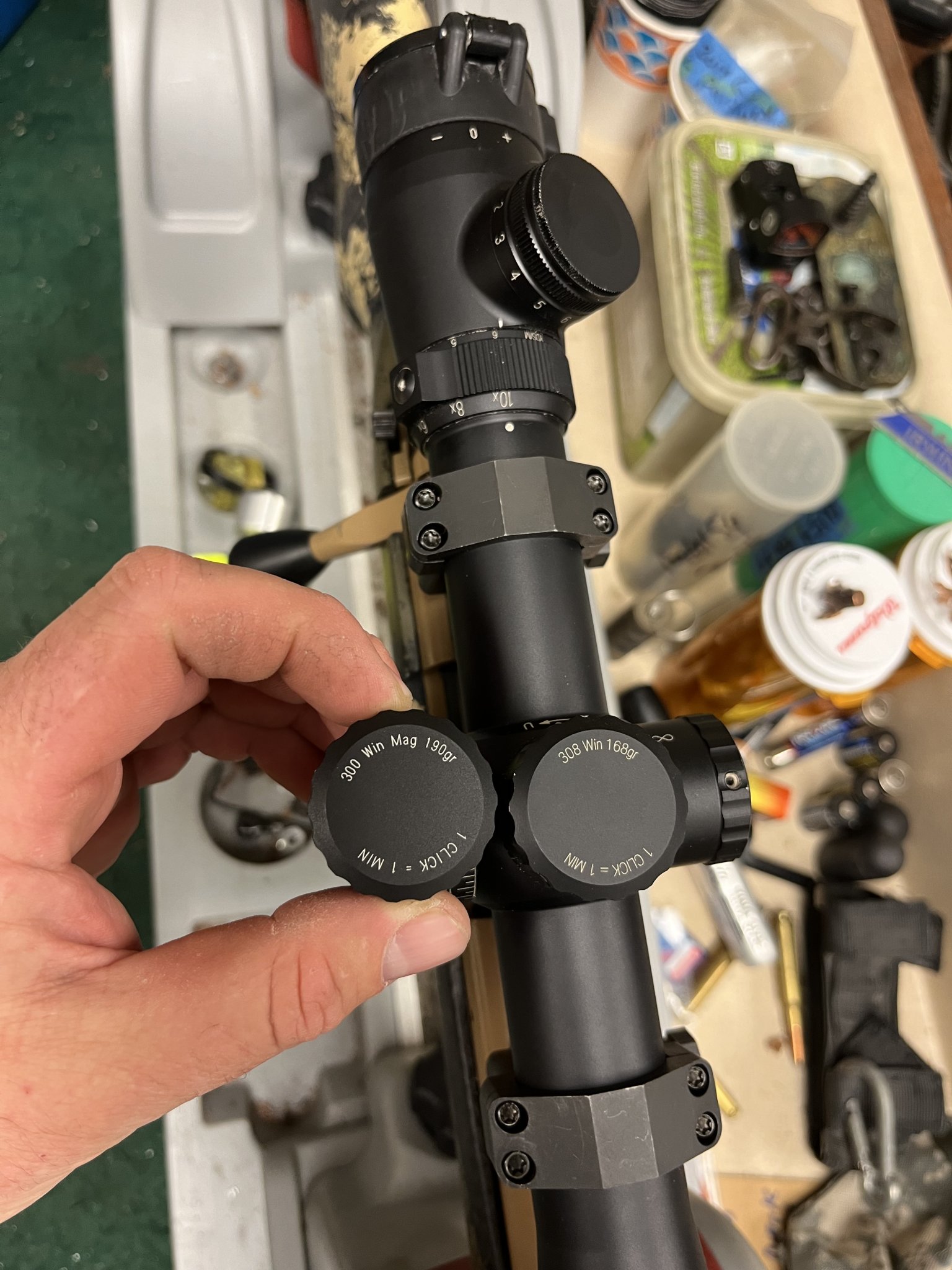

I have a Vari-X III 3.5-10x40mm Long Range M3, Matte P/N 51850 with the 3/4 Mil Dot #030123 mounted in M4 Steel rings. It has the .223 Rem. 55 gr. turret cap, a 308 Win 168 gr., the 180 gr. 30'06 Sprg. and the 190 gr. 300 Win Mag.

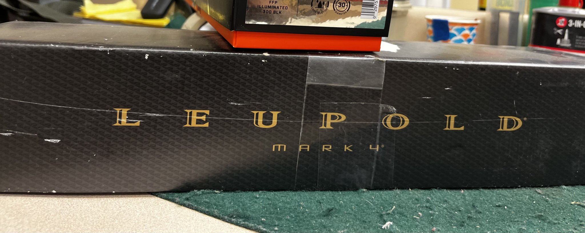

These boxes?

Why is it that I’ve seen these on here before with the cap marked “308M” like yours, vs 308 Win. 168 gr. ?
Yeah, dunno, I've seen both styles. Maybe one is for the Vari-X vs Mk4. As for selling price, the LR Tactical Vari-X seems to have a bit of a premium over the similar Mk4 M3. When I sold mine the buyer said something the M110 cloners were looking for.
The 308M turrets are graduated in meters and the 308 WIN 168gr are in yards.

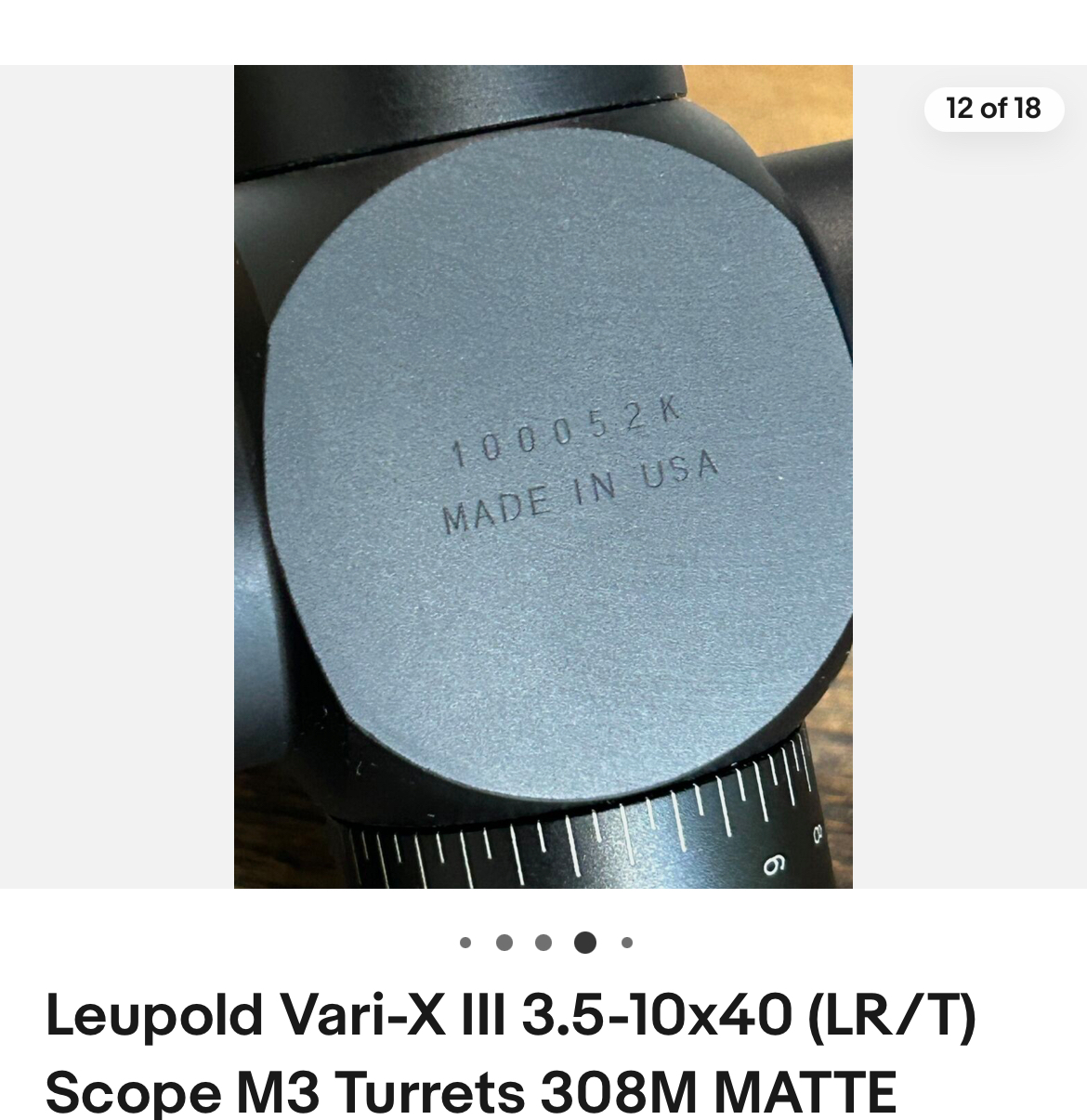

The letter suffix on the end of the serial number tells you what year it was made. This K suffix on a Vari-X indicates 2002 production for this 51850 scope:

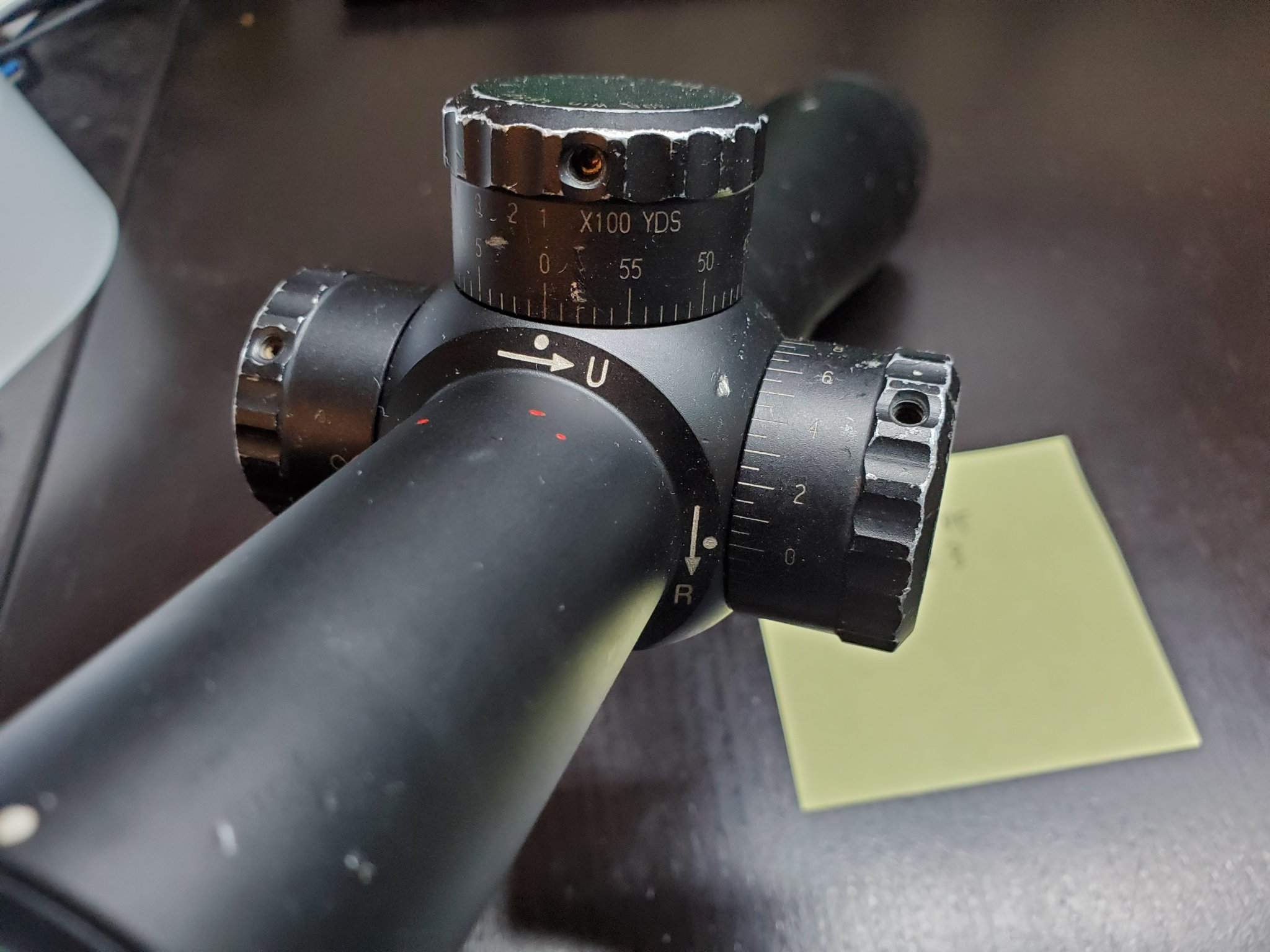

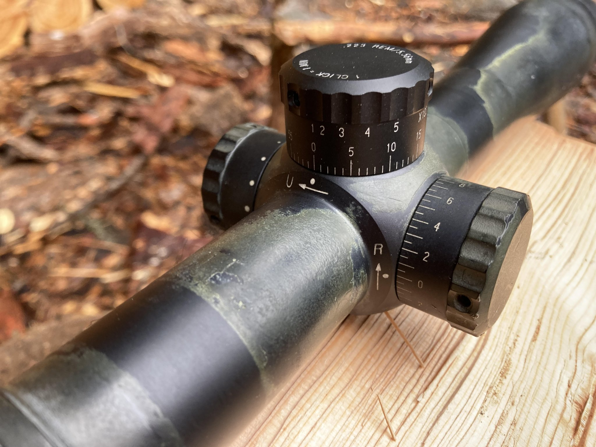

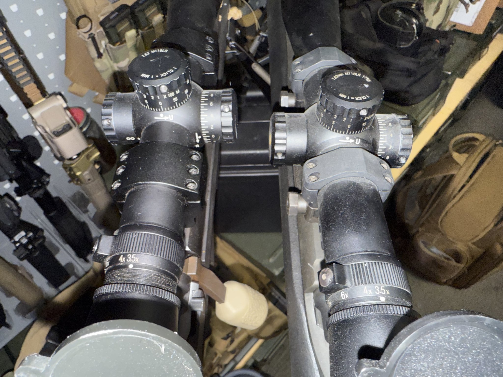

From foggy memory the M3LR originally came out as the VX-III in 1998 or 1999. Turrets were clockwise for elevation.
Once picked up in the Mark 4 line the turrets changed to counter-clockwise for elevation for a little more speed (for a right-handed shooter adjusting the turret with his left hand).
Clockwise:
Counter-clockwise:

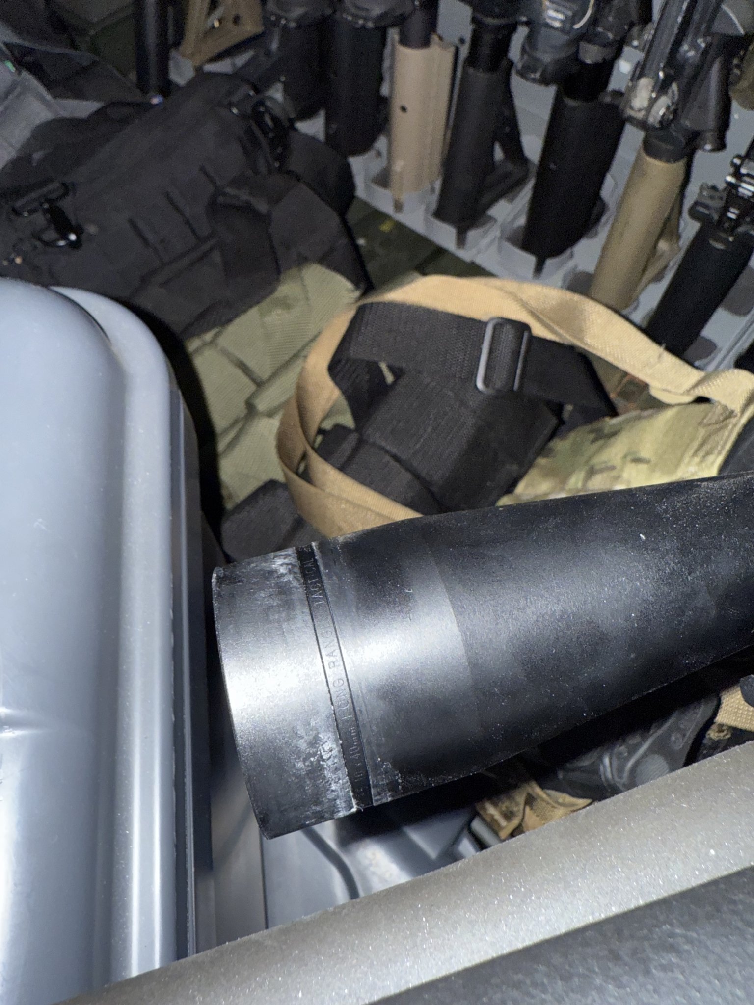

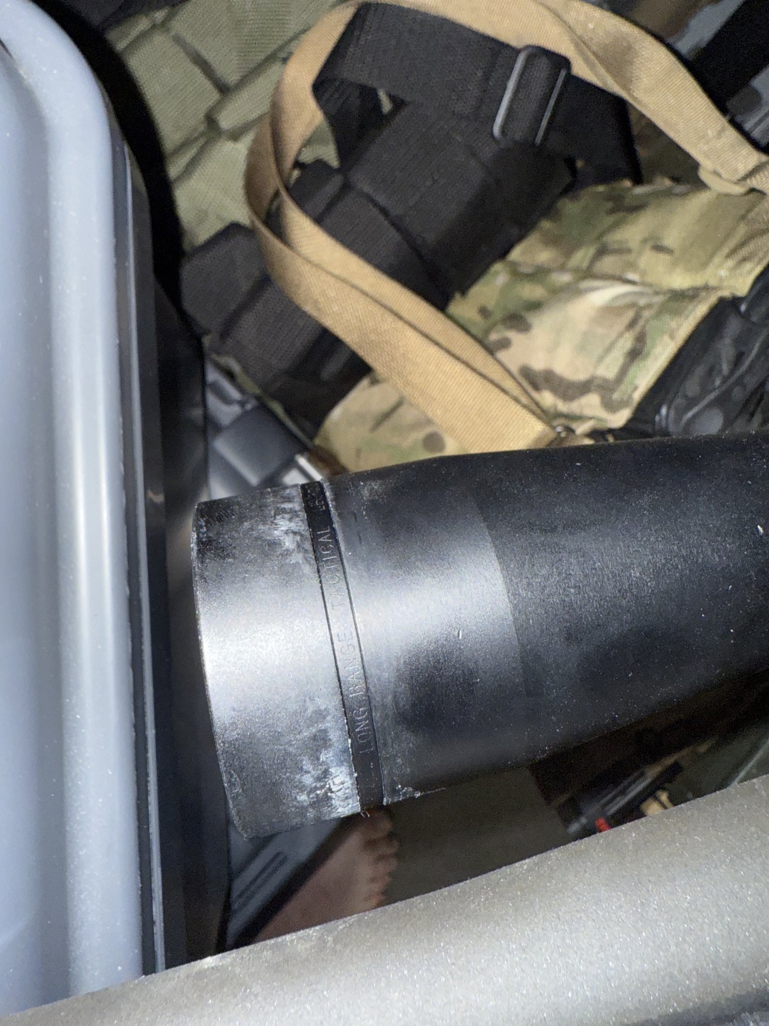

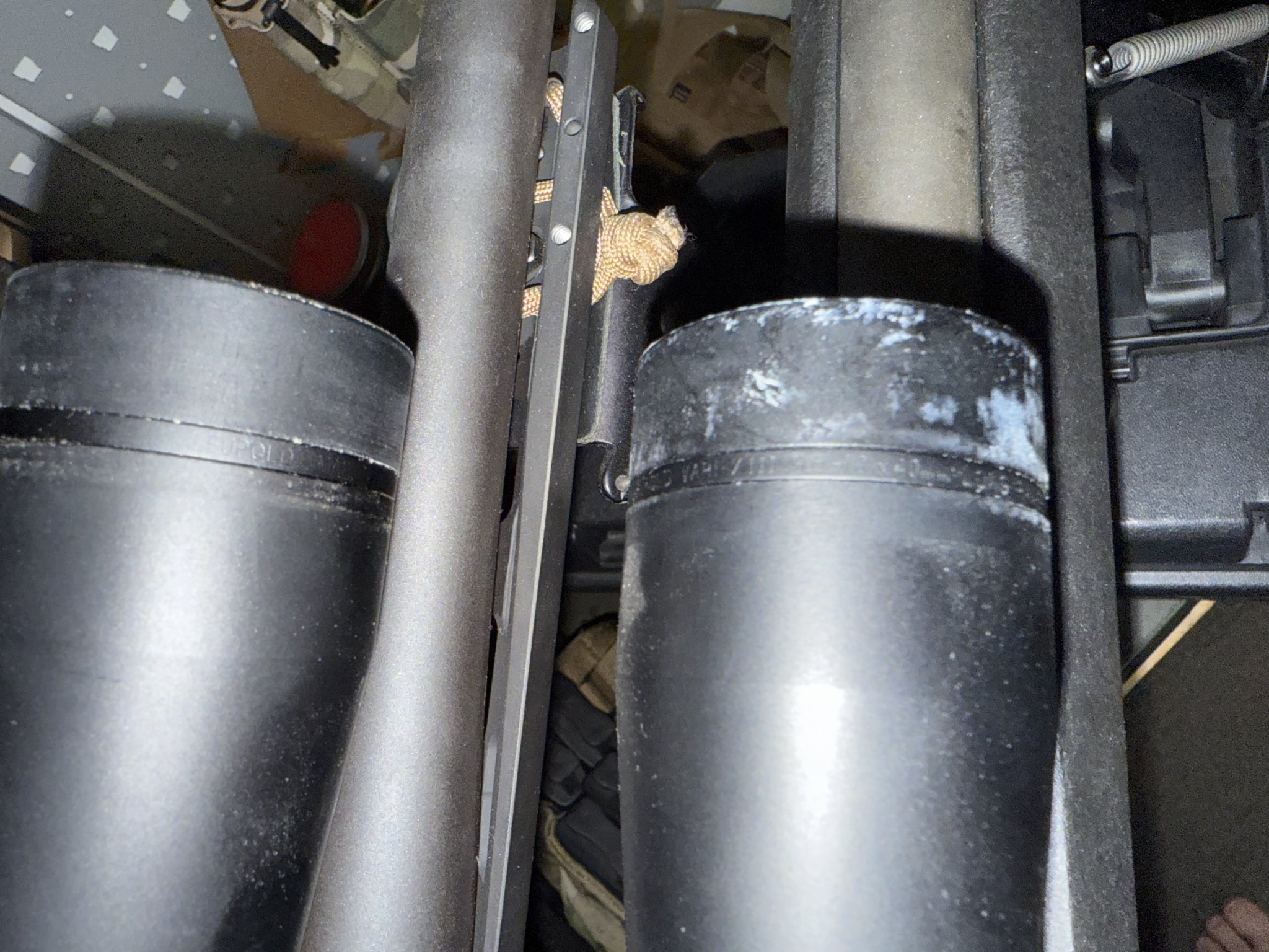

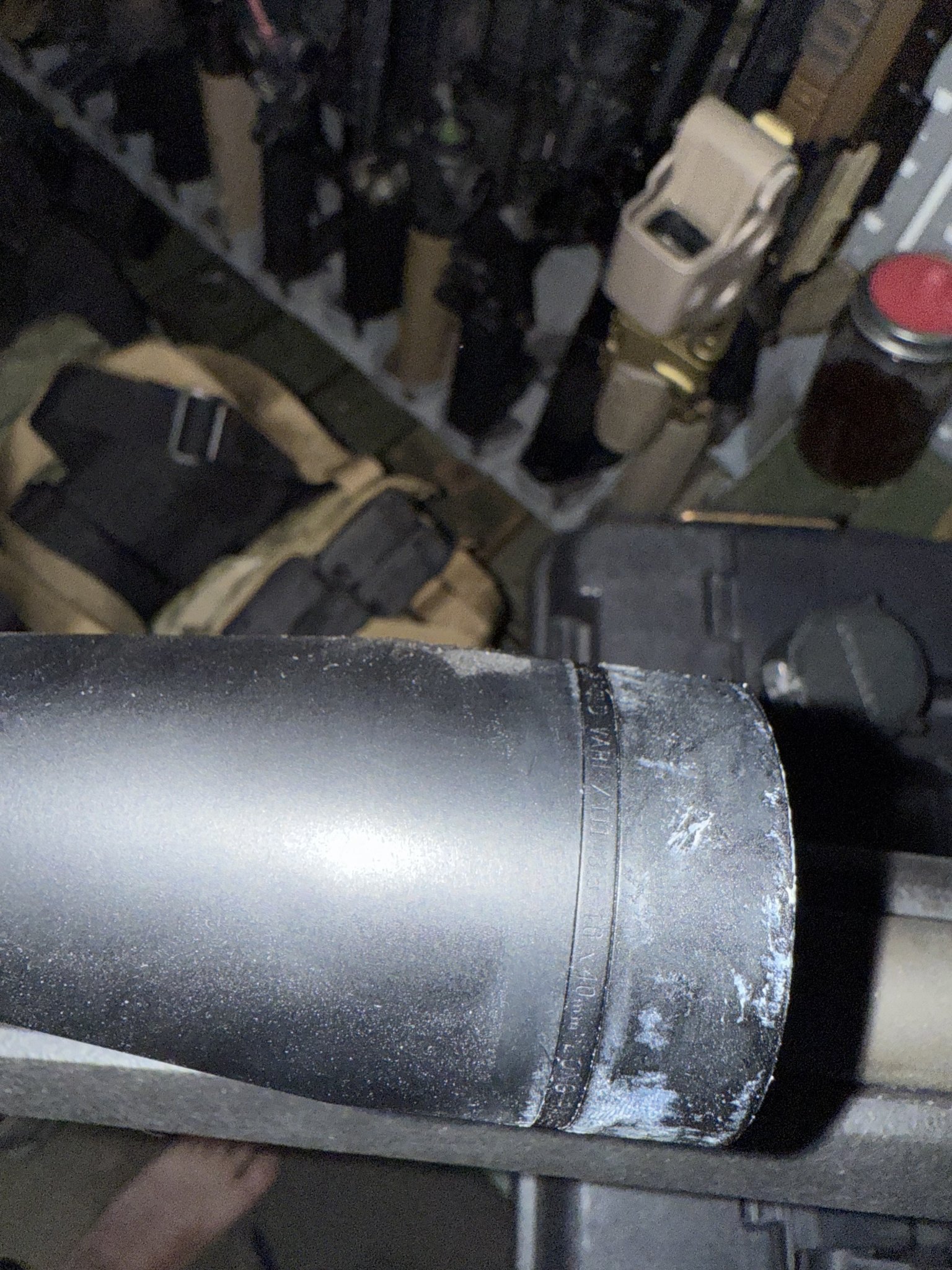

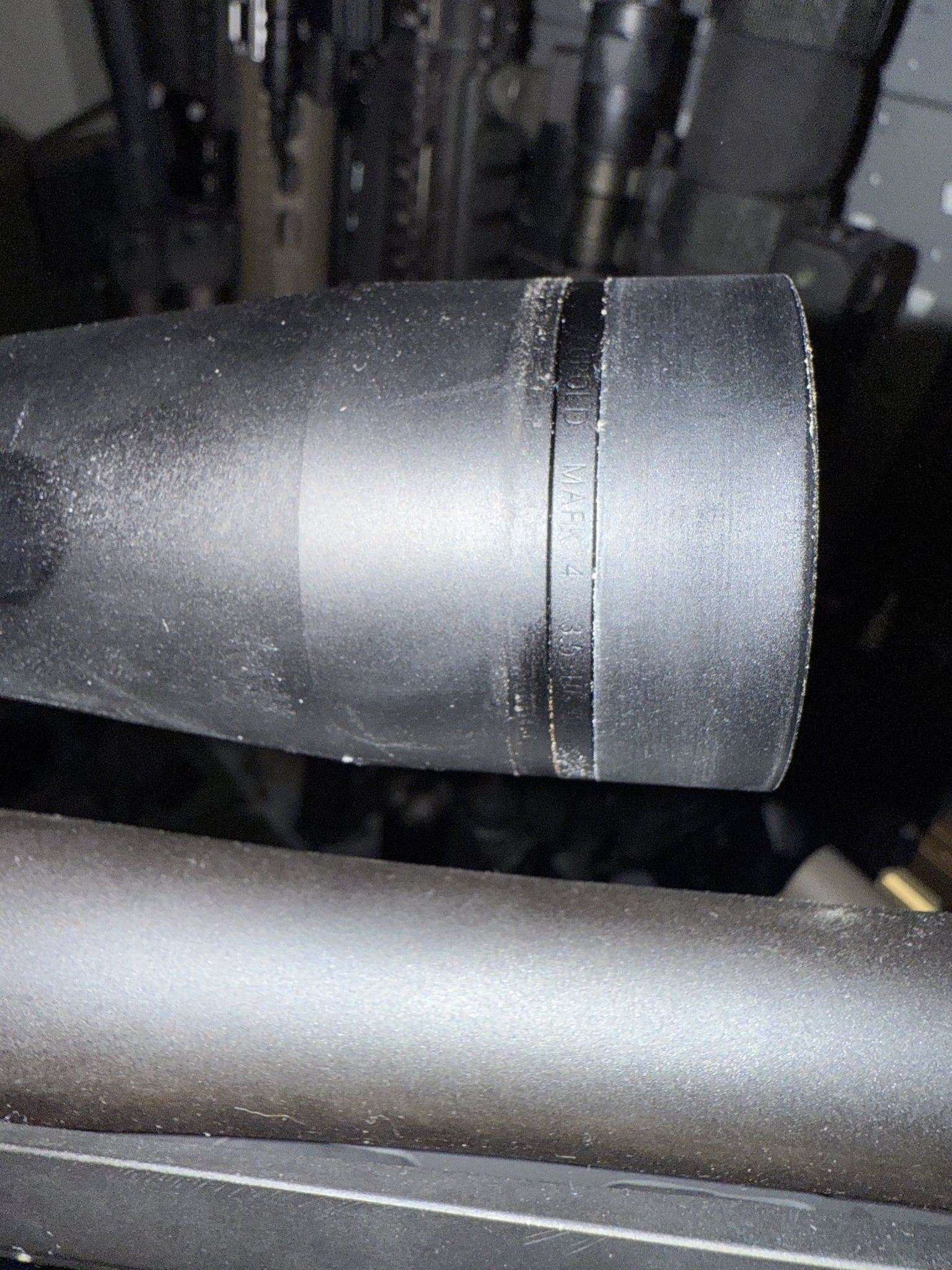

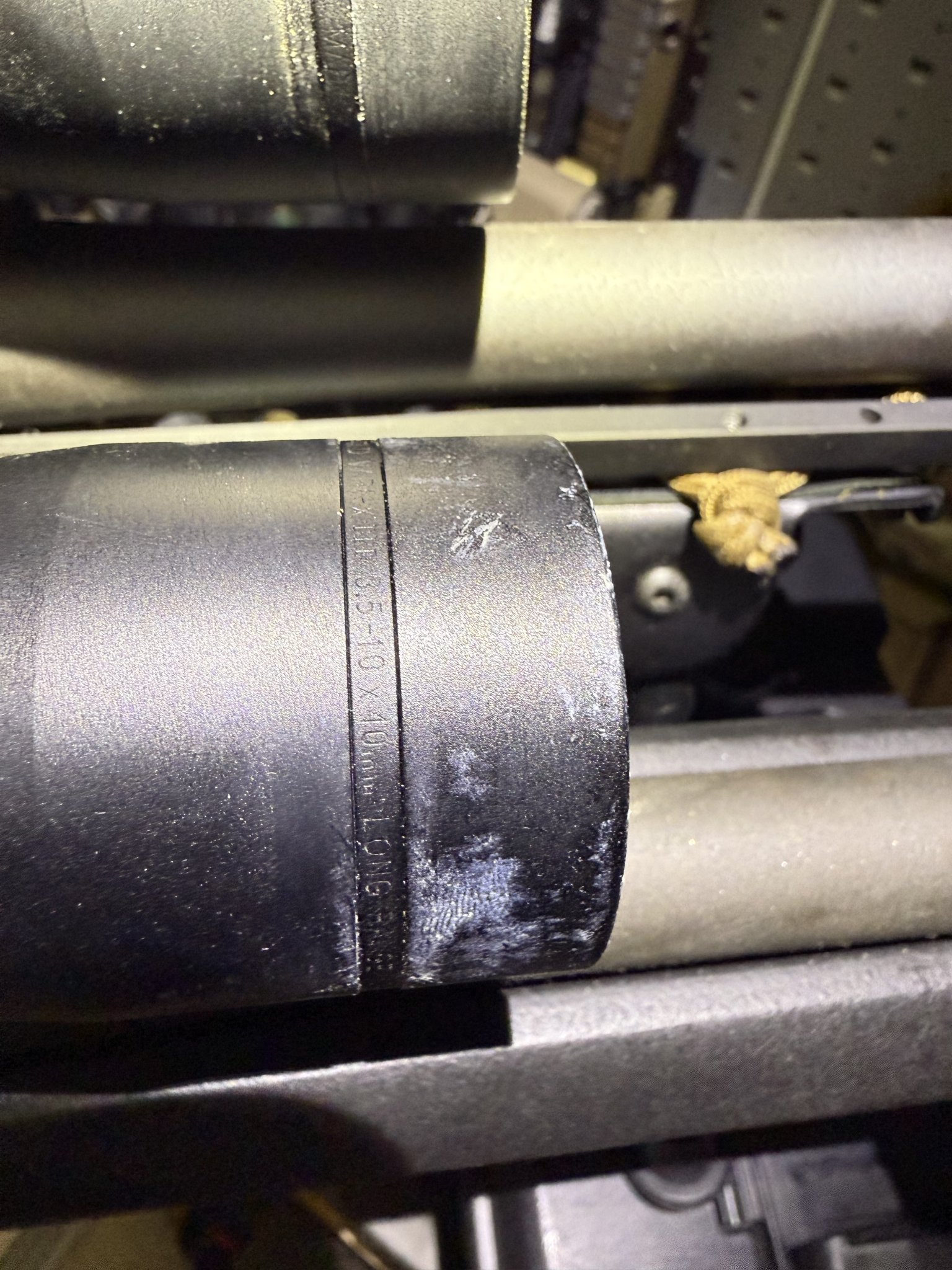

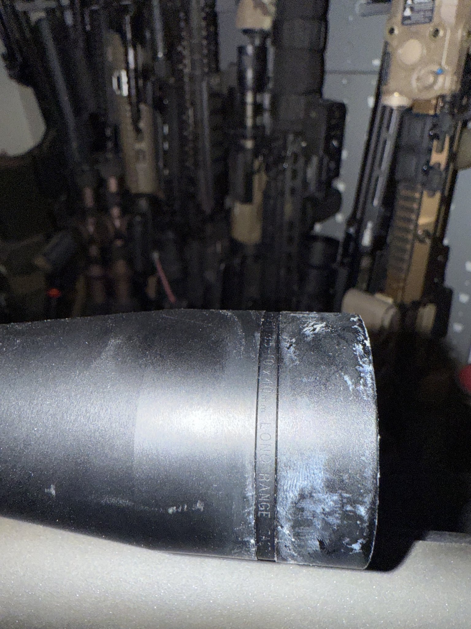

I don’t have much to add, but I do have both, other than the markings of mk4 vs Vari-x III on the ring around the front and the MK4 has a purge? Hole on the bottom, they are the same to my eyes. The Vari X I have was converted to first focal plane, I got it used but I recall it was Premier Reticle as I recall them doing the conversions until they went out of business. If cloners are looking for these I’d be excited, those guys pay a lot!
As I recall at the time, the model number didn’t even change it was the 51850 for both. I’m not digging the boxes out of my attic without a good reason though!

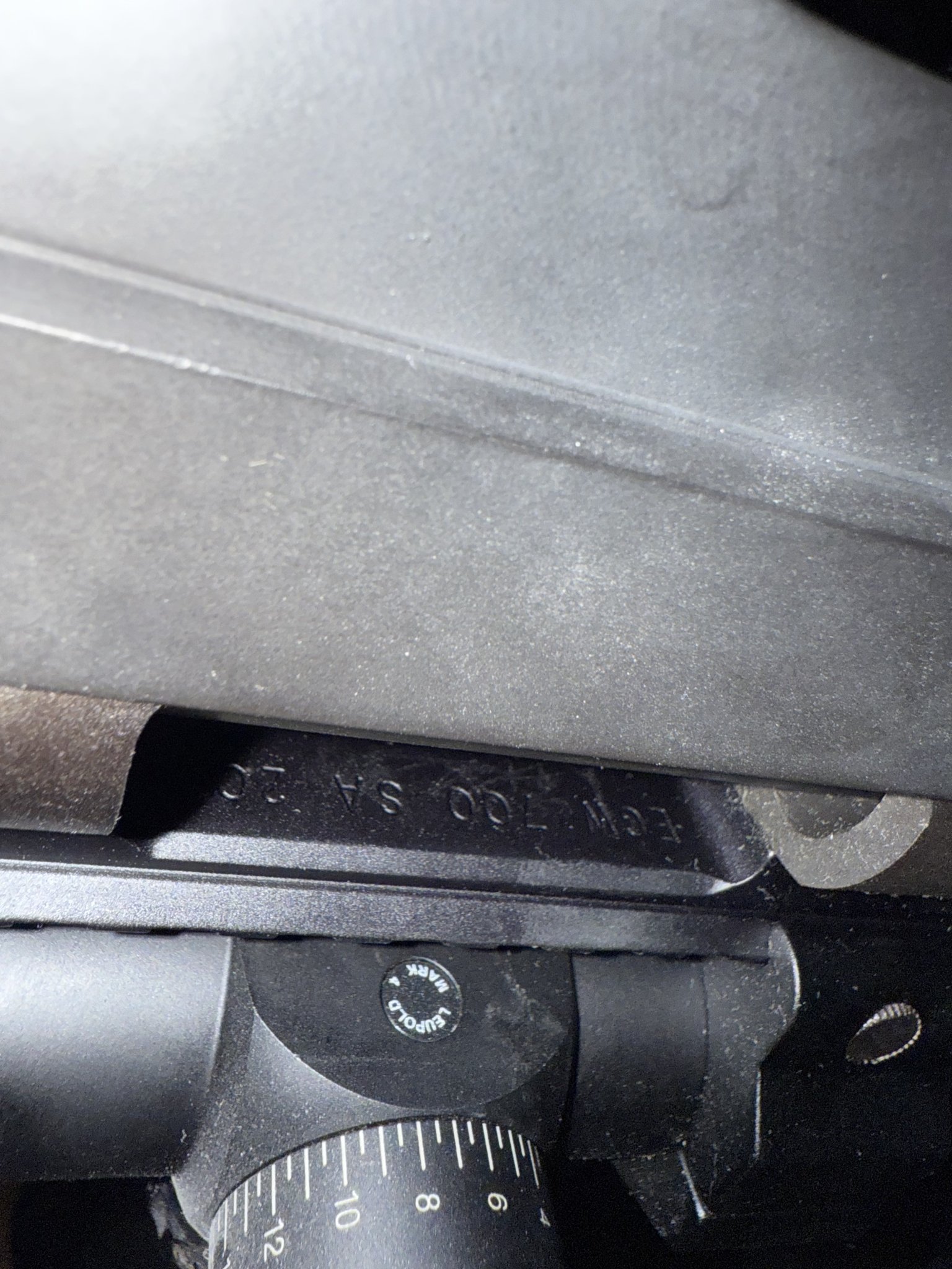

I suck at pictures, but tried my best.
I dug up the write up I remember reading like 18 years ago when I got the Vari-X III

Very cool to see those photo(s) from you guys!! I wondered why the Mark 4's had the rubberized emblem and the older ones marked Tactical, so that makes sense for purging them.

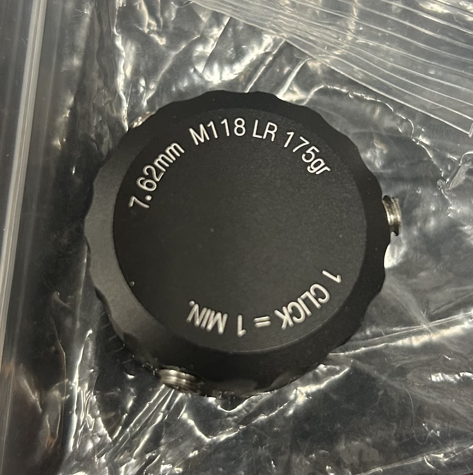

Did Leupold Make the caps marked 7.62 M118 LR 175 for you?

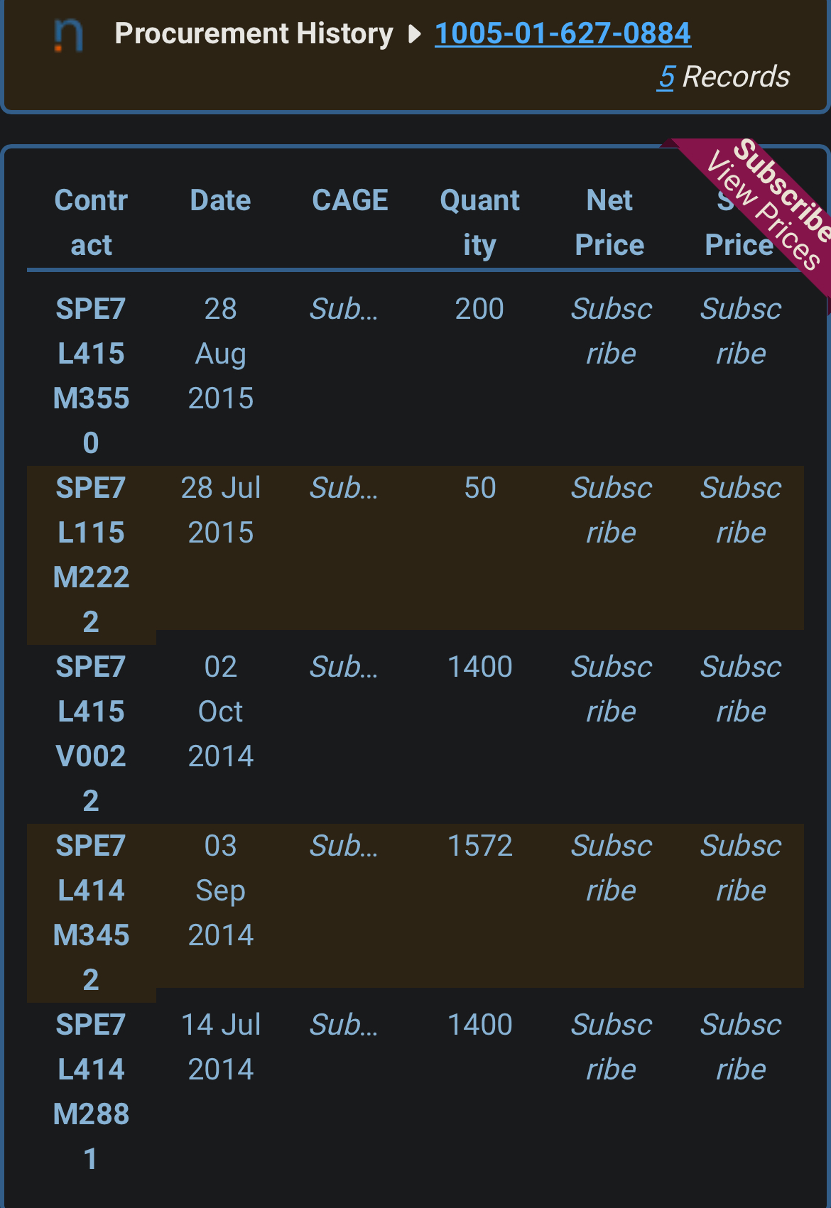

Not for me, but for the US Army. That NSN shows that in 2014-15 the military ordered 4500 of those M118 LR BDC caps. Maybe for M110s or for all the M14 EBR-RIs that were sold off via FMS program to various foreign militaries.
